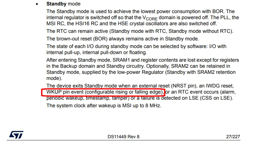

I am using the STM32L433RCT6 with a WKUP pin (GPIO PC13) to wake the MCU from shutdown mode.
Does it matter which edge I used (rising or falling) ?
See the Datasheet; eg,

Thanks Andrew, I did see that the edge is configurable.
I was just wondering if there is an advantage to using one edge compared to another, such as power consumption etc
