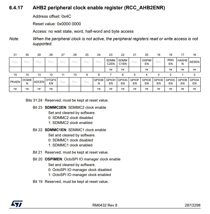

Can you see any other registers, are they all zero?
Make sure all clocks are enabled
  1. //enable peripherals
  2. RCC->AHB3ENR |= RCC_AHB3ENR_OSPI1EN;
  3. RCC->AHB2ENR |= RCC_AHB2ENR_OSPIMEN;
On H7 there's also IOMNGREN (AHB3) OCTOSPI*M*

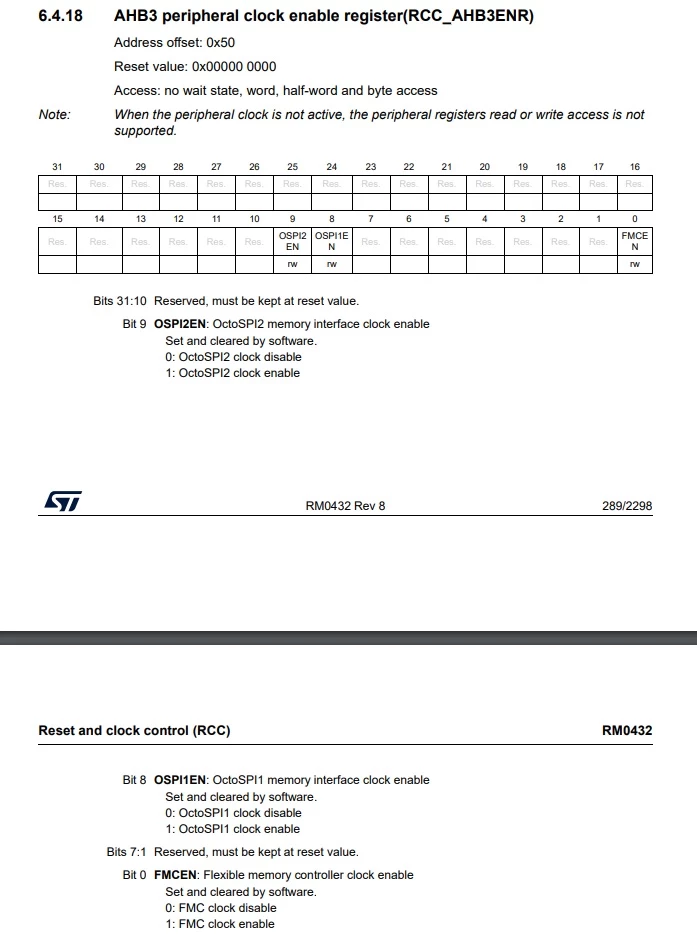

AGEBE.1
AGEBE.1Author
Jun 23, 2021 1:43 PM UTC
0693W00000BbnorQAB.pngBut where did you find this information?
I can't find the bit associated to OSPI. According to stm32l4r5xx.h file, this bit is supposed to be the 8th of this register:
#define RCC_AHB3ENR_OSPI1EN_Pos             (8U)
Tesla DeLorean
Tesla DeLoreanBest answer
Guru
Jun 23, 2021 4:32 PM UTC
I understand the problem space, an elephant with a tesseract if you will..
https://www.st.com/resource/en/reference_manual/dm00310109-stm32l4-series-advanced-armbased-32bit-mcus-stmicroelectronics.pdf
