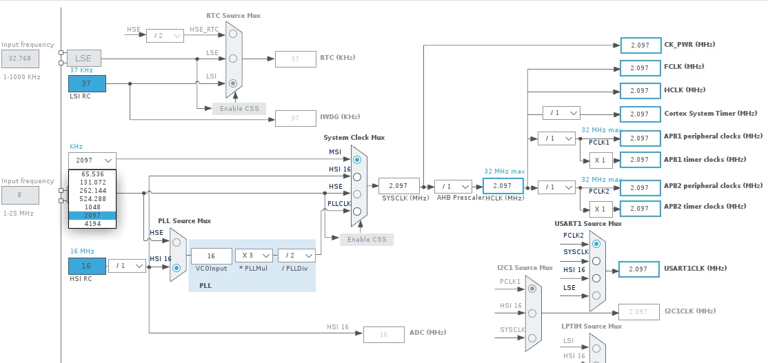

fast check: SYSCLKFreq_VALUE=2097000 ; so core running at 2 MHz ....what you expect from 2 MHz cpu ?
select PLLCLK clock as master:

L0 should run 24 or 32 MHz
2.097 MHz is MSI clock it initially starts with.​

But I'm completely inexperienced what to do for getting a faster systemclock. Maybe I'll find a hint in the MCU manual. Or what would you suggest to make it running faster?​

Manipulating the clock frequency can be done in the clock configuration panel of the STM32CubeIDE IOC editor if you change the settings of the internal PLL’s, then the processor will run at other speeds. The availability of this tool depends on how your project was set-up. The alternative is to change the code in SystemClock_config() function or similar. Anyway if you are really serious about STM32 reading a few good books can provide the necessary background (e.g. Donald Norris, Programming with STM32, getting started with the Nucleo Board and C++)

The IOC-editor is availlable in my toolchain (STM32CubeIDE 1.9). But I need to find out, which screw to turn on. I can set MSI RC to maximal 4194 kHz, which is twice as much as now, but far away from 24 or 32 Mhz as @Community member​ wrote.0693W00000UnHvCQAV.png
