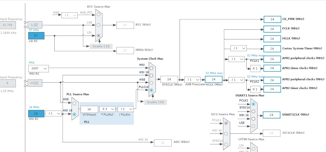

RockfordC64
October 4, 2022
Can I switch to HSI RC and PLLCLK (without destroying anything)?0693W00000UnI6ZQAV.pngSo I would reach 24MHz.
Is this all I have to do?
AScha.3
October 4, 2022
right ! (as i showed in my post before ...)
RockfordC64
October 4, 2022
Ok, thats easy.
(What are the advantages /disadvantages of MSI and HSI RC?)
I'll fetch the fire extinguisher and than give it a try.
Thank you.
RockfordC64
October 4, 2022
The IRQ-variant works now on 24Mhz. I'm very happy and gratefull for your hints.and help.
Lets see, if I will get also DMA to work...
Thank you all.
