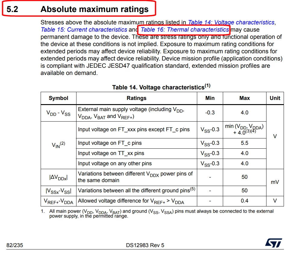

As you can see in the first paragraph of the chapter 5.2 of the DS12288:
Stresses above the absolute maximum ratings listed in Table 14: Voltage characteristics, Table 15: Current characteristics and Table 16: Thermal characteristics may cause permanent damage to the device. These are stress ratings only and functional operation of the device at these conditions is not implied. Exposure to maximum rating conditions for extended periods may affect device reliability. Device mission profile (application conditions) is compliant with JEDEC JESD47 qualification standard, extended mission profiles are available on demand.
So, for operation conditions , you should refer to table 17 value.

Taking this one at random, Table 16 comes under Absolute Maximum ratings:

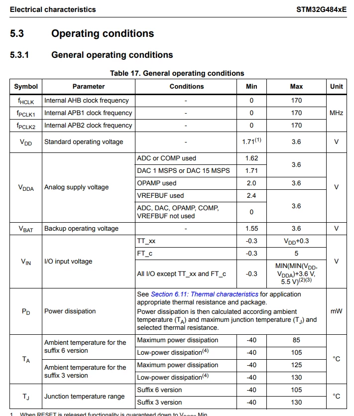

while Table 17 is under Operating Conditions:
So, yes - they are referring to different things

So, indeed:
  • Table 16 is Absolute Maximum ratings;
  • Table 17 is Operating Conditions.
It is to be expected that Absolute Maximum ratings will be higher than the Operating limits; you will see the same if you compare other Operating Conditions tables to Table 16.
