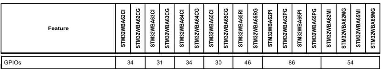

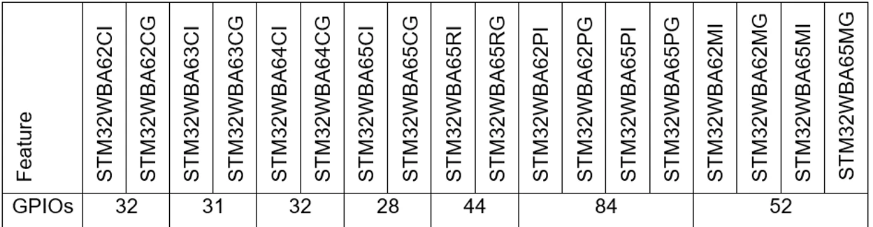

STM32WBA6xxx
DS14736 Rev 3
(Jul 2025)
Table 2. Device features and peripheral counts
Current:
Expected:
Jun 2026
