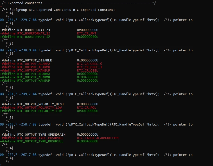

    Jun 2, 2024 10:49 PM UTC
    Hi, I have solved this, replacing the following files by old version of the hal API from other project:
    Drivers/STM32F4xx_HAL_Driver/Inc/stm32f4xx_hal_rtc.h
    Drivers/STM32F4xx_HAL_Driver/Inc/stm32f4xx_hal_rtc_ex.h
    Drivers/STM32F4xx_HAL_Driver/Src/stm32f4xx_hal_rtc.c
    Drivers/STM32F4xx_HAL_Driver/Src/stm32f4xx_hal_rtc_ex.c
    I only replacing, but we can see in git diff the differences
    waclawek.jan
    Jun 3, 2024 7:46 AM UTC
    If you look at the definitions of the symbols you've replacing, you'd see the same values. Thus, this is not the reason of the "fix" which is quite likely concidental.
    I believe most of the problems in this thread are caused by uninitialized local structs used to set up the RTC or the time there.
    Visitor II
    Jun 5, 2024 3:48 AM UTC
    It wasn't just what's in the diff that changed, but all .c code, and for me it resolved.
