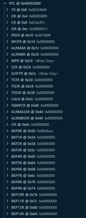

    OMira.1
    Visitor II
    October 6, 2020
    Hi Albert,
    I'm facing the same problem with an STM32l476 MCU.
    We've managed to break the execution of the software without resetting the board and got the RTC register.
    Below, the values. Did you solve this problem or find any0693W000004IoOFQA0.png workaround?
    Regards,
    Oliver
    OMira.1
    Visitor II
    October 6, 2020
    Hi.
    In my case, the CR register was corrupted. I will investigate why this happen and post here if relevant.
    Regards,
    Oliver
    SZieg.11
    Visitor II
    December 8, 2020
    Had the same problem and it turned out that the structure sTime that I called like this:
    HAL_RTC_SetTime(&hrtc, &sTime, RTC_FORMAT_BIN);
    had non-initialised members "StoreOperation" and "DayLightSaving" that corrupted the RTC CR in HAL_RTC_SetTime():
      /* Configure the RTC_CR register */
      hrtc->Instance->CR |= (uint32_t)(sTime->DayLightSaving | sTime->StoreOperation);
    waclawek.jan

    SZieg.11
    Visitor II
    December 8, 2020
    Well I first called HAL_RTC_GetTime(&hrtc, &sTime, RTC_FORMAT_BIN) and falsely assumed that it will initialise the sTime structure completely which is not the case. My bad.
    If "adult programming" means not taking advantage of existing libraries and always starting from scratch every time, I keep going with the childish way ;)
