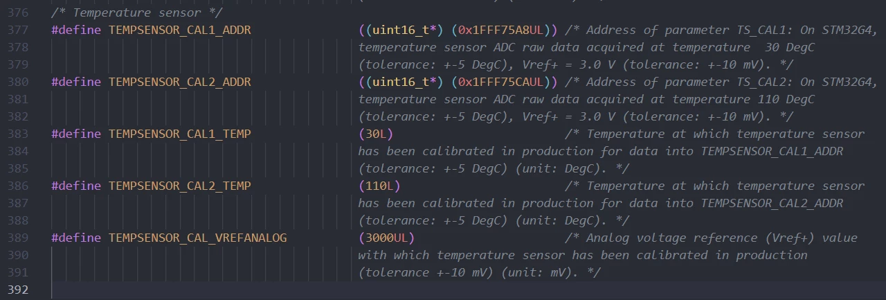

I want to use Macro "__LL_ADC_CALC_TEMPERATURE" to calculate the chip's temperature. But there is a difference here.

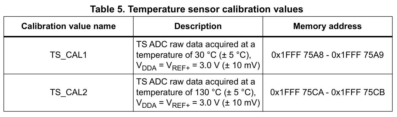

As mentioned above, in datasheet, TS_CAL2 corresponds to 130 ℃.
But in STM32Cube FW_G4 V1.6.1, file "stm32g4xx_ll_adc.h", line 386, TEMPSENSOR_CAL2_TEMP corresponds to 110 ℃.
Which one is ture?

It is 130 and is correct in the GitHub version, but a library release has not yet been made which includes this fix.
stm32g4xx-hal-driver/Inc/stm32g4xx_ll_adc.h at 1a4f1ca138a19dfe42becc50975f11a1e7554e31 · STMicroelectronics/stm32g4xx-hal-driver
Solved: Re: STM32G431 TS_CAL2 temperature - STMicroelectronics Community
This issue was fixed a few years ago, then broken, and now fixed but not yet released.
