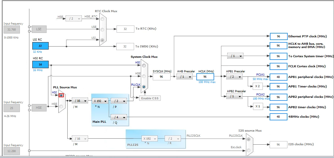

Clock setting:0690X000006063uQAA.png
void SystemClock_Config(void)
RCC_OscInitTypeDef RCC_OscInitStruct;
 RCC_ClkInitTypeDef RCC_ClkInitStruct;
__HAL_RCC_PWR_CLK_ENABLE();
__HAL_PWR_VOLTAGESCALING_CONFIG(PWR_REGULATOR_VOLTAGE_SCALE1);
RCC_OscInitStruct.OscillatorType = RCC_OSCILLATORTYPE_HSI;
 RCC_OscInitStruct.HSICalibrationValue = 16;
 RCC_OscInitStruct.PLL.PLLSource = RCC_PLLSOURCE_HSI;
 RCC_OscInitStruct.PLL.PLLM = 16;
 RCC_OscInitStruct.PLL.PLLN = 192;
 RCC_OscInitStruct.PLL.PLLP = RCC_PLLP_DIV2;
 RCC_OscInitStruct.PLL.PLLQ = 4;
 Error_Handler();
 RCC_ClkInitStruct.APB1CLKDivider = RCC_HCLK_DIV2;
 RCC_ClkInitStruct.APB2CLKDivider = RCC_HCLK_DIV1;
 if (HAL_RCC_ClockConfig(&RCC_ClkInitStruct, FLASH_LATENCY_3) != HAL_OK)
 Error_Handler();
HAL_SYSTICK_Config(HAL_RCC_GetHCLKFreq()/1000);
HAL_SYSTICK_CLKSourceConfig(SYSTICK_CLKSOURCE_HCLK);

Tesla DeLorean
Guru
January 17, 2017
Posted on January 17, 2017 at 17:49
Can you help check the clock setting?
Clock settings look to be OK.

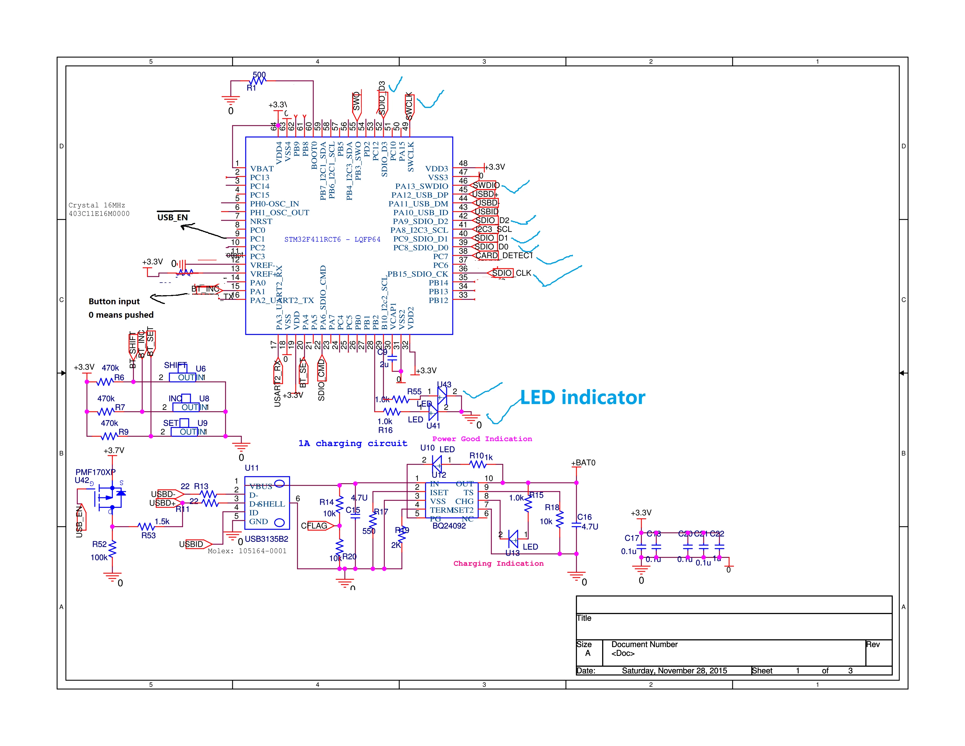

Are you sure it is not something with the pins of the 411 vs 405? Did any of the power, VCAP, or strapping get changed. Review a F411 DISCO schematic vs the F407 one.
rwmao
rwmaoAuthor
Senior
January 24, 2017
Posted on January 24, 2017 at 02:13
Clive,
PC7 is used for detection.
Or maybe you can just leave it always enabled
I have two LED,
PB1 is for green
, PB2 is for red. Turn on green if everything is OK, otherwise turn on red.
I used USB(CDC) for debug info. If you could build simple msg output interface,such as keep sending data to usb to tell the progress, that will be great. Please set PC1 as gpio_output, and set it to 0 to enable usb. Or just light up LED to indicate the status without usb msg.
Button: I use
PA1 as inpu
t. Once button is pushed(io reading turns to LOW), the program starts writing/reading sd card and send msg to usb. If it not convenient, just ignore it.
As the pin configration. F405 is different from F411 for 3pins, two grounds and one VCap. I do check the difference.
when I use difference chip, the connection of the board was slightly modified such as jump wire etc.
Please use the schematic below to generate a testing code. If it go through, which means hardware is not the problem.
Appreciate your assistance.

Clive,
Do you have anything I can test on the board? Appreciate for your continuous support.
Tesla DeLorean
Guru
January 25, 2017
Posted on January 25, 2017 at 23:10
Not got to it yet, need to separate things out and deal with the lack of USART output for diagnostic. I guess we could use SWV
On headless stuff I'd write logs to the SD card, but that obviously has to work for that to be viable, so a bit of a catch-22 in this situation.
The LED appears to be on PB10 not PB1
SDIO_D0 PC8
SDIO_D1 PC9
SDIO_D2 PA9
SDIO_D3 PC11
SDIO_CLK PB15
SDIO_CMD PA6
SDIO_DETECT PC7
rwmao
rwmaoAuthor
Senior
January 25, 2017
Posted on January 25, 2017 at 23:39
swv is good enough.
It is PB2 and PB10.  Sorry PB1 is used in another board.
If I can see the info via SWV, no led is fine
I double checked the pin for sdio, they are correct.
Thanks

Hello Amel,
Thanks for your reply.
Please find the attached two files.
The pin configurations for two chips are slightly different. As discussed earlier, they share the same board with option of jump wire. Anyway, the hardware problem has been excluded.
The F405 project was created slightly earlier. I can't remember the version of the cubemx. By checking the version of hal file, I try to switch back to use same cubemx on F411 chip.
As you said, F405 chip shares same lib with F4 I tested in my code. Please note that the F411 chip works well for Writing/Erasing of blocks. But it can't read.The problem might be in the configration.
If it is possible, would you please ask your cubemx team to
generate a sample code for F411RET6 chip with the same pin configration as that in the attached file
. Therefore I can test if it works in my board to figure out the problem of sdio.
One more question related. As you mentioned earlier on the top of the thread. I use the same board for both chips with jump option such that two chips can have different pin configuration of sdio. I got one more testing. I use exactly same pin configuration forF411 chip with that of F In practice, SDIO then uses same pin configuration. Then I got back the source code and
update the pin assignment in hal_map file to reflect the change without updating iot file
Is that a problem? The result is that it fails at power_on. I guess if pin configration has been changed, I need to do change somewhere else in additon to the hal_map file. So what else to change?
