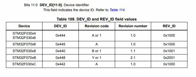

What is the unique device ID for STM32F030C8T6?
I want to know whether stm32f030C8T6 has unique device ID?

Thanks for your fast reply, And the unique device ID address is the same as stm32f105(0x0x1FFFF7AC)? Because there is no mention in RM0091 reference manual.
Mar 7, 2019 8:03 AM UTC
The reference manual related to the STM32F030C8 device is RM0360.
You can find the devide ID in this RM in section "26.4.1 MCU device ID code".
Kind Regards,
Imen.

But if "dev id " is device id so what is how it is different from UID.

As far as I know, Unique ID is not programmed for the F0 value for cost reasons ("32 cent for 32 bit").

But  RM0091 this pdf at page No.-925 /topic number -33.1 there is Unique device ID register .
waclawek.jan
Mar 7, 2019 9:32 PM UTC
RM0091 does not describe STM32F030.
As Imen said above,
