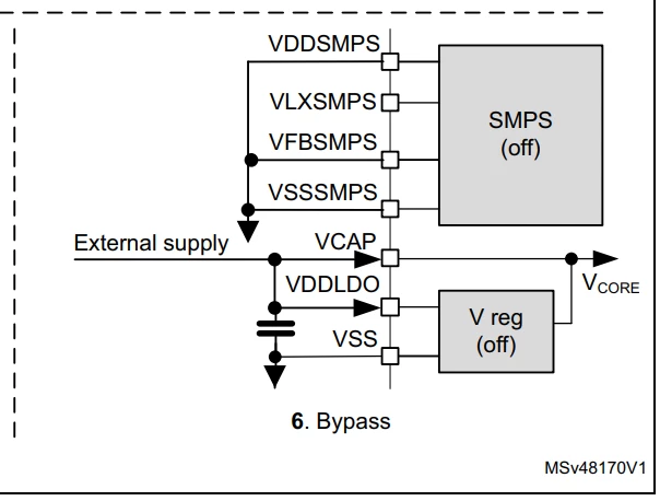

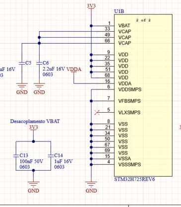

Thank you for your response. Unfortunately, our PCB is already in the prototype phase and we need to find a solution to power up the board for at least some basic testing.
Then, on STM32H725REV6, are both Direct SMPS and Bypass (external VCORE on VCAP, VDDSMPS tied to VSS, PWR_EXTERNAL_SOURCE_SUPPLY) officially supported supply configurations?

    This is another question that needs to be split as the original question ahs been answerd.
    Try the Bypass mode:
    In your previous schematic almost the same structure as the figure above:
    → Still need to supply Vcore over VCAP pins. Hope you can access to VCAP by having test points.
