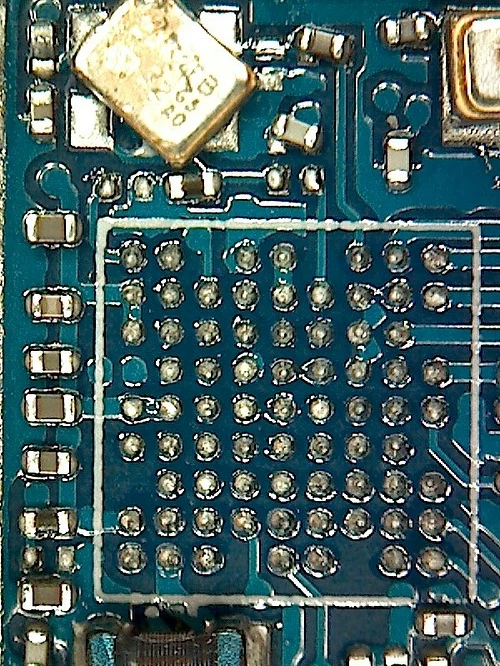

VREFBUF not working on STM32WLE5JC
Hello everyone,
I'm trying to set up VREFBUF as an internal reference at 2.5V, but the configuration isn't working. I've seen there were issues with this (VREFBUF Enable Problem - STMicroelectronics Community), but even after rearranging the function 'HAL_SYSCFG_VREFBUF_HighImpedanceConfig(SYSCFG_VREFBUF_HIGH_IMPEDANCE_DISABLE);', it doesn't work properly. I'm using the STM32WLE5JC on the 'Lora E5 mini' development board. Here is my code:

I just realized that in the Lora E5 chip the Vref+ pin is connected to Vadd pin, so that's the problem, it's not possible to use VREFBUF in this chip. In case anyone face the same problem I left here the internal connections of the STM32WLE5JC.
