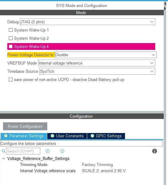

I am working on STM32G474CET mcu. I am trying to use VREFBUFF voltage for ADC channel referance voltage. My configuration looks like the following.
When i run the code, it stuck in the HAL_SYSCFG_EnableVREFBUF function. Whenever i check the 'tickstart'  variable it remains 0.

When i try the same configuration on empty project, it worked fine. So i can see its not about hardware. What am i missing?

Hello @gunccc,
Have a look at this FAQ: How to configure VREFBUF on my STM32,
May be this post can help: 2 bugs with VREFBUF and STM32Cube on at least STM32G4
Otherwise, please share your ioc file to check the case, and precise which CubeMx et firmware package versions are you using?

Thank you for your answer. Like you said 2 bugs with VREFBUF and STM32Cube on at least STM32G491 post really helped me. Like bobert said, i enabled the low impedance before Vrefbuf. And like that my code worked. But I had to interfere the STM's code. In order to use the user code section, I also had to include the enabling of the clocks in the user code. Now my MspInit code looks like that.

Also in using internal Vrefbuf : HAL Code generation issue post, people have used the same method as me and suggested this as a bug in HAL.

I escalated this issue internally and internal ticket (ID 159452) is submitted to be reviewed and treated.

This issue is fixed in the latest release of STM32CubeMx v6.15.
