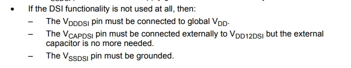

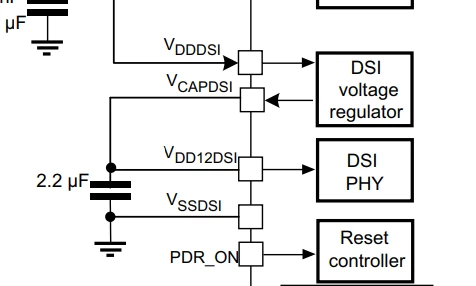

Hello everyone,
I am working on a system based on the STM32H747BIT6 MCU and do not plan to use the DSI interface. I have searched through various forums but still have some doubts about the proper power pin configuration when DSI is not in use. Here is what I have so far:
  • VSSDSI: Connected to GND
  • VCAPDSI: Connected to VDD12DSI (capacitor not required)
  • VDD12DSI: Uncertain about the correct connection. I would like to avoid using an LDO to step down from 3.3V to 1.2V
Does anyone have experience with this setup or any recommendations on the best approach for VDD12DSI?
Thanks in advance.

The same configuration as for STM32F777:
No need for external regulator. You need just to connect VDD12DSI to VCAPDSI.

May 17, 2025 6:03 PM UTC
I'm still confused about the details. The reference manual says to connect VDDDSI to the global VDD. Then after connecting VDD12DSI and VCAPDSI, should I connect those to VDD global? That sounds little weird to connect the (1.2V?) to my global 3.3V VDD.
May 18, 2025 2:31 PM UTC
No, you should not connect VDD12DSI and VDD. Why would you? They are clearly disconnected in the figure and there is no text instructing you to connect them.
