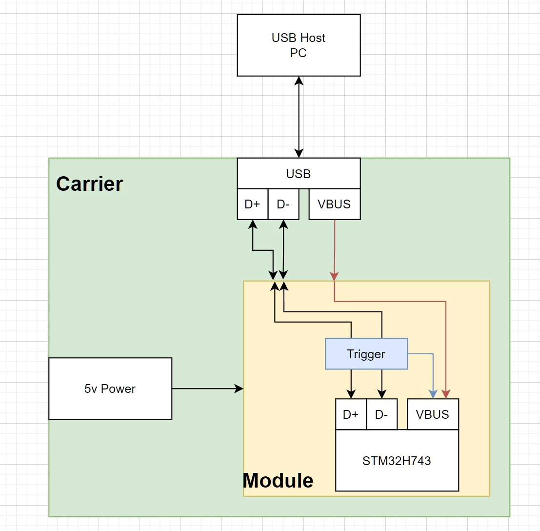

I should have been more clear.
I have a "Module" (Yellow) which contains some supporting circuitry and some sensors.
It is normally soldered onto a "Carrier" (Green) which has a USB plug to act as a slave to a host PC.
The problem is that the Module is small and has limited space for edge connections, so I am trying to avoid dedicating one to VBUS sensing. Is there anything I can do using just the Data signals to trigger VBUS (Blue) rather than dedicate an edge pin (Red)?
My Module is powered through a 5v power input, which might or might not be self powered/bus powered so cant be directly tied to VBUS (through a resistor divider). What happens if VBUS is always tied high but there's no USB attached?
FBLBest answer

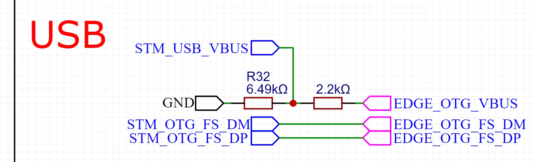

I have since got another board revision made that has the VBUS broken out separately but still have the same device descriptor request failed error.
Vbus is triggered through a Voltage divider as pictured below which is only active when the USB is plugged in.
I am using ChibiOS and have the VBUS sense pin set to an opendrain input.
