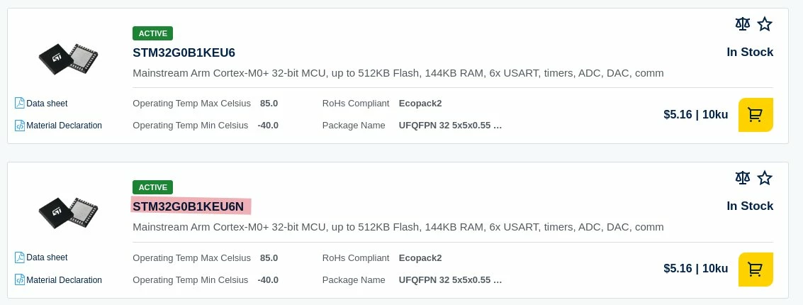

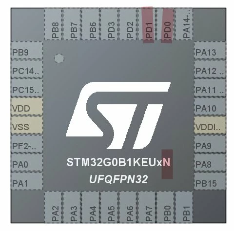

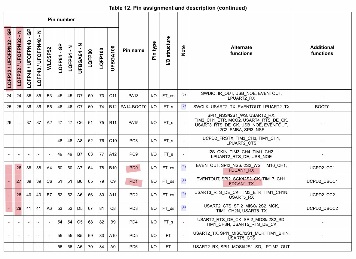

@EniRot99 wrote:
Given that these specific pins (PD0 and PD1) are not available on my microcontroller, I am curious to know:
Are you sure about this? The DS indicates there are two 32-pin variants, and one of them does have PD0/PD1.
And from the ST direct store:
and from CubeMX:

How to use the ST Open Bootloader for STM32 Microcontrollers
(This is strange. If ST knows it prunes FDCAN1 on some packages, why would they write the boot loader to use FDCAN1 instead of FDCAN2?) (*)
 (*) Update: as TDK said, FDCAN1 does exist on the chip, but only a different pair of pins are available for the FDCAN RX/TX signals.
"- If someone's post helped resolve your issue, please thank them by clicking ""Accept as Solution"".- Please post an update with details once you've solved your issue. Your experience may help others."
July 10, 2024
This chip still has FDCAN1 and pins that can use it, just not the pins that the bootloader uses. There are thousands of chips and much fewer bootloader versions, it's not going to be possible to micromanage every case.

July 11, 2024
and from CubeMX:
