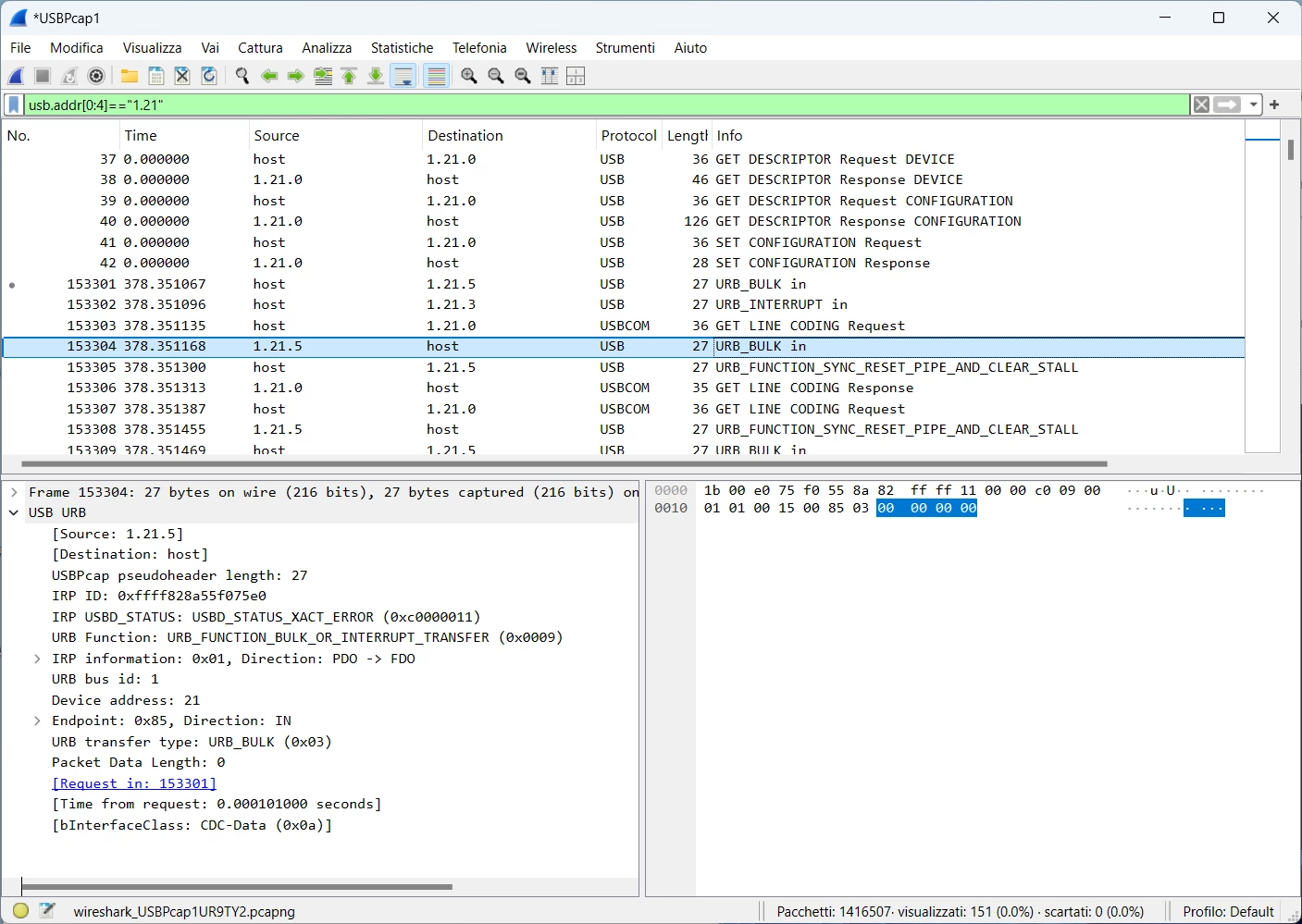

In particular I'm developing a composite USB device on USB OTG port, showing a custom device + a CDC device [ep 0x85, 0x06, 0x83] using USB_Device_Library code.
Windows correctly shows 3 items: a composite device, a generic USB device with my custom label/name, a virtual serial port (COM8).
When I try to open the virtual port (by Putty) I see nothing on the terminal but if I inspect with Wireshark I see an infinite loop of BulkIN request, BulkIn response with XACT_ERROR, a RESET_PIPE_AND_CLEAR_STALL with both request end reply.
I'n wondering why I have the XACT_ERROR on BulkIn request: I'm not able to find the point. I break-pointed some code in the HAL_PCD_IRQHandler() routine but it's hard to step in an interrupt handler.

Adding some notes...
Comparing with the run on the DEMO board I noticed that the IRQ handler is never recall  with interrupts for EP IN 5 (0x85), only for EP 0.
I guess that the XACT_ERROR is caused from the missing reply.

From the Wireshark capture I see the BulkIN packet toward 0x85 IN endpoint !
How it is possible?

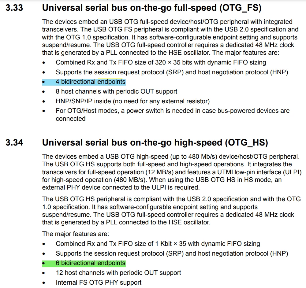

From the reference manual, it seems that EPs greater than 3 are not supported for FS USB mode, so it is impossible to set the mask for EP 5.
Please, can anyone confirm this?

Hi @SteMMo
You are right. Using FS instance, STM32F429 supports only 4 EPs (4 IN + 4 OUT)
You cannot use endpoint 0x85 (which corresponds to endpoint 5 IN) in FS mode. You need to reconfigure your USB device to use endpoints within the supported range. Otherwise, you can use HS instance.
To learn about the number of endpoints available, refer to the associated STM32 datasheet or section 2.1 "USB implementation on STM32 products" in application note 4879.  Also, you can check this article How to select suitable endpoints for your STM32 US... - STMicroelectronics Community
