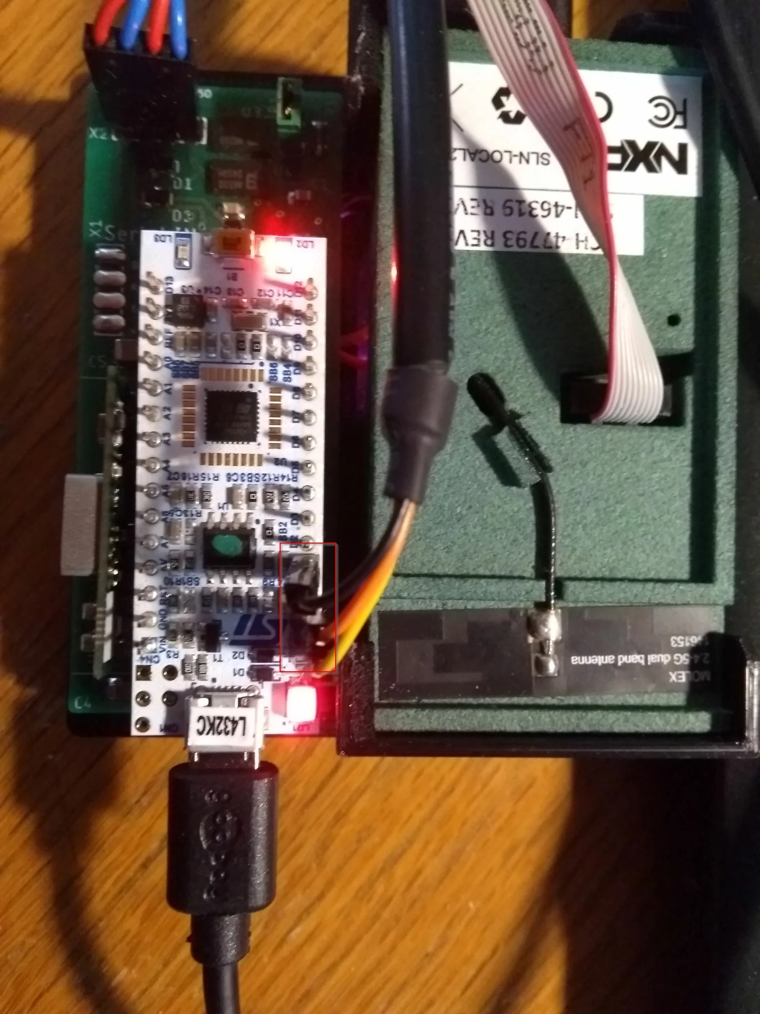

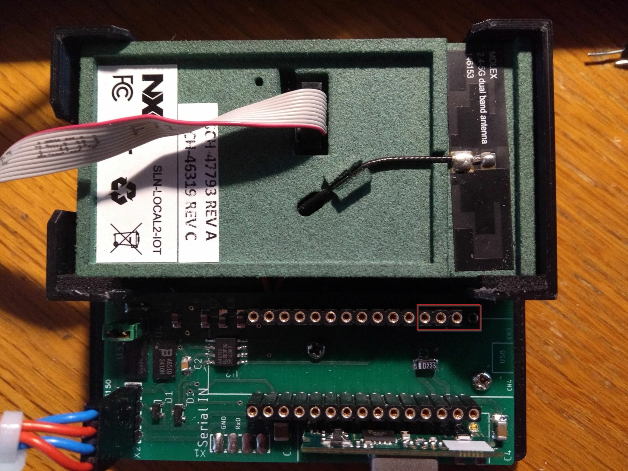

UART1 is configured to output pins PA9 (Serial1 TX) and PA10 (Serial1 RX), both connected to serial output from other MCU. If I check without STM MCU, all data is correctly sent from this MCU (as I can check with serial terminal connection). But as soon as I connect with STM, serial data flow stops from other MCU, no other data is seen if I connect serial cable to pins PA9/10 mentioned above.
