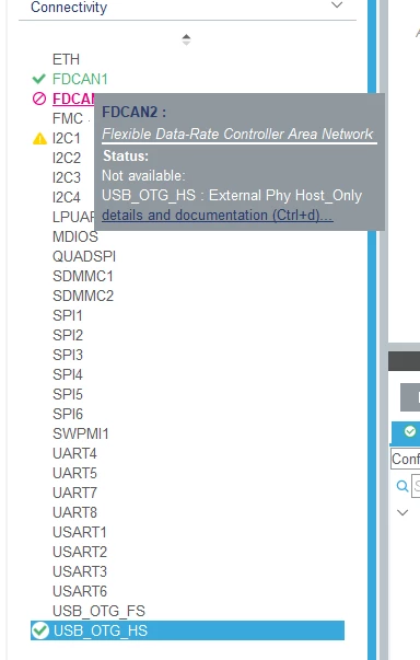

I want to use the ULPI interface & both the CAN interface for my project
But I see
For USB:
Pin No: 194     pin name: PB5     Module function :  USB_OTG_HS_ULPI_D7,   ONLY ONE PIN no other pins are there
For CAN
Pin No: 194,195    pin name: PB5,PB6     Module function :  CAN2_RX,CAN2_TX
Pin No: 104,105    pin name: PB12,PB13     Module function :  CAN2_RX,CAN2_TX
How to proceed with it, since we have clash with Pin No 194?

Doing the exercise on STM32CubeMX, it seems you cannot use FDCAN2 with USB_HS with external PHY as they share some IOs:
So you can't use both USB_HS and FDCAN2 at the same time. Unfortunately, no alternative for FDCAN2

To be exact which part number? (STM32H743BIT6 ? as per your previous thread). That indicates also the package.
MeghnaAuthor
May 21, 2025 1:59 PM UTC
As suggested in the datasheet STM32H743BIT6 we are interfacing it with USB3320 using ULPI interface, apart from this we have using CANFD 2 interfaces , there we are seeing that pins are overlapping, where in we cannot support these 3 (CANFD1, CANFD2, ULPI), Am I wrong somewhere?
