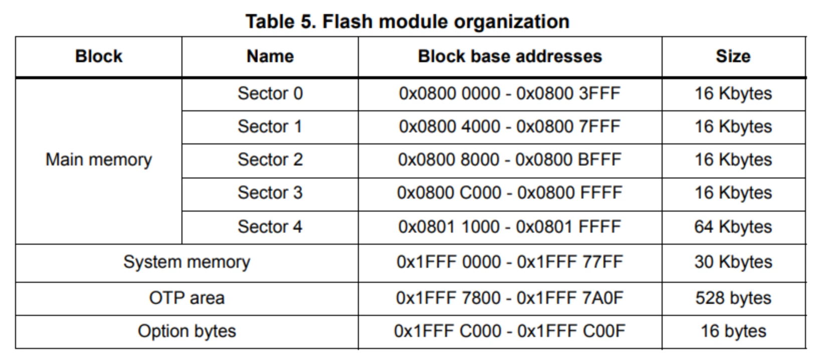

Your question isnt clean info, then reply is simple example. Here is one example of unnamed mcu flash sectors
as you can see have 5 area for erase sectors, then this is all limits for your loaders. Too i dont understand why you named secondary . How is primary bootloader function ?
