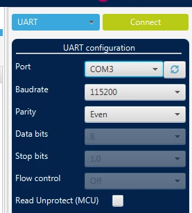

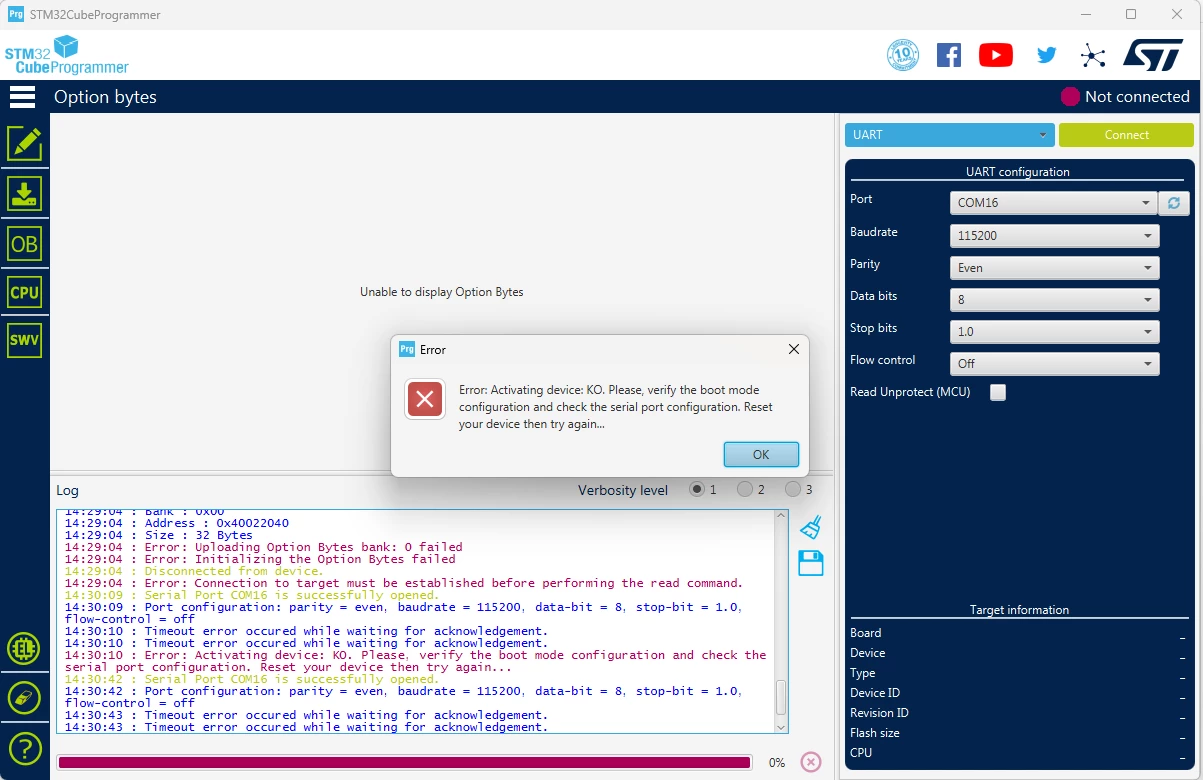

After setting up the boot configuration, I attempted to connect the STM32's UART using a TTL converter and the STM32CubeProgrammer software (Win64, versions 2.18.0 and 2.5.0). However, I encountered some issues, and I have attached a snippet showing the error.
I also tried connecting an STM32L562E-DK board, but I faced similar issues.
Could anyone help identify what might be going wrong? Your suggestions and advice would be greatly appreciated!

1- Are you sure the UART converter is OK? need to tell us how you did check this converter is working well.

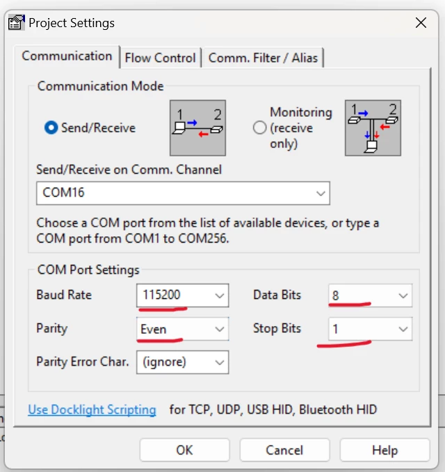

1. TTL Converter:
The TTL converter is working correctly. Before attempting the boot method, I verified its functionality by running a UART communication test application. The test confirmed that the TTL converter is operating without any issues.

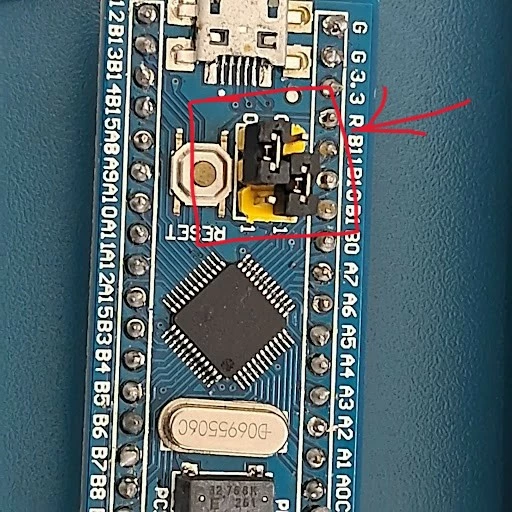

Boot Pin Setup:
I set the boot pins as follows:
BOOT0: High
BOOT1: Low
Refer to the attached image for the configuration.

After this setup, I sent the 0x7F command to initiate communication but did not receive any response. Additionally, I could not establish a connection using the STM32CubeProgrammer software.
Refer to the attached images for further details.

Looks like you are using a Blue Pill board. I recommend to use one of the ST boards instead of these Black/Blue (or other colors) Pill boards that most probable have a fake STM32.

After following your advice, I was finally able to boot via UART using the STM32 NUCLEO-L053R8 board. It seems that the Blue Pill board I initially used might have some issues, as switching to the NUCLEO board resolved the problem. I successfully booted the STM32 via UART and connected it using the STM32CubeProgrammer, following the bootloader configuration document provided by ST (AN2606).
