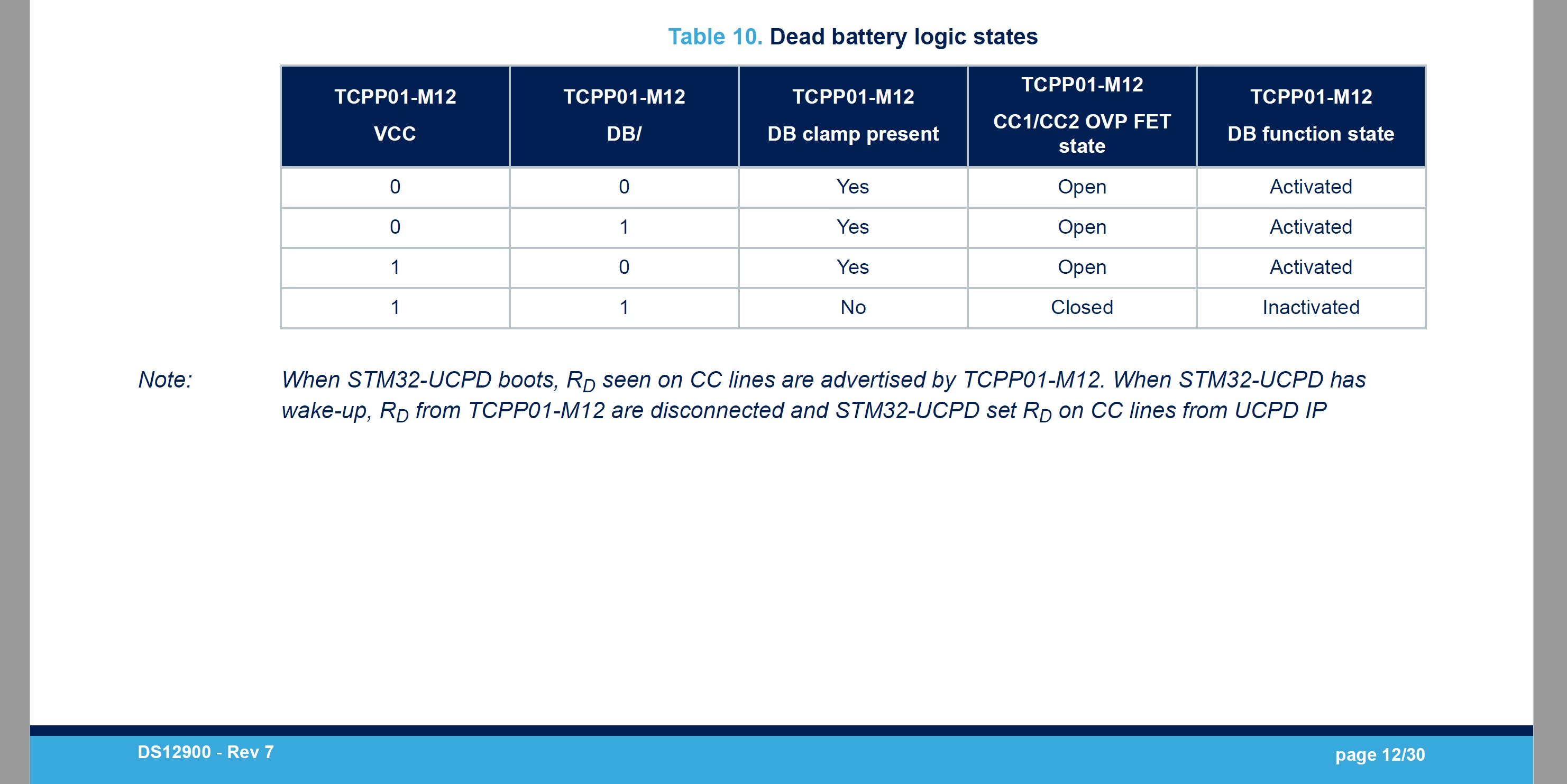

May be this behavior is linked with TCPP01 DB state. Even if you set S8/9/10, TCPP01 chip is still present in Nucleo board, so affect CC1/2 lines.
Try to disactivate TCPP01 DB:
  #define UCPD_DBn_Pin GPIO_PIN_5
  #define UCPD_DBn_GPIO_Port GPIOB
  // Set TCPP01 DB  inactive
  HAL_GPIO_WritePin(UCPD_DBn_GPIO_Port, UCPD_DBn_Pin, GPIO_PIN_SET);

@OlivierR Thank you for some hints. Initially I have considered removing TCPP01 chip, but my understanding is that all it does to CC lines is either disconnects them for protection or when it pulls them down in DBCC mode. What harm could that cause, other than maybe incorrect TYPEC_VSTATE_CCn readings?
But anyway, I tried setting UCPD_DBn high before enabling UCPD. Still no luck.
Nucleo-H563ZI uses TCPP01 configured exactly the same way, but UCPD seems to initialize correctly without enabling TCPP01.
