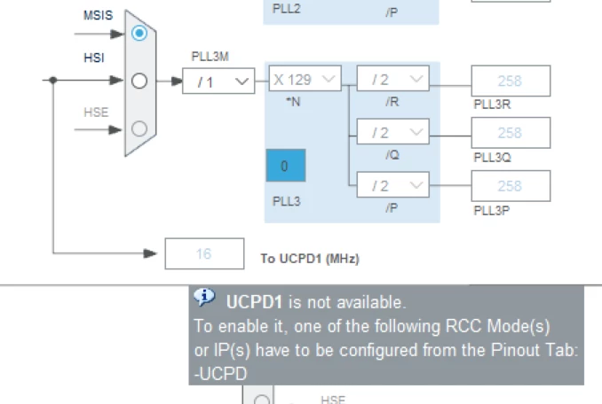

UCPD activation crashes STM32U5 MCUs - hardware bug?
Using Nucleo-U575ZI-Q (rev X) board I try to do a PoC - a very simple UCPD source app providing default USB 5V and 0.5A max. With undocumented onboard SB8-10 shorten this probably can be accomplished. I know this board does not provide output current control, but that is OK, it is just a simple UCPD test to check if I am able to control CC lines state and receive line state change events, no BMC communication.
At first, I tried to use CubeMX middleware. Generated application requires two DMA channels, one advanced timer, uses proprietary ST library and crashes MCU so badly that probably no fault handler is even being called.
So I tried to activate UCPD and monitor CC lines with my simple code. As soon as I activate the Rp resistor MCU crashes, debug communication is lost. Sample code below. Please Advise.
Firmware package version: 1.3.0
Update: I got success, but with Nucleo-H563ZI Rev W. Using the same code (w/o trimming) I was able to correctly read SR.TYPEC_VSTATE_CCn, UCPD1_IRQn seems to fire as expected.
Then I tried with another U5 board (B-U585I-IOT02A, Rev X) and the result was consistent with the first one - MCU crash.
The question: what is so different between H5 and U5 MCUs with respect to UCPD?
Or maybe what matters it is MCU revision? I am stacked and clueless.
What is the correct UCPD activation routine for SM32U5 MCU?
No sample code seems to be available, CubeMX uses ST proprietary library.

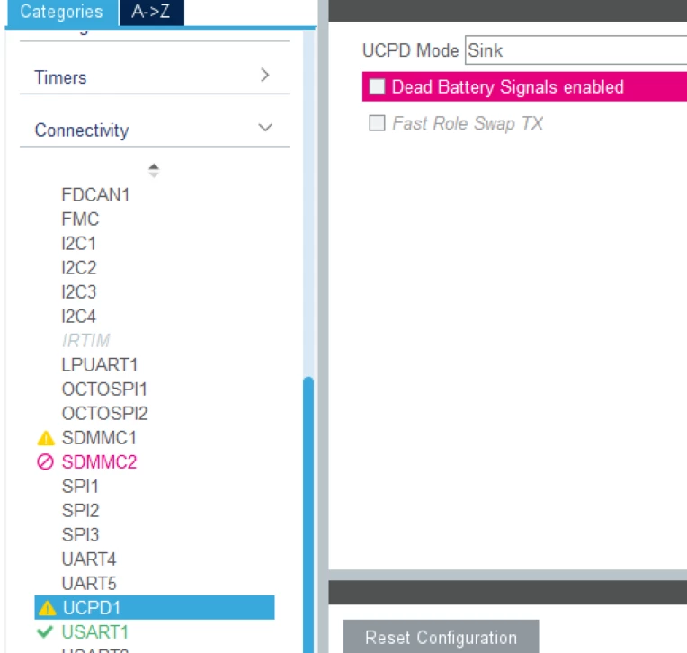

@OlivierR Problem solved! What was missing was HSI clock activation - UCPD depends on it.
I believe it is a CubeMX bug. STM32U5 UCPD is clearly enabled, but CubeMX does not think it is enabled and probably for that reason it does not configure HCI clock. This does not happen with STM32H5. It indicates that CubeMX QA process may still have space for improvement.
