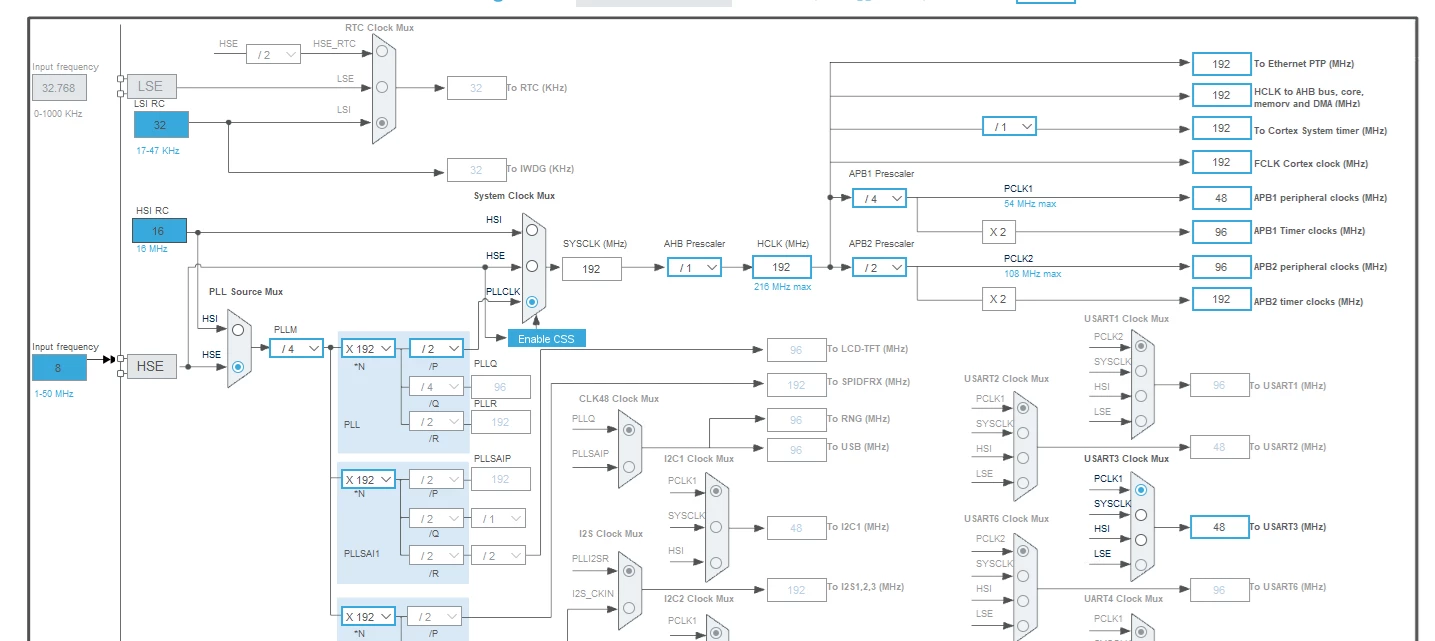

NUCLEO F767ZI, CubeIDE 2.1.1, CubeMX 6.17.0
I'm trying to set up UART with printf()

Clock tree from MX

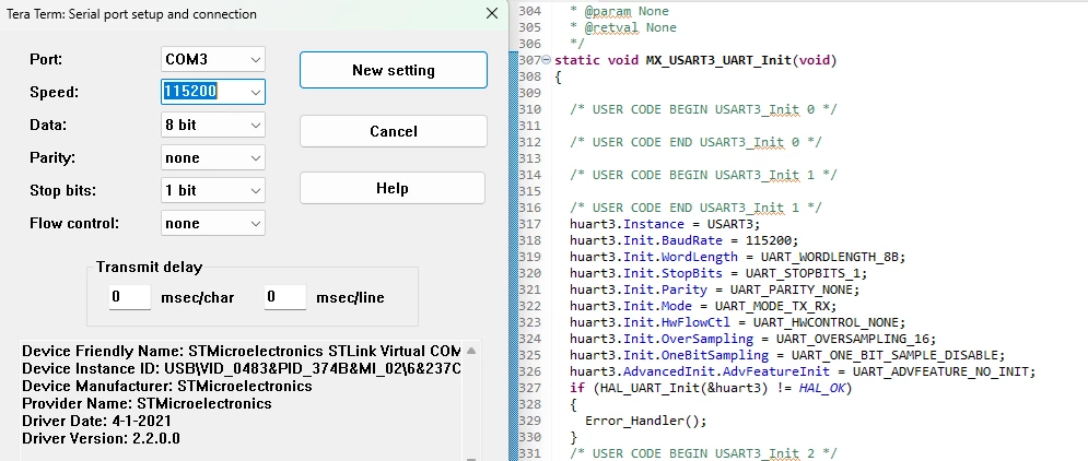

Output in Tera Term window
TT is set up exactly the same as the UART init in the code.
Anyone know whats going on here?

mƎALLEm
March 25, 2026
You have set a wrong HSE clock value to 25MHz:
You need to set it to 8MHz as the ST-LINK-V2 MCO output on that Nucleo board is 8MHz

Andrew Neil
March 25, 2026
Gibberish on a terminal is almost always due to wrong baud rate.
As @mƎALLEm said, if you enter the wrong value for the HSE clock frequency, then your baud rate will be wrong - as will any other frequencies derived from HSE.

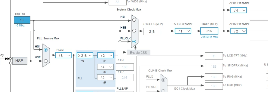

mƎALLEm
March 25, 2026
And what if you select HSI as clock source instead of HSE?:
If it's working, that means definetly you have an issue with HSE, a missing solder bridge on STLINK MCO output path or something similar. If not, you have an issue with TeraTerm UART configuration.
Senior III
March 25, 2026
No not working with HSI either
Settings in TT are the same as in the USART3 init. (I've also tried RealTerm & get the same gibberish there too)

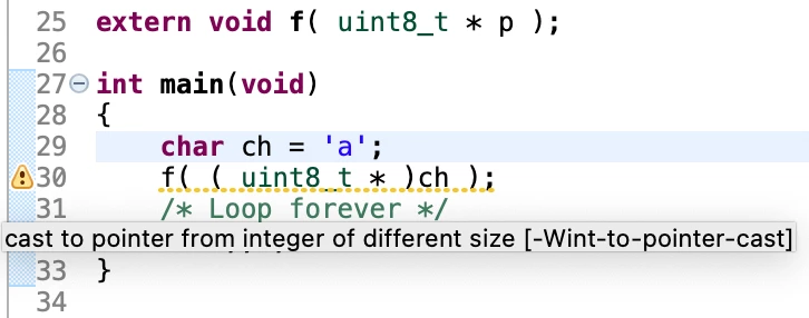

CTapp.1
Senior III
March 27, 2026
One of those mistakes that we've probably all made that take forever to spot as you read what you thought you had typed when looking at the code ;)
Something that static analysis can help with on a good day.
All posts are made in a personal capacity. MISRA C++ Chair, MISRA C WG Member, Director The MISRA Consortium Limited (TMCL)
Andrew Neil
March 27, 2026
Unfortunately, the mistake was masked by the (uint8_t*) cast - without that, you'd have got a compiler warning...
CTapp.1
Senior III
March 27, 2026
GCC does generate a warning for it:
