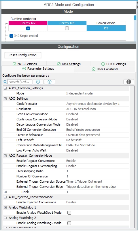

Trying to run the ADC with DMA on STM32H755ZI-Q

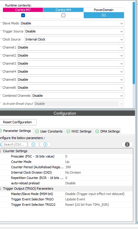

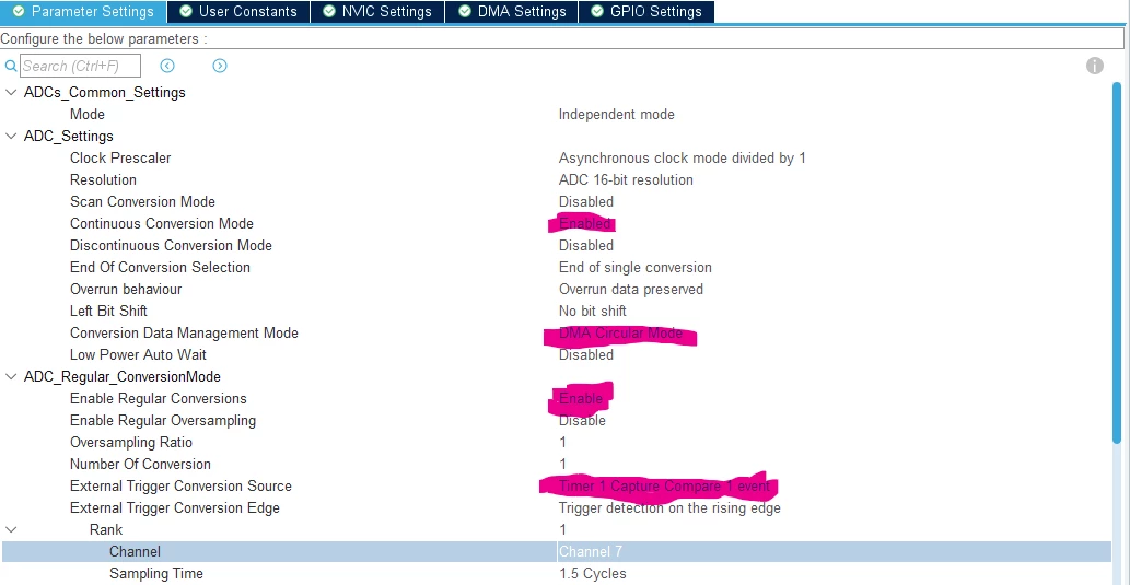

I a using a NUCLEO-H755ZI-Q on STMCubeide 1.18.0
i am trying to use the Timer 1 to capture on the rising edge using the analog to digital converter

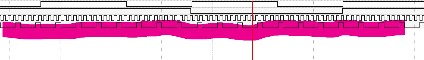

those are my signals the lase one (pink is my signal that i want to capture at this frequency)
those are my IOC settings
on the input of the ADC I have an analog signal Syncronised on timer one for capture
i try using this Tutorial and only obtain those results:

my code for this is
#define CCDBuffer 6000
volatile uint16_t CCDPixelBuffer[CCDBuffer];
uint16_t ProcessingBuffer[CCDBuffer];
HAL_TIM_PWM_Start(&htim4, TIM_CHANNEL_1); //sh
HAL_ADC_Start_DMA(&hadc1, (uint32_t*)CCDPixelBuffer, CCDBuffer);

 so i get data once and nothig after i had the impression the i was supose to capture data when the timer one is active but seem like it only work one time
my plan is to gather data in a buffer to later make mathematical operation but cant get it to work propelly all the time the timer one is active

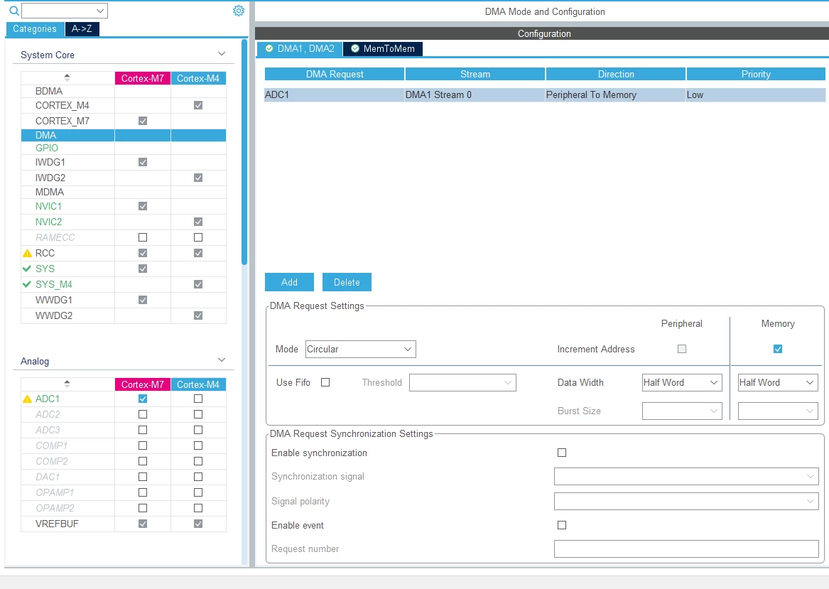

May 24, 2025 1:12 PM UTC
Your DMA is in normal mode. The tutorial has it in circular mode.
May 24, 2025 2:49 PM UTC
Thank you so mutch for you repply it is really appreciated

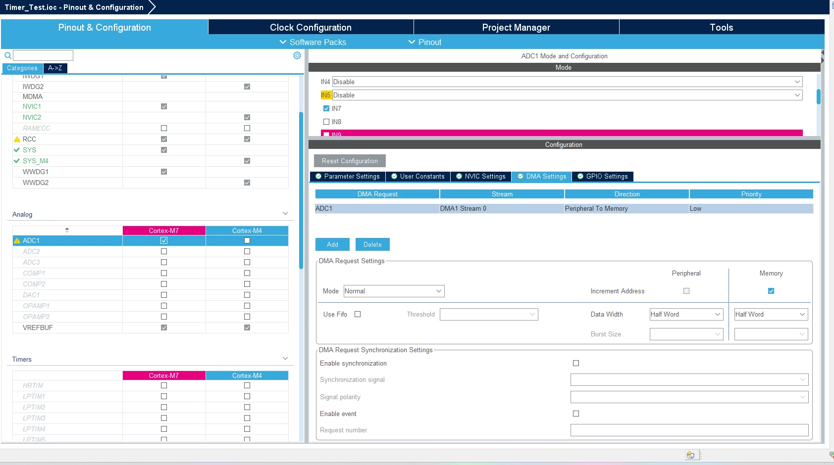

i  have change the mode to circular mode but now i have no data output sample its not running enven once before stopping did i miss something else thak you for any help i relly appreciate it
EDIT i change the priority to HIGH and the setting for my code is:
void PeriphCommonClock_Config(void);
static void MX_DMA_Init(void);
static void MX_TIM2_Init(void);
static void MX_TIM3_Init(void);
static void MX_TIM4_Init(void);
static void MX_TIM1_Init(void);
static void MX_ADC1_Init(void);

William133467AuthorBest answer
May 27, 2025 5:32 AM UTC
in big you need to remap to ramd2
main code:
void StartAcquisition(void);
void StopAcquisition(void);
__attribute ((section(".adcarray"))) uint16_t ADC_VAL[3694];
void StartAcquisition(void) {
	BSP_LED_On(LED_YELLOW);
 __HAL_TIM_SET_COUNTER(&htim2, 95);
 __HAL_TIM_SET_COUNTER(&htim4, 75);
 HAL_TIM_PWM_Start(&htim3, TIM_CHANNEL_1); // fm
 HAL_TIM_Base_Start(&htim1); // adc trigger
 HAL_TIM_PWM_Start(&htim2, TIM_CHANNEL_1); // icg
 HAL_TIM_PWM_Start(&htim4, TIM_CHANNEL_1); // sh
 HAL_ADC_Start_DMA(&hadc1, (uint32_t *)ADC_VAL, 3694);
void StopAcquisition(void) {
 HAL_ADC_Stop_DMA(&hadc1);
 HAL_TIM_PWM_Stop(&htim3, TIM_CHANNEL_1);
 HAL_TIM_Base_Stop(&htim1);
 HAL_TIM_PWM_Stop(&htim2, TIM_CHANNEL_1);
 HAL_TIM_PWM_Stop(&htim4, TIM_CHANNEL_1);
 BSP_LED_Off(LED_YELLOW);
void HAL_ADC_ConvCpltCallback(ADC_HandleTypeDef *hadc) {
 // Copier les données du buffer ADC dans le buffer de traitement
 //for (int i = 0; i < CCDBuffer; i++) {
 //ProcessingBuffer[i] = CCDPixelBuffer[i];
	//ADC_VAL = HAL_ADC_GetValue(hadc);
	//printf("ADC value (DMA): %u\r\n", ADC_VAL[0]);
	SCB_InvalidateDCache_by_Addr((uint32_t *)0X30000000, 7388);
	StopAcquisition();
 acquisitionDone = true;
 acquisitionInProgress = false;
flash.ld :
	.mysection (NOLOAD):
		. = ABSOLUTE(0x30000000);
		*(.adcarray)
	} >RAM_D2
