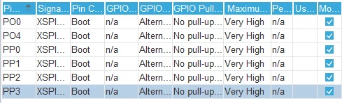

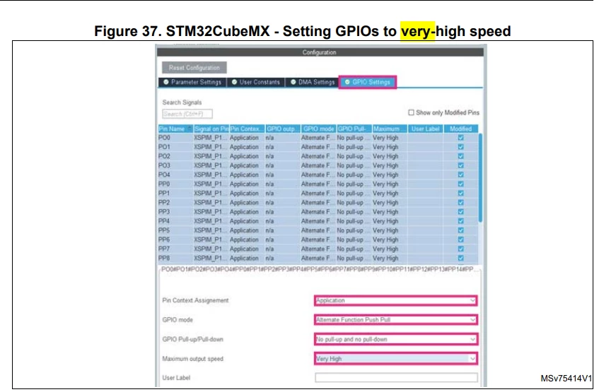

Hello @andgarriv,
Please make sure that all GPIOs configured to very-high speed.
Which Refresh rate are you using?
Thank you.
Kaouthar
andgarriv
andgarrivAuthor
June 5, 2025
Hi Kaouthar,
The GPIOs are already configured to Very High speed by default. As for the refresh rate, I have tried several values. Currently, the XSPI clock is running at 50 MHz with a prescaler of 1 (so the PSRAM sees 25 MHz), and I am using a refresh value of 200.
Thanks,
