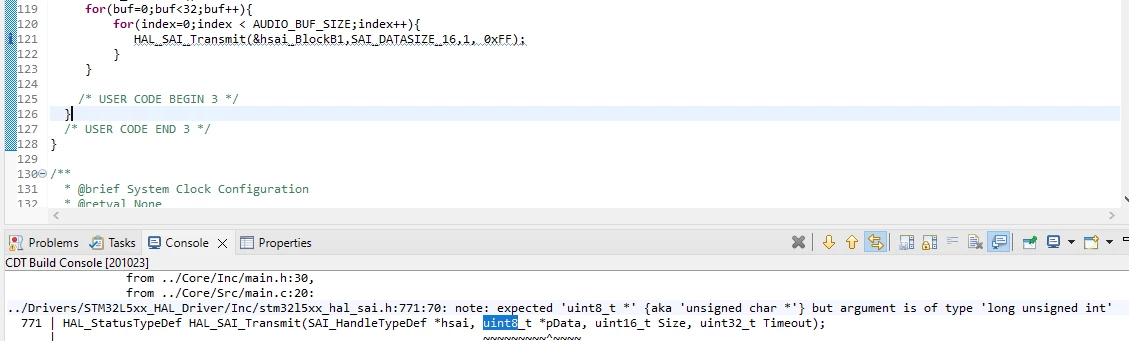

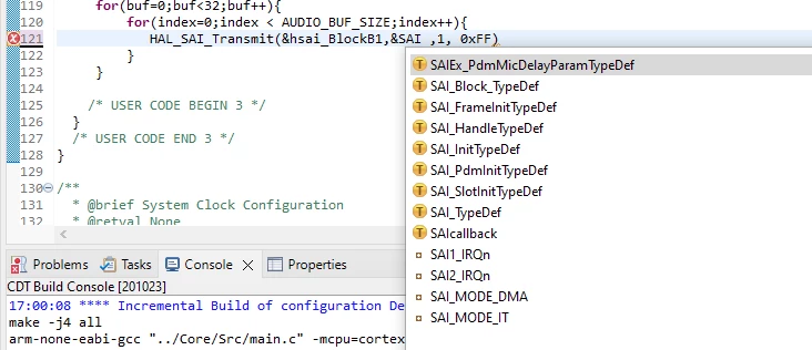

I tried to adapt the code to my microprocessor but I don't know which one to choose? In your opinion ?
After me the SAI (equivalent to I2S) work with 3 possible modes: IRQ, DMA and IT. Probably, I'll start with IRQ to make it as simple as possible.
I do this but I get a warning. Do you know how to call the SAI function to retrieve the values ?
Pavel A.
October 30, 2023
Source of the ST library is available. Please read the documentation in the library files (.h and c) , it is helpful. The compiler warnings are very helpful - please read them and try to understand the reason.
DYann.1
DYann.1Author
Senior II
October 31, 2023
Just to need the type and now It's correct.

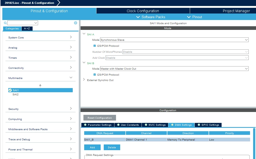

When I have this configuration with the SAI + DMA, I have no communication problem with I2C to configure the CODEC.
But I don't know where the DMA stores the values ? How to recover these values ? Do you have any information or documentation so I can better understand ?
Thank you
LCE
Principal II
October 31, 2023
Oh my... you need some basic tutorials!
CubeMX does just the basic setup for the peripherals.
You need to start the DMA transfers, by doing that you assign some buffers, and that's where you'll find the data.
Look for some simple example code for your STM32, go through that step by step and try to understand that.

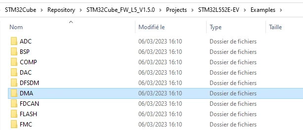

Of cours I'm a beginner... So you have a problem with theses people ? I just ask how DMA works or the documentation.
After your explanation, I can find an example of code with my evaluation card and thank you
But it's even better if I can find the principle of how DMA works, I've seen so many tutorials on youtube and code examples but nothing matches what I'm doing exactly.
