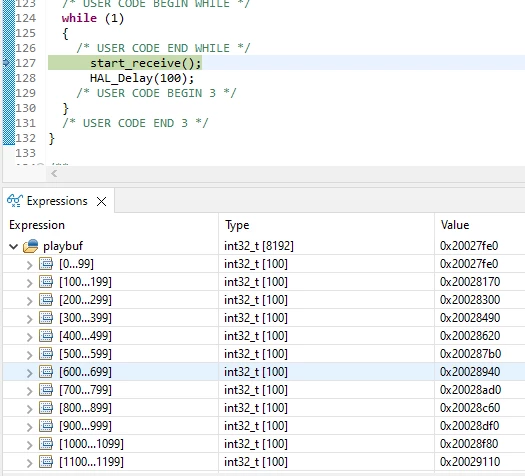

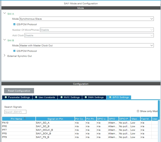

After reading the SAI and DMA documentation, I coded a piece of the program. I think I'm recovering data. Here is the code what do you think ? Thank you for your help.

Here is what I see in the table :
Pavel A.
November 2, 2023
The last image "Expressions" is indeed confusing. The values in the rightmost column are not values but addresses of 100-item slices of array playbuf.  If you expand any slice it will show the actual array elements.
This is how the Eclipse debugger behaves ((
LCE
Principal II
November 2, 2023

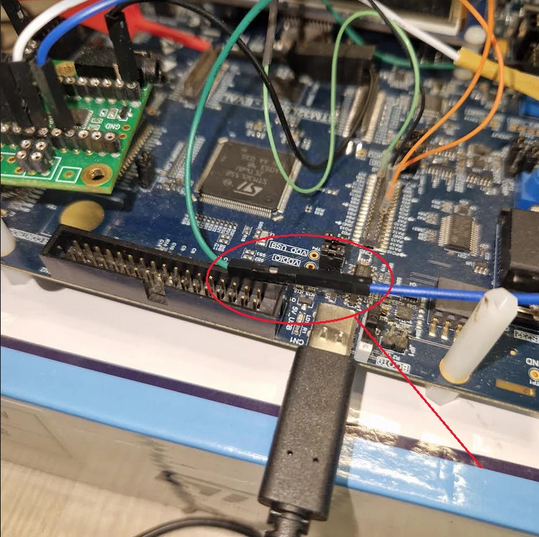

For simple testing without the Codec, you could directly connect SAI data output to data input, then compare transmit buffer ("playbuf")  with the receive buffer.
Start with a simple signal in playbuf, like playbuf[i] = i; i++;

It's a good idea but after my configuration :
Right for SAI data output to data input but what should I do for the other 3 connections ? Which are :
SAI1_MCLK_B (Master CLK)
SAI1_FS_B (Frame Synchro)
SAI1_SCK_B (Bit Clock).
I still let them connect to the CODEC, it seems to me, right ? In my case I just connect
SAI1_SD_B with SAI1_SD_A. Right ?

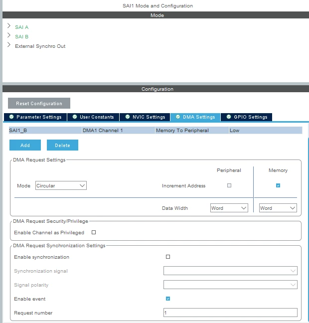

I wonder what is the meaning of 'Memory To Peripheral'. After me the DMA stores data in a device but what is this device? A user-defined memory area ?

The SAI blocks can be synchronized internally.
Connection: I mean a hardware connection from pin to pin, don't know if that is feasible on your board, there might be some soldering involved.
Memory: internal SRAM buffer, those you assign by calling the DMA start function
Peripheral: all that stuff not CPU or memory, like interfaces (in your case the SAI), ADC, DAC, Timers, ...
Data go this way:
  • ext. ADC -> SAI RX -> DMA -> SRAM AD buffers
  • SRAM DA buffers (your "playbuf") -> DMA -> SAI TX -> ext. DAC

Thank you for your helps, this information is very clear (for me) compared to the numerous videos or code examples that I have seen. No problem for the connection, I've the evaluation board STM32L5 and the CODEC so I use this jump between 2 connections  :
Sorry In my program I did not call the DMA Start function as you say. I configured the DMA in circular mode only :
I don't know if this is the right method but I have no errors when my program runs.

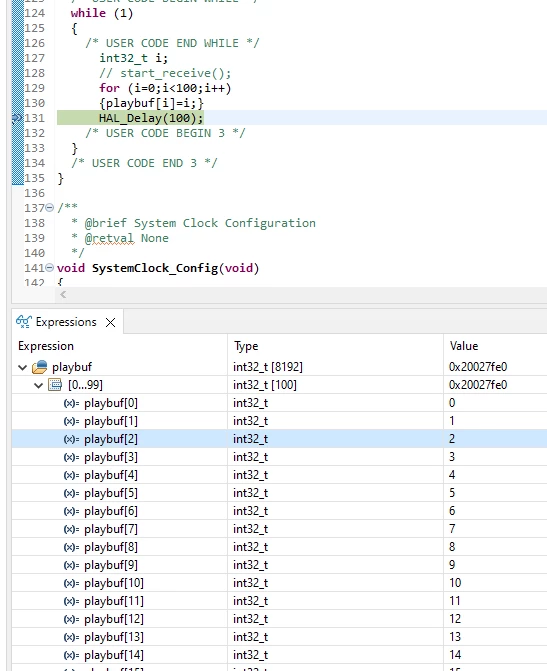

Here is my Main for this moment :

LCE
Principal II
November 2, 2023
I'd rather fill the buffer once, before the while loop, and fill it completely.

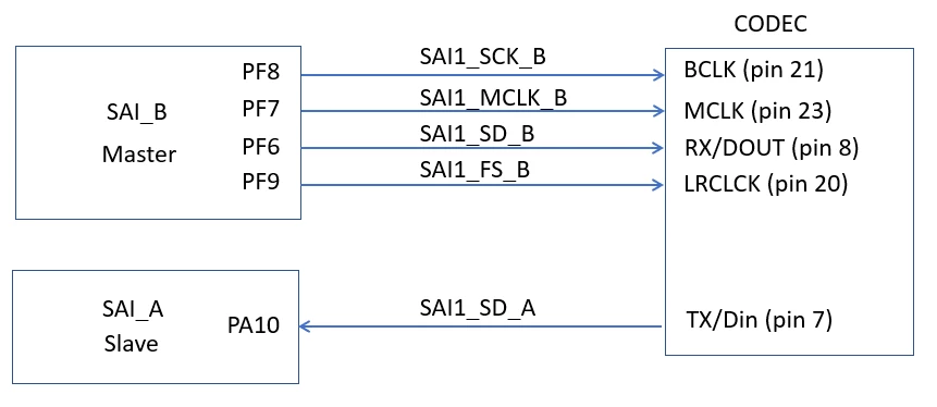

What kind of of hardware do you actually have?
Is a Codec connected, and if yes, how?
How are the SAI blocks set up? Which is transmitter, which is receiver?
DYann.1
DYann.1Author
Senior II
November 3, 2023

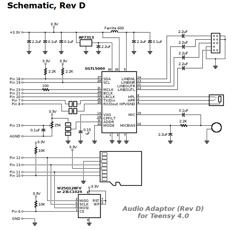

"What kind of of hardware do you actually have ?"
I have a STM32L552E-EV evaluation board with audio board (CODEC SGTL5000, Audio Adaptor Rev D for Teensy 4.0).
https://www.pjrc.com/store/teensy3_audio.html
"Is a Codec connected, and if yes, how?"
Yes the CODEC is connect to the STM32 and my configuration with the CODEC is :
According to my knowledge via the documentation
FSx - Frame Synchronisation
SCKx - bit Clock
SDx - Serial data line
MCLK - Master Clock
And for I2S LRCLK is equivalent FS for SAI.

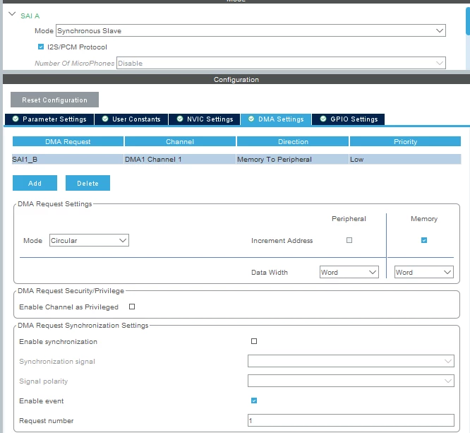

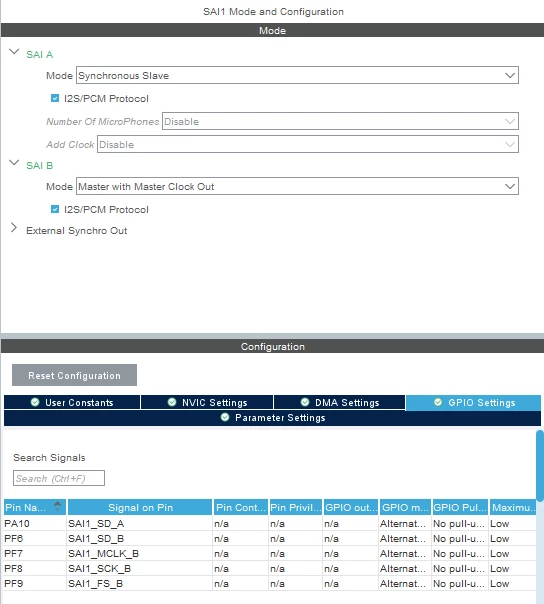

"How are the SAI blocks set up?"
I have this configuration but I don't know if I answer your question ?
The transmitter is SAI B and the receiver is SAI A (so CODEC is the slave after me). I hope I answered your questions.
