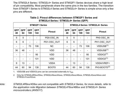

Dear @JKW , all,
My contribution to the thread - best replacement is STM32L4 series for both pin-to-pin compatibility with a 99% match to not say 100% ( due to the NC pin) just to wire to VDD - and will solve the power consumption as L4 series is on our best in class Cortex-M4 at 80MHz ULP line .
here LQFP100 column matters to migrate from F1 to L4.
Ciao
STOne-32

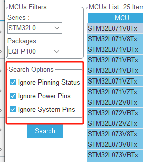

Doesn't CubeMX have a method of showing pin compatibility?
JKWAuthor
May 7, 2024
Thanks for the hit. I tried it in CubeMX, there are quite a few compatible part . But I still have question for below:
If I deselect the 3 options, there is none candidates.

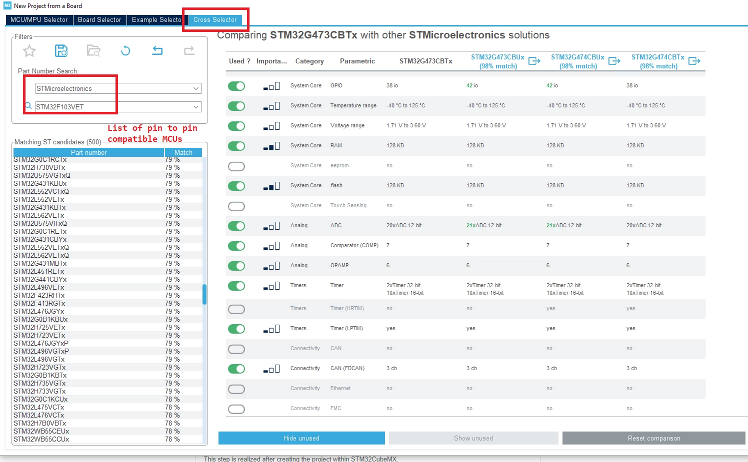

You can use CubeMx tool / and cross Selector menu for that purpose:
For more details, refer to that knowledge base: https://community.st.com/t5/stm32-mcus/how-to-find-compatible-devices-for-an-mcu-stm32g473cb-as-example/ta-p/49636
JKWAuthor
May 7, 2024
It's quite helpful. Thanks a lot.

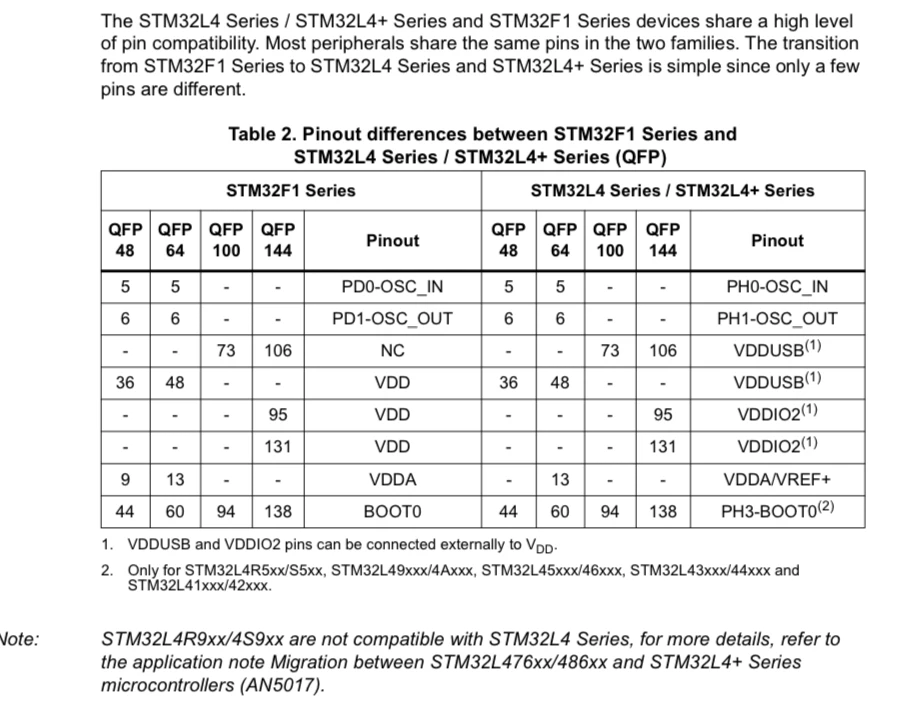

Dear @JKW , all,
Ciao
STOne-32

question for the PIN NO.73, because the board assembled MCU is already there, but it;s  NC pin in STM32F1 while it is VDD pin in STM32L4. In my board the NC pin is a no connection design, so I replace the  chip with STM32L4, will it work, missing a VDD power supply?
mƎALLEm
May 8, 2024
You need to connect that VDD pin otherwise you may face some issues.
