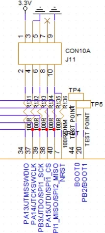

we are using STM32F030CCT6 MCU and the communication is with SWD.
for debugging we are using ST link v2 debugger, when we connect the target we are unable to connect. and it is displaying the target not detecting it.
need help on this, I am attaching here the connection diagram FYI...

Hello @jayaraogotru ,
Try upgrade the ST-LINK firmware.
Did you have an issue when using STM32CubeProgrammer?
Please have a look at this FAQ: How to solve debugger connection issues - STMicroelectronics Community
