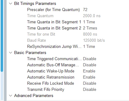

I am Struggling with STM32L432 CAN Bus communication from one STM32L432 to another STM32L432 using MCP2551.
* I have checked loopback works.

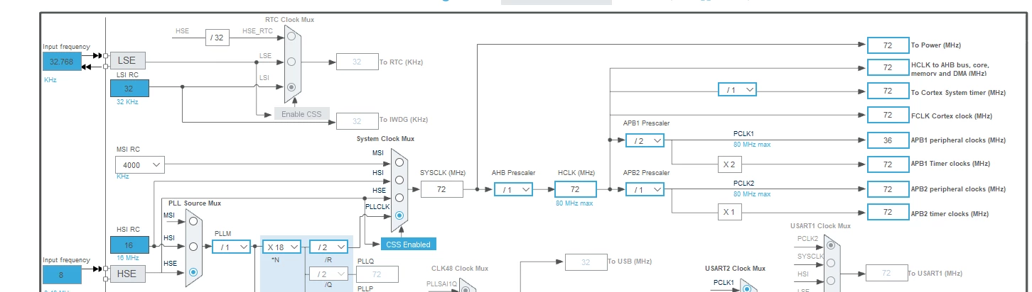

*I am using HSE Clock (After soldering SB17) -
* I have also tried putting Oscilloscope at TX pins between STM32 Transmitter and MCP2551 but signal just stays high.
* Plus, i can see that this never triggers but putting it in debug mode and putting a breakpoint in there
I also tried following this guy: 115. STM32CubeIDE MCP2551 CAN BUS with STM32 F103C8T6
but to no avail.
* I also tried doing the same setup i.e. ADC on transmitter sending information to other side via CANBUS.
* I have quadrupled checked Hardware circuitry, and all seems to be right.
* CANBUS Distance is also less than a meter now with termination at both ends.

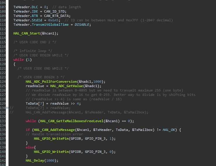

TX Code -

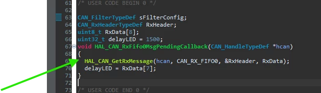

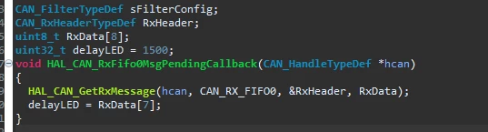

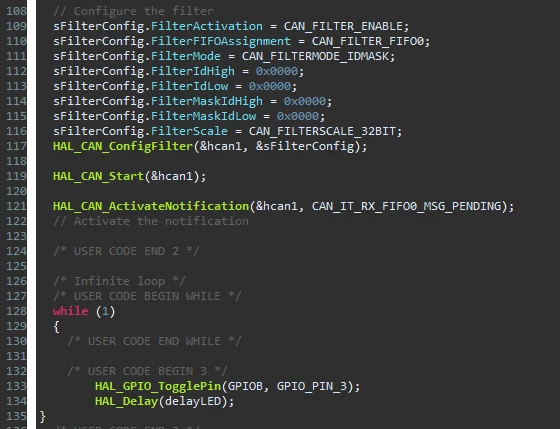

RX Code -
Any help would be much appreciated.

Hello @Dave001  and welcome to the ST community,
First in next time please use </> button to share your code instead of sharing screen shots. Please review how to post a code.
Second, these are a very bad bit timing parameters:
You need to decrease as much as possible the Prescaler and increase as much as possible BS1 and BS2 while having a simple point at around 87%;
Refer to this article: CAN (bxCAN) bit time configuration on STM32 MCUs
This link can help you to calculate the timings parameters. You need to select:
Hope that helps.
