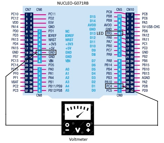

Solution:
The following code snippet shows how the output pin PC4 is pulled down (0V) in the low-power Standby Mode of the STM32G0 MCU. A NUCLEO-G071RB board was used for developing and testing the code, which is based on the ST example PWR/PWR_STANDBY. The ST example was modified and expanded. These are the main steps:
  • Determine if the MCU wakes up from Standby mode then resets the appropriate flags and registers.
  • Configure and set the test GPIO output pin to HIGH. (The output will later be pulled down for verification).
  • Use the PWR_PDCR register for controlling the GPIO output state (pull down to LOW) in Standby Mode.
  • Enter the low-power Standby mode.
  • Wake up from Standby Mode by pulling the WKUP pin2 HIGH.
The output voltage before and after entering Standby Mode was measured with a voltmeter (Figure 1).
Figure 1. Pinout of the NUCLEO board.

Solution:
Code snippet:
