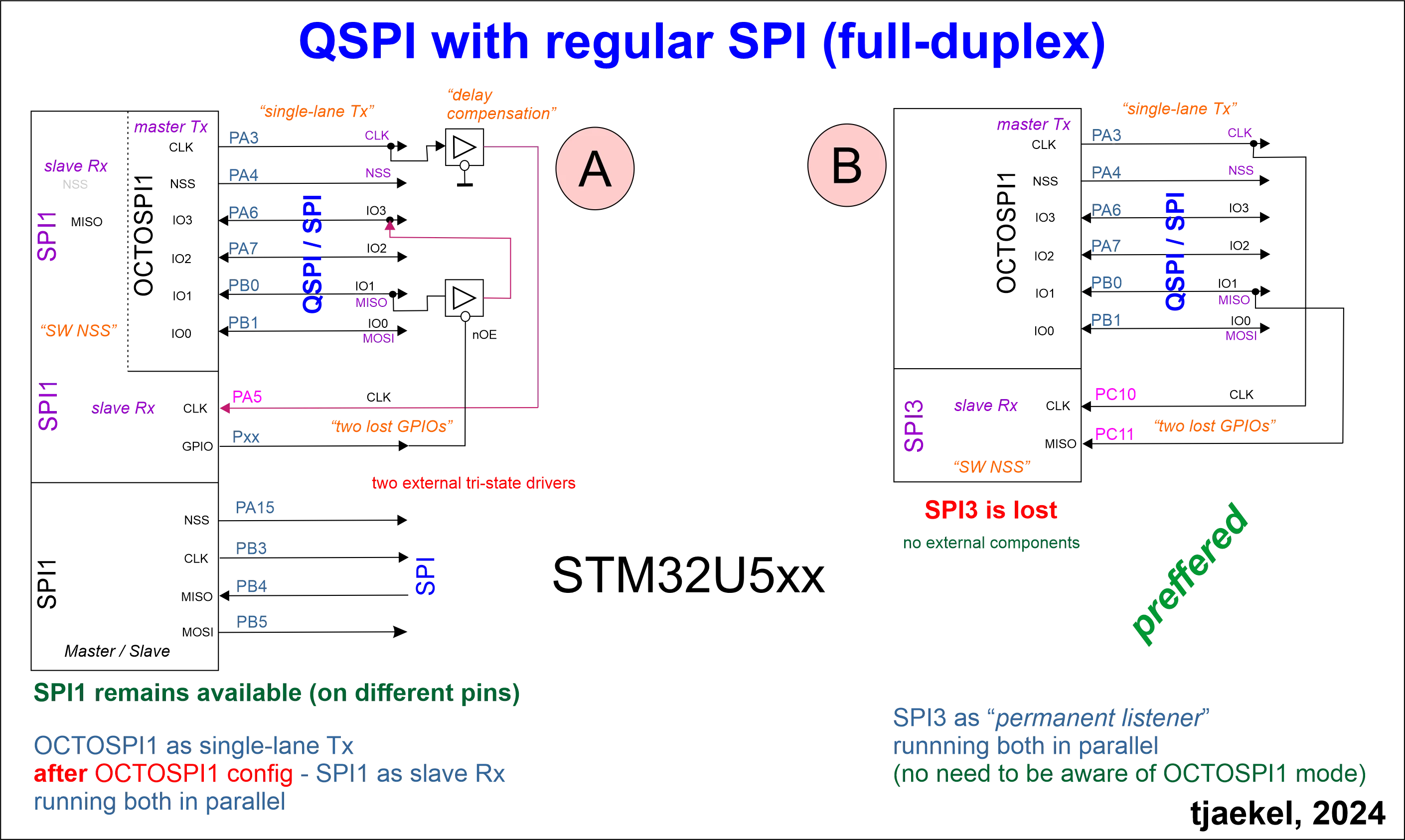

===== Here the trick how to solve with external PCB routing =========
I need SPI vs. QSPI on the same pins (no need to change an external adapter, an external chip wiring...).
Options:
  • have an external signal multiplexer and connect a SPI to the QSPI pins (cost effective)
  • have traces (wires) connecting also a SPI, e.g. SPI1 on OCTALSPI1, pins - but use both in an exclusive way (acceptable options)
  • Use the OCTALSPI as a SPI Master (it will send only), but connect another regular SPI as a slave: the OCTALSPI master provides MOSI, the SPI slave, connected on DIO1, provides the MISO.
    Just:
    Due to fact that OCTALSPI cannot generate just a DATA phase (without INSTR) - you have to send one byte as INSTR (but the SW/FW could handle that as sending the first data byte via the _IR register)
So,
to have a shared QSPI with a regular SPI without to rewire pins - works only with some external "tricks" (components or wiring).

Due to "fact" that OCTOSPI is always a half-duplex device (even in single-SPI mode, better to call it "single-lane-SPI" - it is not a "regular full-duplex SPI" - here two HW options.
Intention: the OCTOSPI (used as QuadSPI) should reuse the same pins and signals to work also as a regular (full-duplex) SPI. So, I want to have:
  • IO0 = MOSI
  • IO1 = MISO
  • in full-duplex mode (Tx and Rx at same time)
Solution:
  • use OCTOSPI as single-SPI (single-lane) Master Tx (it sends MOSI, but does not receive MISO)
  • connect SCK and IO1 as MISO to another "regular" SPI (e.g. SPI1 or SPI3)
  • run the "regular" SPI (SPI1 vs. SPI3) in Slave Mode - this is the Slave Rx, for MISO, using the same SCK
  • SPI slave without NSS HW signal: use SW NSS mode (enable slave Rx via SW)
You lose two GPIO pins. Depending on the option - you lose entire SPI3 (option B).
With option A - the SPI1 remains available as a full regular SPI - just on different pins (with a different ALT setting).
Option A needs external components (tri-state drivers) and also some SW constraints:
  • configure OTCOSPI for single-SPI mode first
  • this should turn the direction of the OCTOSPI driven signals, IO3 and esp. IO1 (becoming input - works correctly)
  • now you can enable the tri-state driver and "map" the IO1 (which is MISO) to IO3 (which is SPI1 MISO signal)
  • Be aware of in which mode OCTOSPI is in order to avoid a pin driver conflict.
Option B is easier, does not need external active components and is free of conflicts (SPI3 is always "listener", input). You just lose SPI3 as a regular SPI device.
Run OCTOSPI as master Tx and SPI as slave Rx in parallel (e.g. in INT mode or DMA mode, at least one device).
I go with option B.
  • IO0 = MOSI
  • IO1 = MISO
Solution:
I go with option B.
