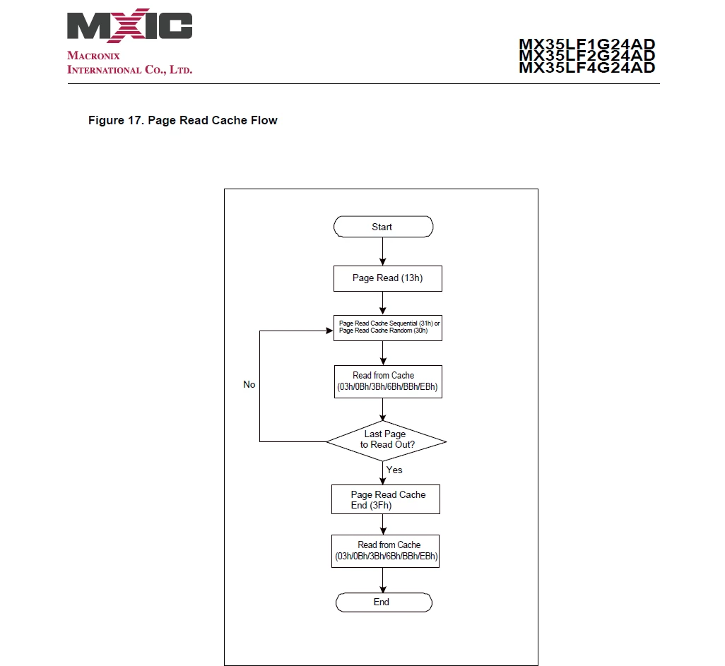

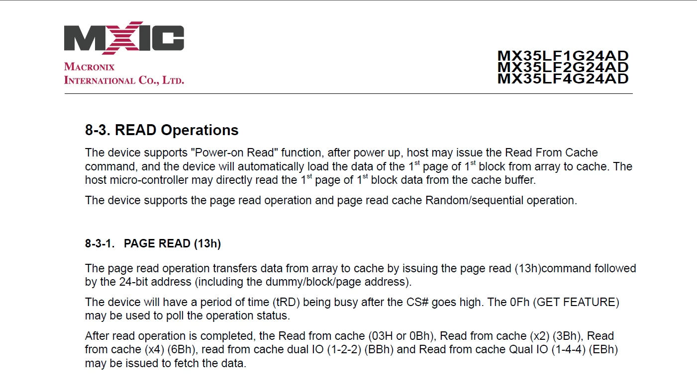

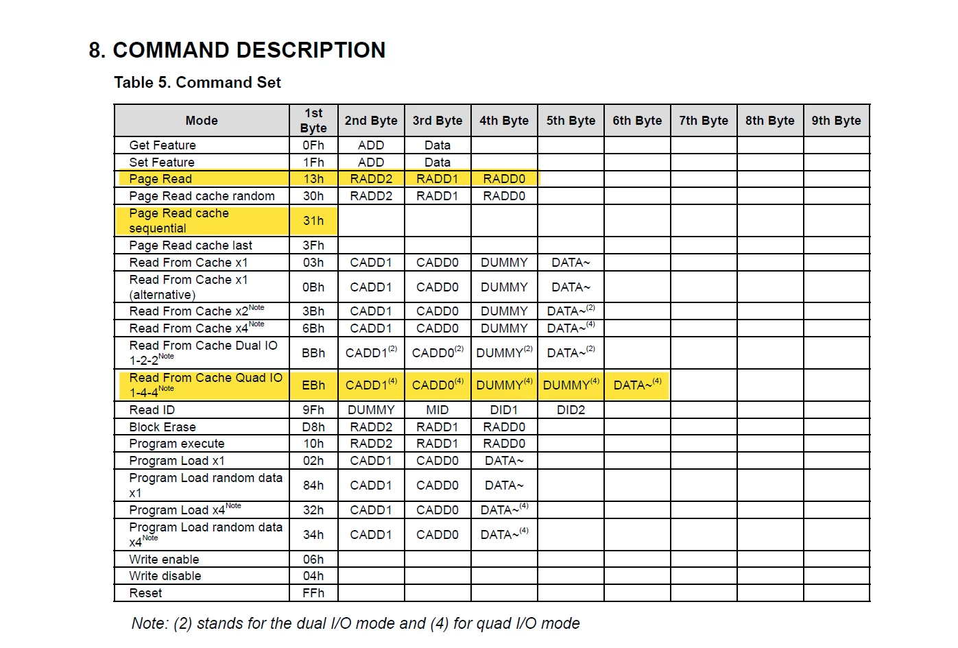

May 27, 2025 11:44 AM UTC
Hello @KDJEM.1,
Thank you for your reply, welcome and provided link to FAQ.
I did not mentioned it but I am already able to communicate with the NAND Flash, write data into it and read its content. The complex part is to correctly implement external flash memory mapping because each time that data needs to be retrieved from it, a "Page read" command needs to be sent before actually fetching its content (like shown in "Page Read Cache Flow" diagram and documentation pictures bellow).
How to enable memory mapped and map the entire flash in this situation?
Thank you.

Jun 27, 2025 1:09 PM UTC
NAND is not suitable for XIP
Memory mapping just uses a command template, substituting the address from the Bus. If there's a command using a full 32-bit address, that will work, but it's not going to support commands requiring multiple interactions.
