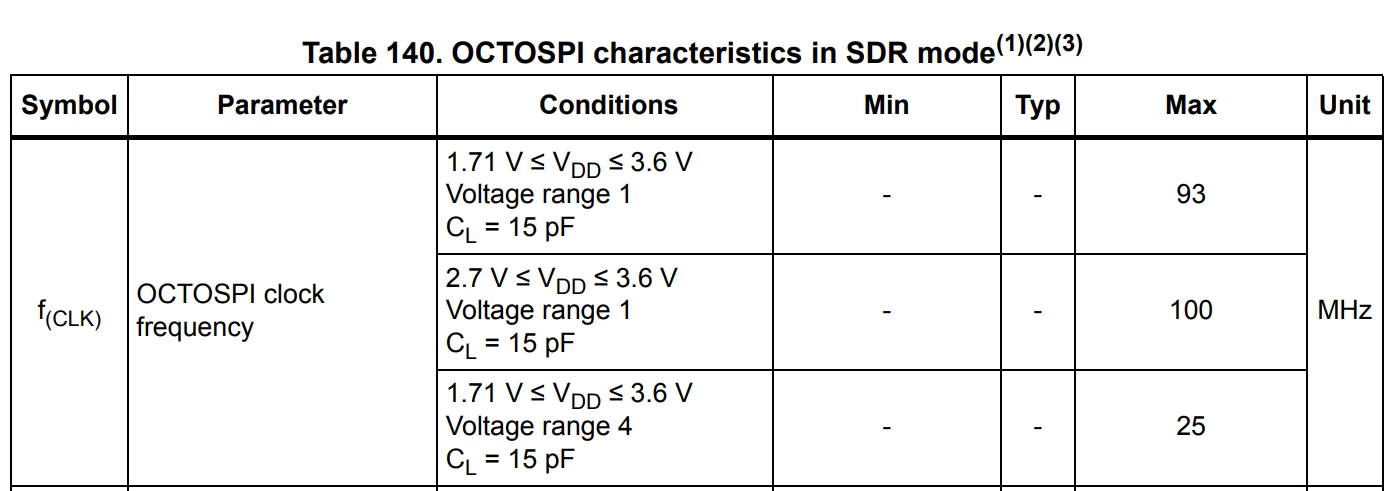

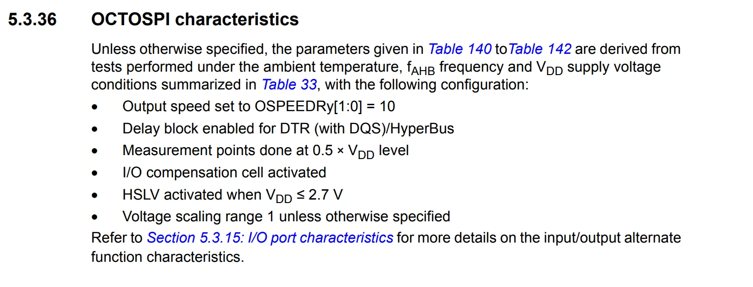

Are respecting the conditions mentioned in the datasheet:
