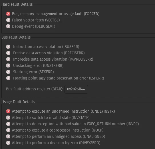

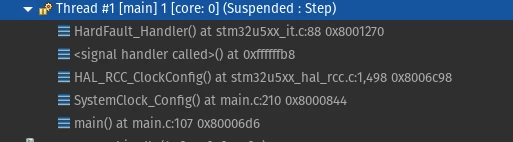

Here's a backtrace:
a HAL_GetTick() is called after modifying RCC->CFGR1
moylandoAuthor
May 12, 2025 6:15 PM UTC
And here's some fault analyzer output:

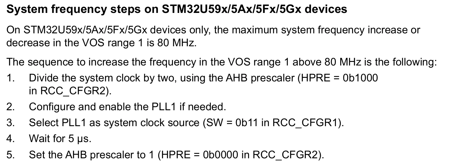

This section from page 411 of the ref manual has me curious:
The wording here is a bit unclear.  When it says 'system frequency' are we talking about SYSCLK or AHB?  Seeing as they recommend using the AHB prescaler I would think that's what they're referring to.  However, in my case, fixing it to /2 which brings the AHB within this range (SYSCLK=128, AHB=64) doesn't seem to make a difference.  Could this limitation apply to SYSCLK?  I've verified the VOS range is 1 (CubeIDE sets this depending on the initial SYSCLK configuration)
