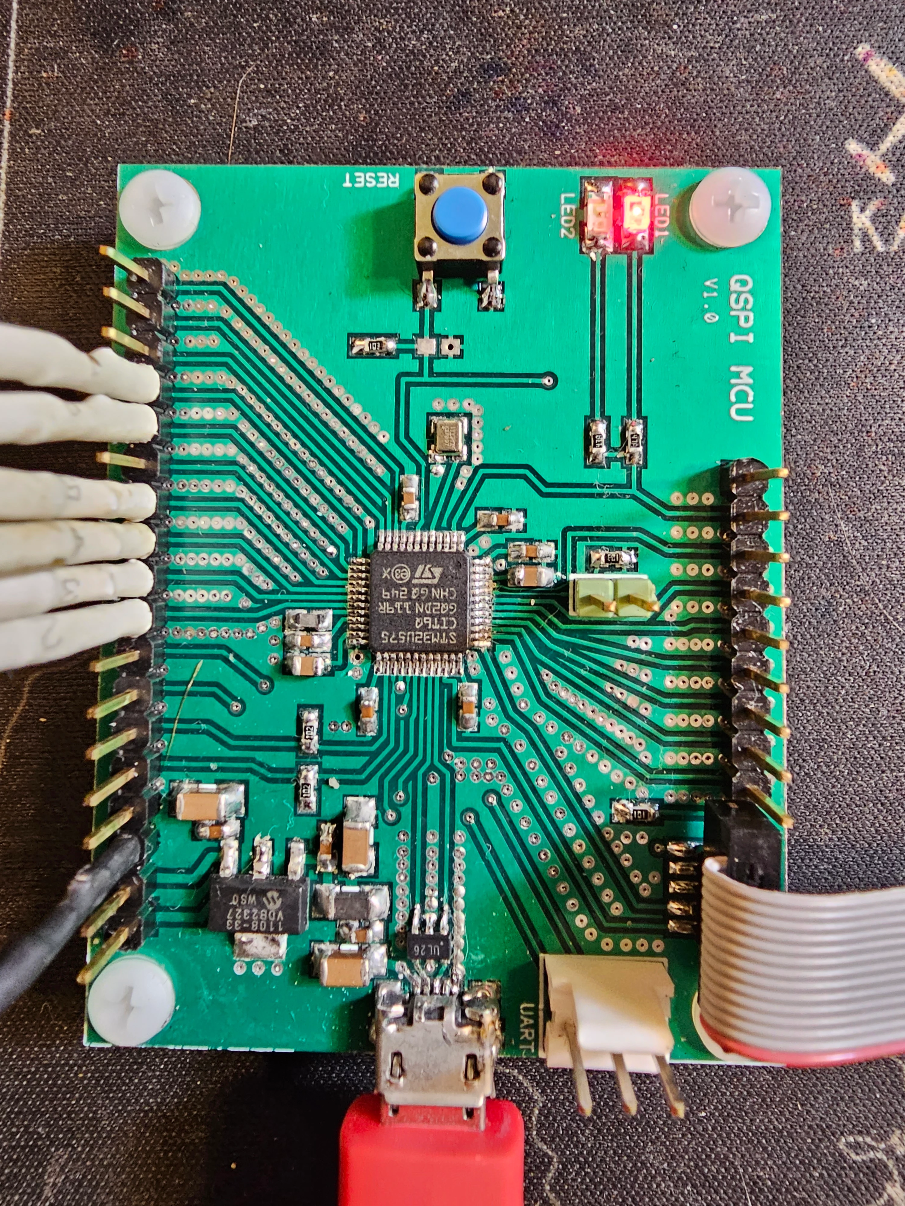

I have my own little board: with STM32U575CIT6Q (LQFP48 package). The USB is very simple and just DM (PA11) and DP (PA12) are connected. No USB-C, no USB-C Power Detector neither external chips for USB-C (as on NUCLEO-Board for USB-C-power).
I want to bring-up a simple USB VCP (CDC) UART, in FS mode. But all the code (generated by CubeMX) and example codes in CubeMX drivers/demo/application download does not work:
a) I do NOT want to use USB-C stuff, assuming "UCPD", e.g. MX_UCPD1_Init(); means "USB-C Power Detection"! There is not anay USB-C power detection, unit etc.
b) biggest problem: when code enters call: CHECK_CAD_FUNCTION_CALL in file "usbpd_pdm_core.c" - my external debugger (ST-Link2 via SWD pins (PA13 = SWDIO, PA14 = SWCLK) is disconnected (debugger in GUI is lost).
This function CHECK_CAD_FUNCTION_CALL comes from a pre-compiled LIB "USBPDCORE_NOPD_CM33_wc32.a" - what is it doing?
==> how to create a simple USB FS VCP UART with STM32U575 chip? (w/o any USB-C stuff)

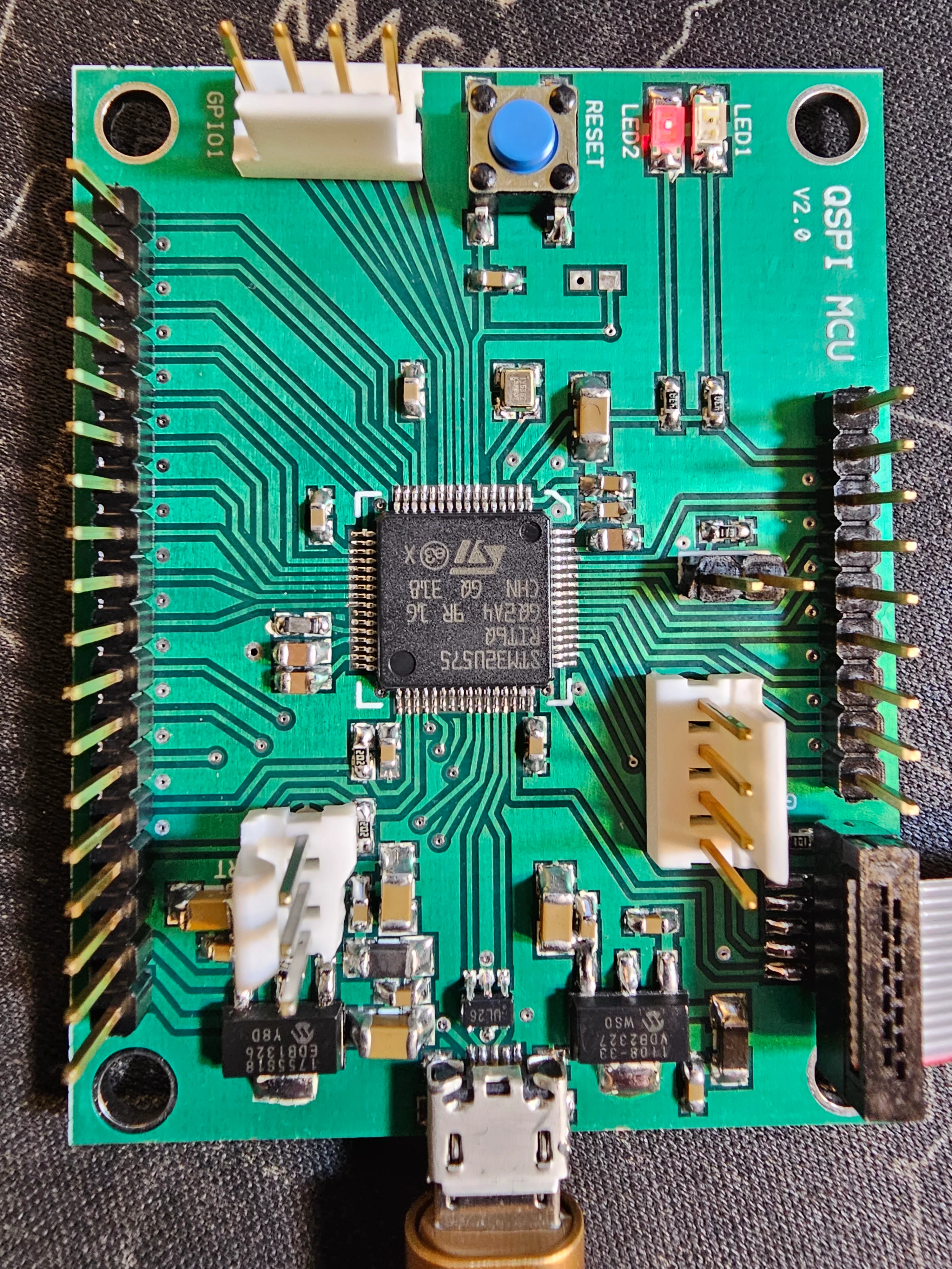

I have one PCB now working (details below).
On chips with VDDIO2 (my LQFP64 package does not have) - some GPIOs can be driven with 1.8V (even MCU is on 3.3V), but not all. Pretty cool feature (I like it),
Unfortunately, not the QSPI signals are on VDDIO2.
So, I had to run entire MCU with 1.8V in order to get all my needed GPIO signals as 1.8V logic (e.g. also I2C, some GPIOs).
Never mind.
1.8V VDD:
One board is now working!
The change I did:
there is a (deblocking) cap on VDDSMPS: it was 1 microF or 0.1 microF before - NOT 10 microF. Changing it to 10 microF (and cap is very close to pin) - seems to be the root cause.
I had also an external pull-up on nRST (as 10K) - now as DNI (because I saw: nRST has an internal pull-up already, but I guess this was not the cause).
I can confirm as:
If VDD drops below 1.796V (with external PSU) - USB does not work anymore.
Ext. OSC still OK, SMPS seems to be OK, even with lower voltage (both are still oscillating). But MCU does not come up on USB with VDD "too low" (even still in spec. range).
No idea what happened: the same external LDOs ICs I tried before (for fix 1.8V) show me now 1.801V - and it works.
I got impression: when VDD is too low, the board draws more current and the voltage on VDD drops (I have used the current limiter on external PSU).
Never mind: works now entire MCU as 1.8V (on one board).

After I have studied several repositories and projects - I went with my USB VCP working on another board
(Portenta H7, based on a STM32H7xx). Was a bit easier (and the same USB FS stack works).
It was easier to "merge" the old Middlewares/ST/STM32_USB_Device_Library into my new project.
-- IT WORKS --
Great,
now I have USB VCP working on my own PCB, with a STM32U575CIT6Q chip.
And I have my QSPI tester working (I need QSPI as interface for external chips). It works.
Here my board:
Just strange:
It works only if I configure UART1, I have to do (otherwise USB does not work, even not using UART1 yet):
#if 1
/* XXXX: why is it necessary to get UART VCP working??? */
MX_USART1_UART_Init();
#endif
