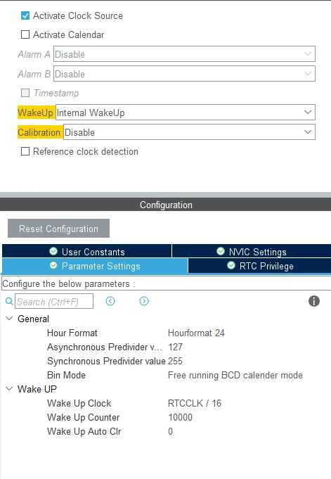

I am using an stm32U545RE_Q and want to put my device into standby mode and then periodically wake it up (every 10s). but it doesn't work
Am I missing something or how am I supposed to continue from here?

Hello @dlagyals;

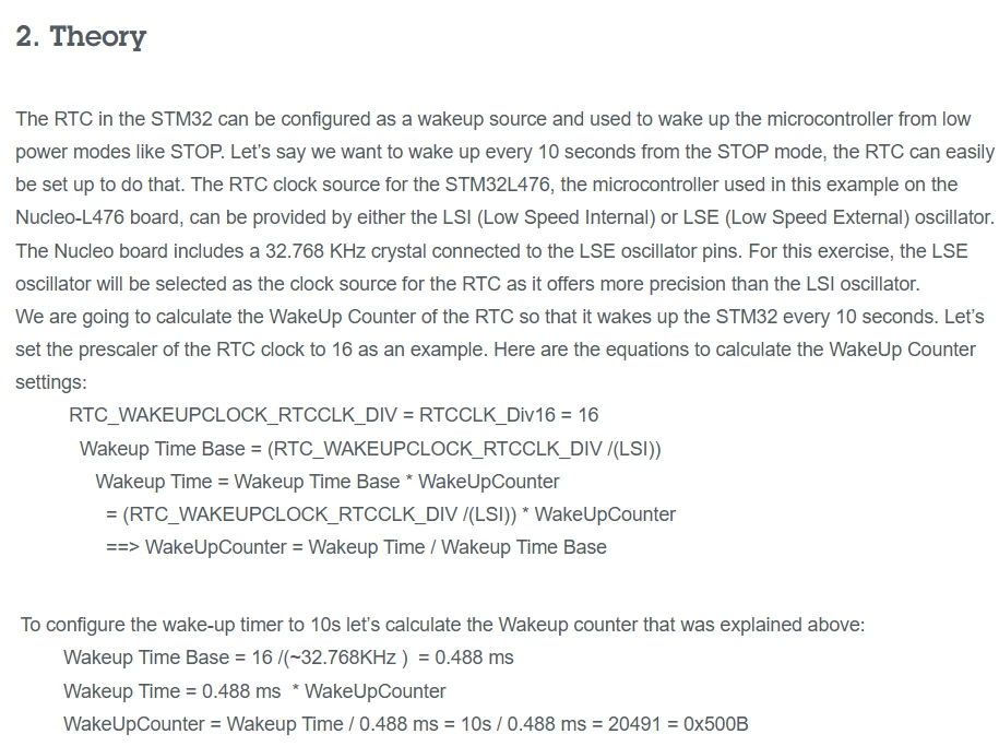

Please use </> button to share your code. See this post.
For the RTC issue, First of all I recommend you to look at this FAQ and check how to calculate WakeUpCounter.
Second, I advise you to get inspired from an available example to check your code like as RTC_LowPower_STANDBY_WUT.
This example describes how to periodically enter and wake up from STANDBY mode thanks to the RTC Wake-Up Timer (WUT).
Thank you.
