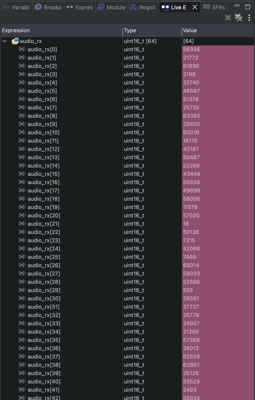

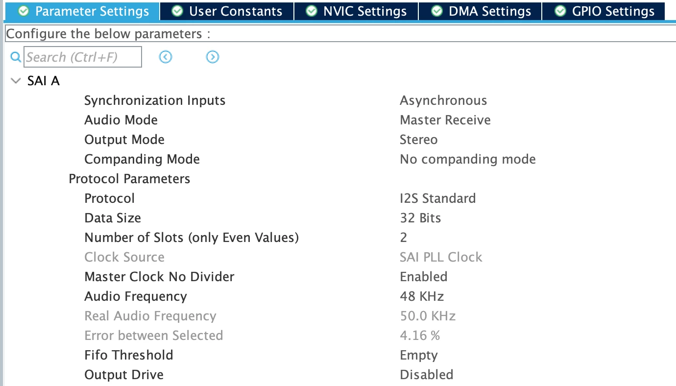

I'm attempting to set up SAI receiver in I2S mode, with 32-bit 48kHz sampling. See my configuration of SAI A below:

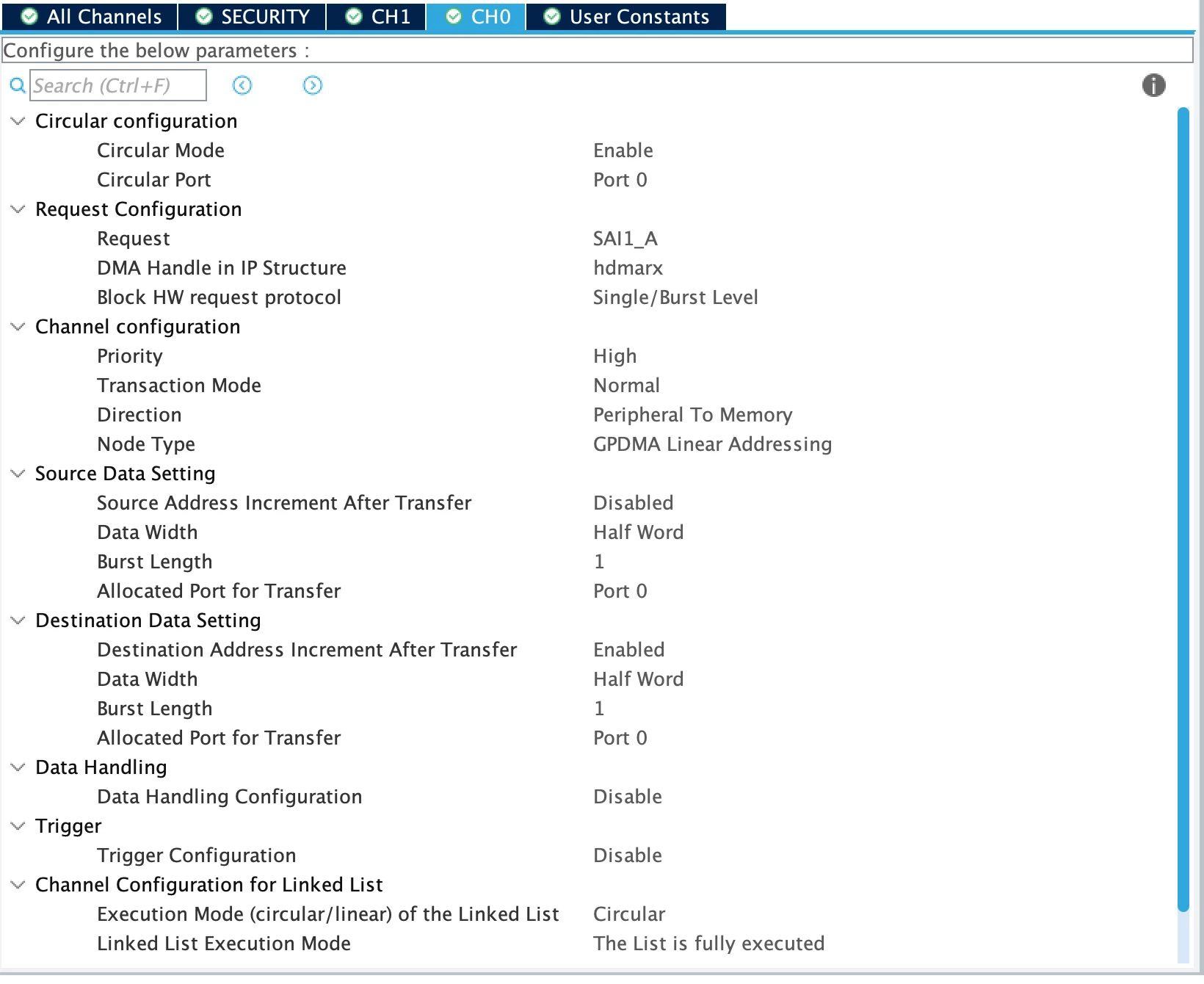

I also want to receive the data continuously in circular mode via DMA (or GPDMA in the case of this MCU).
Reading other sources, I've concluded that the following setup should be established:

When my hardware has no audio source connected to it, I would assume that the audio data stored via DMA in the audio_rx buffer should be equal to 0 (and maybe some weak noise).
However, my buffer is filled with what appears to be 16-bit garbage values:
Why is this? I've successfully implemented this code on my old build, which used a STM32G4.

You are lucky, your SAI and your ADC are working correctly.
Now your 32bit buffer shows perfect noise values around 0, with about 100 dB SNR, the least 15 to 16 bits noisy only.
Check the 2's complement data format: https://en.wikipedia.org/wiki/Two%27s_complement
Your ADC ist just noisy around 0, example for 2's complement:
8 bit 2'sc:
1111 1111 = -1 !
0000 0000 = 0
0111 1111 = +127
1000 000 = -127
When working with audio formats, you should have heard about that. ;)
If not, now you know... :D
So it was mostly a 16 / 32 bit problem.

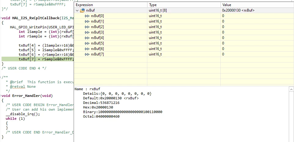

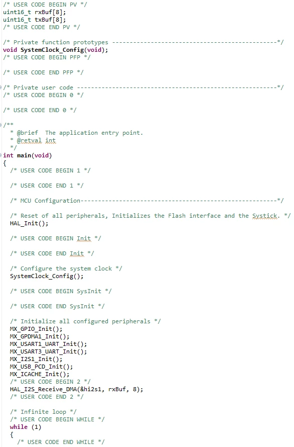

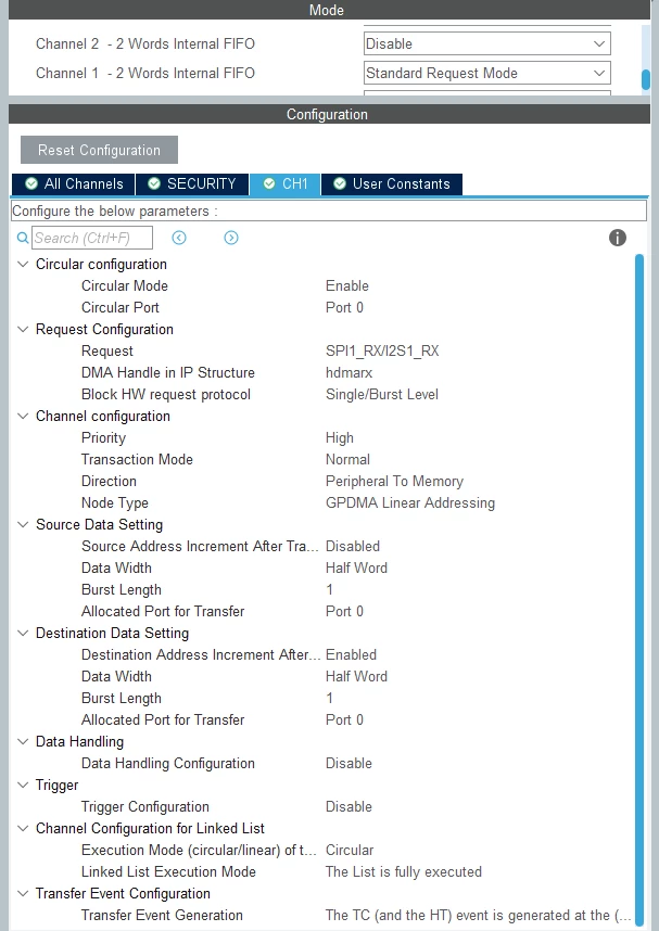

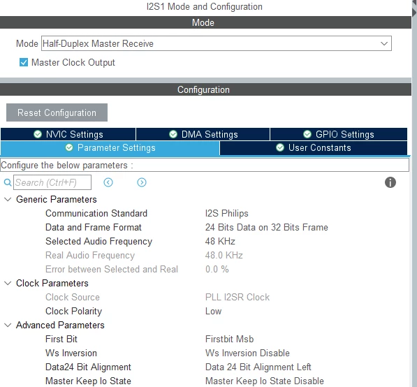

Hello, I have a similar problem with my nucleo H503RB. I'm trying to make it work with Pmod I2S2 module (ADC+DAC). For now I've connected only ADC via I2S1. This is my HW configuration:
I2S config:
GPDMA config:
Code:
Output:
As you can see, I have no data in the buffer. I've checked clocks and data line with scope and it's okay here. The DMA interrupt also fires. So what can I do with it?

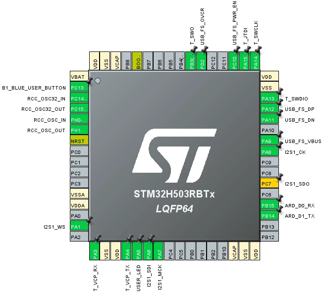

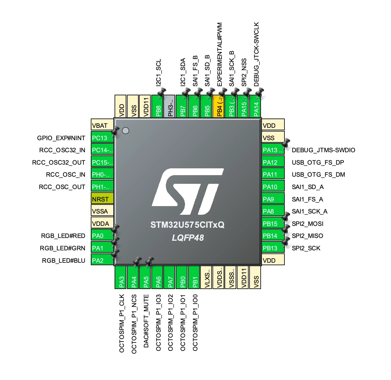

Below is the pinout on my STM32U575, if that is of any help:

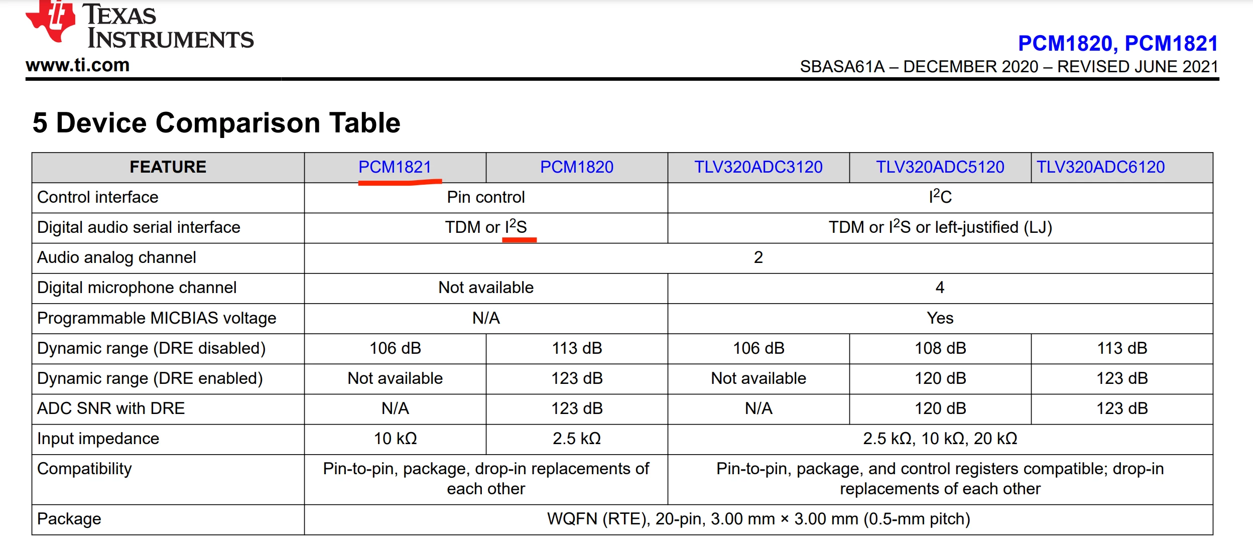

February 23, 2024
I've excluded the DAC for the time being, trying to evaluate only the ADC.
1. The GPIOs are correct according to the datasheet.

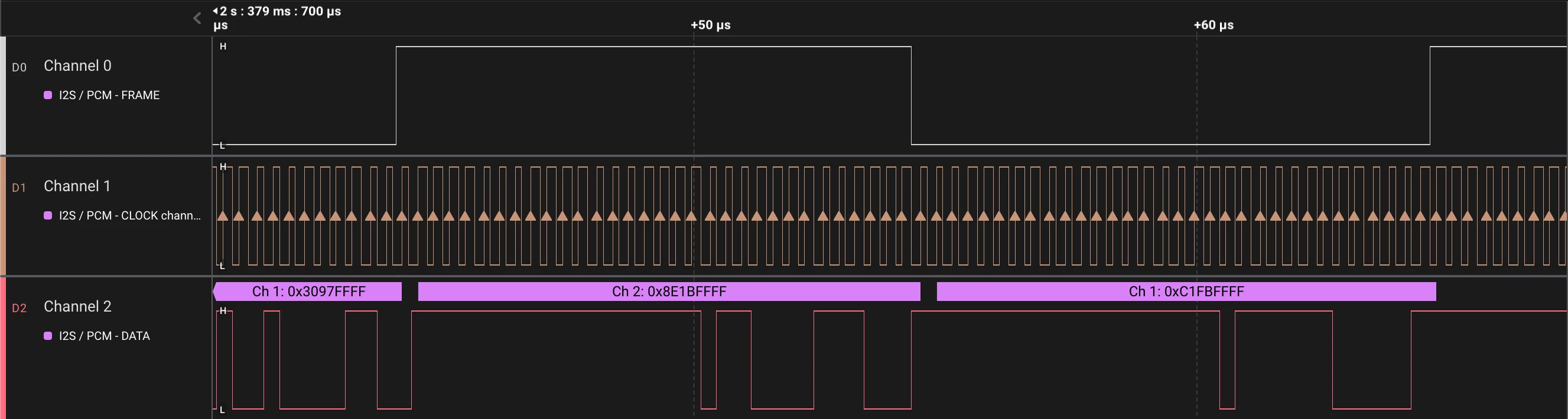

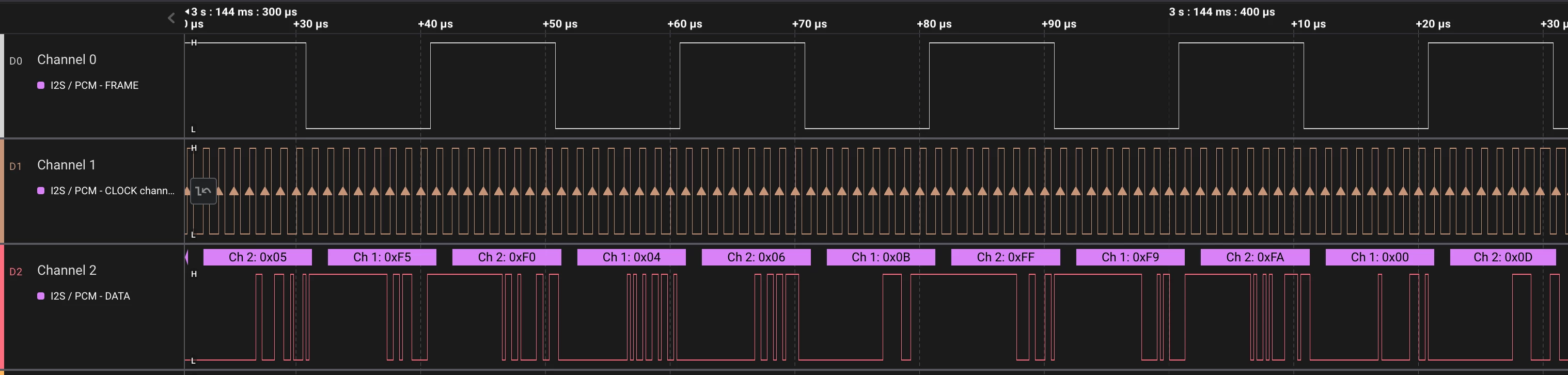

2. Here's what I'm getting on the scope. Every frame is transferred in 8 bits, which kind of makes sense when you look at the way pData is setup in this function:
HAL_StatusTypeDef HAL_SAI_Receive_DMA(SAI_HandleTypeDef *hsai, uint8_t *pData, uint16_t Size)
Could it be that I'm messing up here?

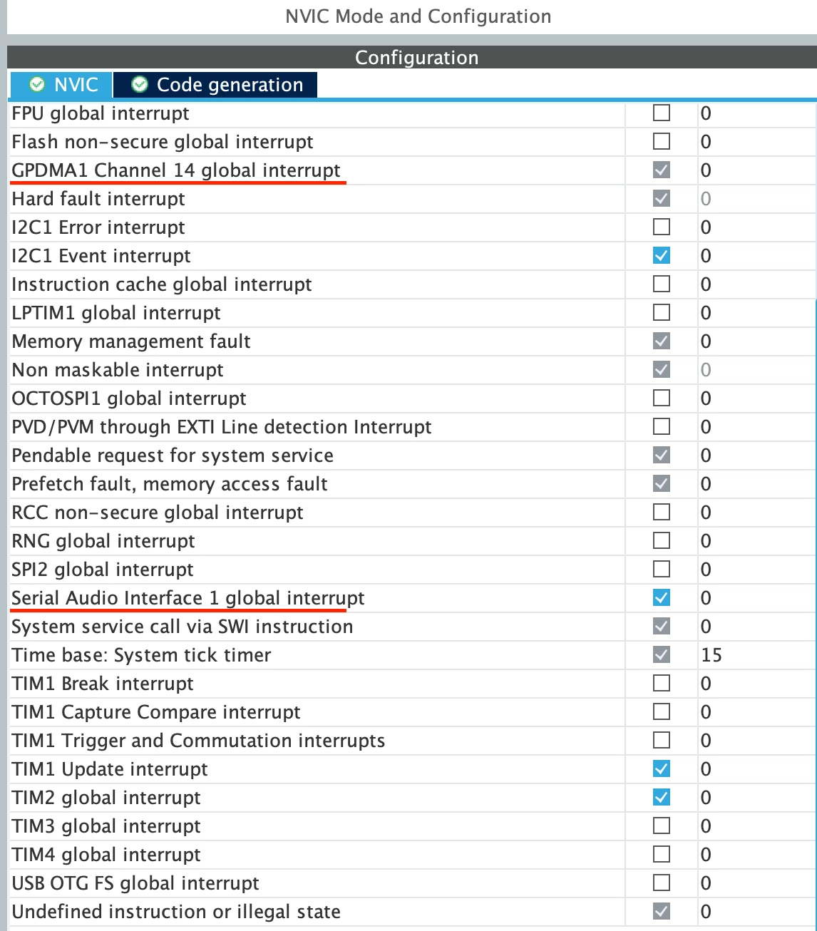

5. Here's the NVIC, where the ISRs are enabled both for the SAI1, and for the GPDMA channel it's using.

 /**SAI1_B_Block_B GPIO Configuration
 PB3 (JTDO/TRACESWO) ------> SAI1_SCK_B
 PB5 ------> SAI1_SD_B
 PB6 ------> SAI1_FS_B
 GPIO_InitStruct.Pin = GPIO_PIN_3|GPIO_PIN_5|GPIO_PIN_6;
 GPIO_InitStruct.Alternate = GPIO_AF13_SAI1;
 HAL_GPIO_Init(GPIOB, &GPIO_InitStruct);

SCLK should be 4 times higher for 2 x 32 clock cycles within 1 LRCK cycle, but you actually seem to set it up correctly with SAI_PROTOCOL_DATASIZE_32BIT.
I would read the SAI registers where all the clock settings are done. Maybe there's a HAL bug?
Are there any SAI examples from ST for that U575? I would compare DMA and SAI setup.
And check if your ADC really runs as SAI_I2S_STANDARD, not as left justified (as most audio ADCs that I have used).
February 24, 2024
Unfortunately, it seems like the Cortex-M33 is somewhat of a black sheep when it comes to documentation. If ever I find some material on GPDMA + SAI implementations, they're usually very muddy or unspecific. I will take another look around the web and let you know if I find anything useful.
I just found that the scope showed such strange readouts because the sampling frequency was too low...
Heres the full resolution scope when I increased the sampling frequency from 4MS/s to 16MS/s:
From the PCM1821 datasheet, I read that TDM or I2S should be used for this device:
It would be nice to try if TDM works, but unfortunately my hardware directly ties the FMT0 (mode select) pin to I2S.

Now things look much better on the scope!
The "noise" you see is perfectly okay for this ADC, there's nothing happening on the data line for the first 16 bit or so, so you're in the range of ~ 100 dB SNR, like the ADC is specified.
This might hint that your noisy ADC buffer data somehow shows only the noisy 16 LSB.
By the way, your DMA setup looks like WORD / 32bit, but your ADC buffers are 16 bit... so better change the ADC buffers to 32 bit, at least for testing.
LCE
Principal III
February 26, 2024
Okay, so the CubeMX pictures say that DMA is configured as half-word.
SAI is configured for 32 bits = word.
Your code snippets show for DMA:
 NodeConfig.Init.SrcDataWidth = DMA_SRC_DATAWIDTH_WORD;
 NodeConfig.Init.DestDataWidth = DMA_DEST_DATAWIDTH_WORD;
I don't know the internals of the GPDMA, but it looks strange to me.
I would really start by setting all to WORD / 23bit: SAI/I2S, buffers, DMA.
