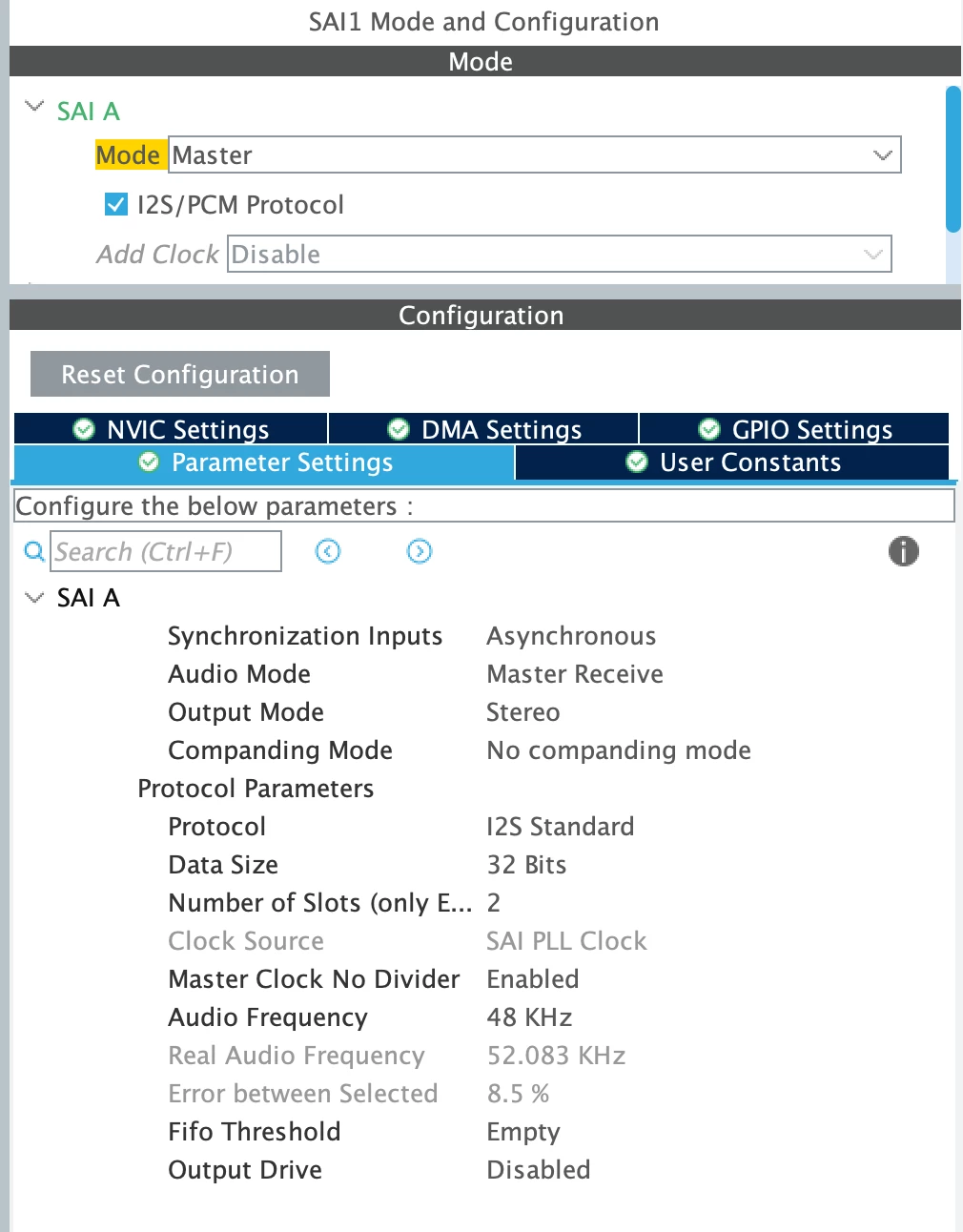

I'm attempting to set up SAI receiver in I2S mode, with 32-bit 48kHz sampling. See my configuration of SAI A below:
I also want to receive the data continuously in circular mode via DMA (or GPDMA in the case of this MCU).

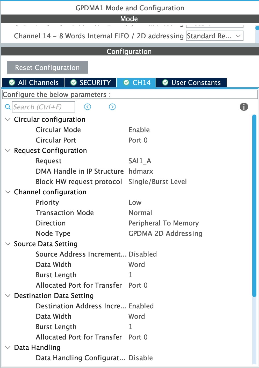

Ok, let's start by clearing out any doubts on the CubeMX side. As you stated, I see that my initial setup was wrong. Here's the corrected setup, which I've been using since a few posts back.
Here, the data width of the SAI and GPDMA are matching, which are set to "32 bits" and "word" respectively.

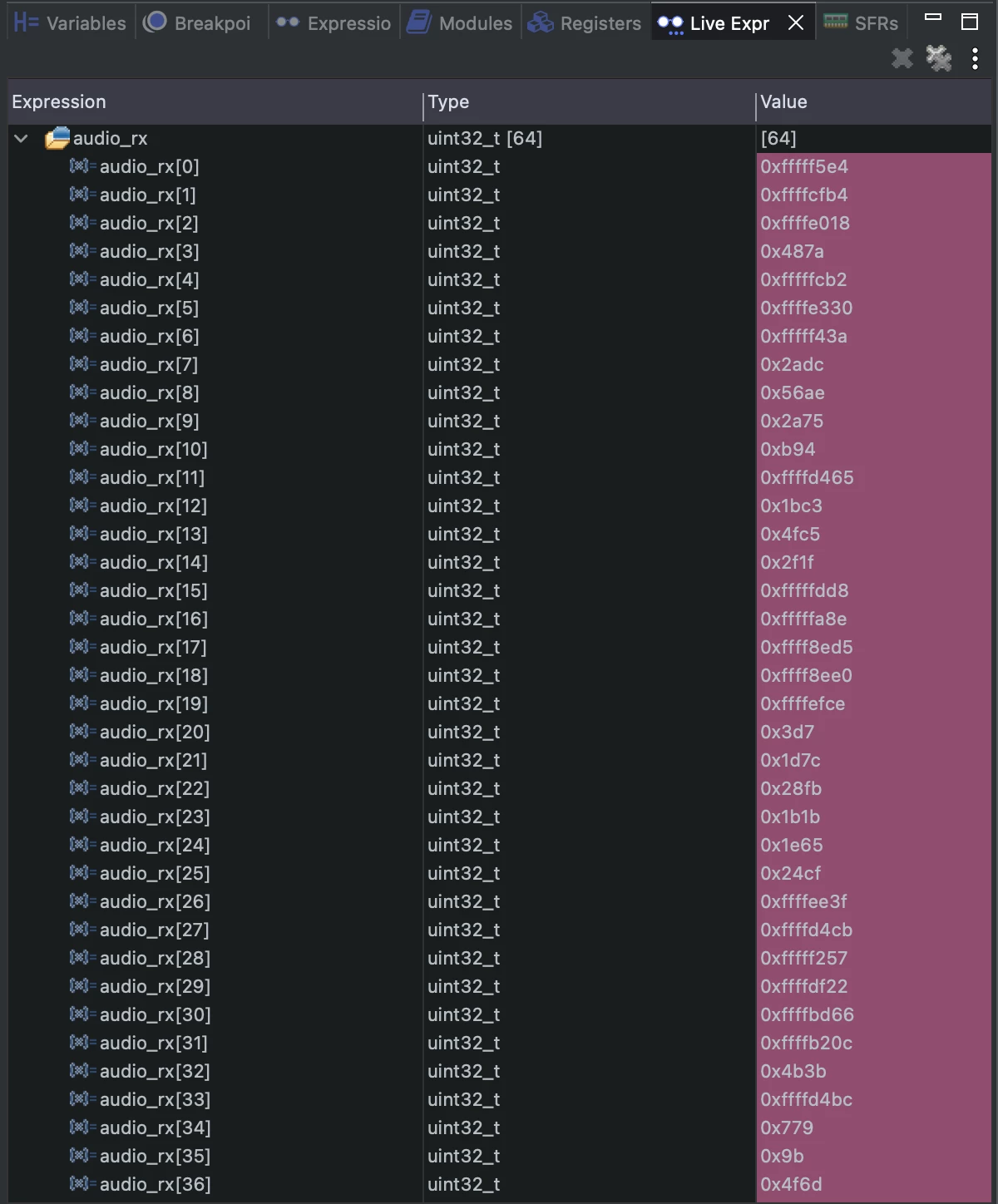

My audio buffers are also declared as uint32_t arrays, but let's just focus on the RX/ADC side of things for the time being:
uint32_t audio_rx[AUDIO_BUFFER_SIZE];
//uint32_t audio_tx[AUDIO_BUFFER_SIZE];
Here's the current readouts, which seem to indicate that the SAI is properly setup in 32-bit mode.
If I'm not mistaken, the data is transmitted MSB first, which should mean that there are some heavy "noise" spikes that seem way off in terms of amplitude (I mean, 0xFFFFxxxx can hardly be acceptable?).
The RX buffer is still filling with these noisy values. Here's another picture to show the reoccurrence of the large values:
Thank you so much for your continued patience and support, it's very much appreciated.
Senior II
February 27, 2024
I think those large values are just "slightly negative" values, right? For example array index 15 is 0xffff fdd8 which is -552. So all those values you have in the buffer are some noise around 0.

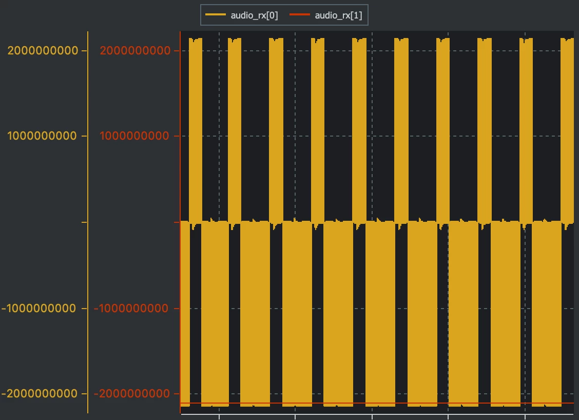

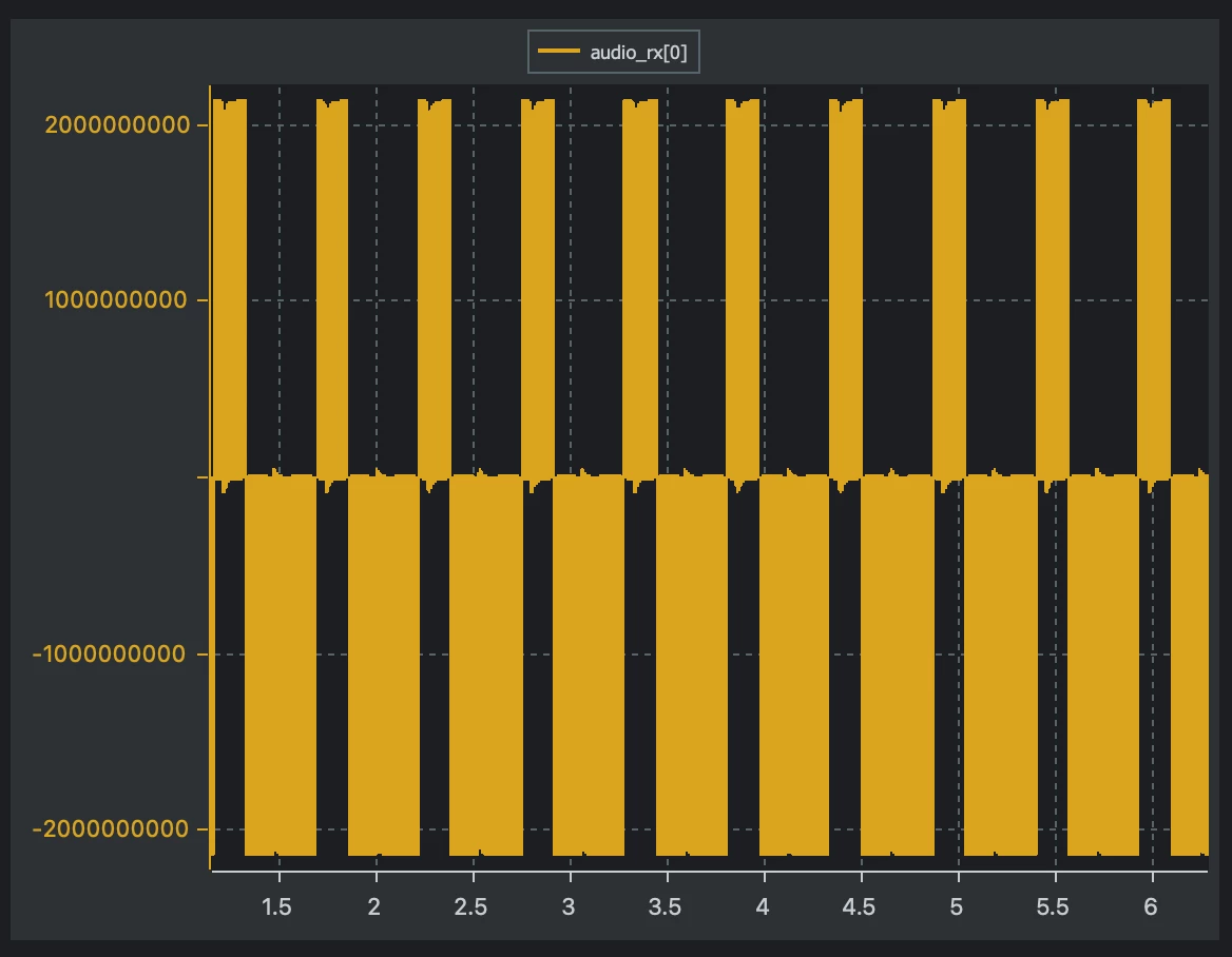

February 28, 2024
Sweet Jesus, you guys are absolutely right!!! I have definitely heard of and used two complements before, but I had no clue it was used this way in audio codecs. It must be very standard, since the ADC datasheet doesn't care to mention 2's complement even once. But I won't blame them for my ignorance :face_with_tears_of_joy:
Anyways: Intuitively, all I should do is store the received data in an int32_t buffer, instead of a uint32_t buffer.

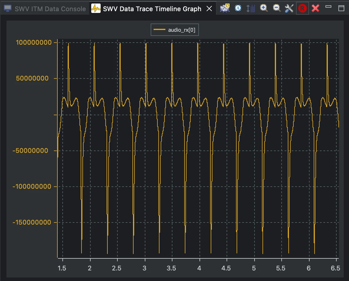

I tried this, and I'm actually getting some neat waveforms in the SWV view now! So we're one step closer, but something is still off - the input waveform is a ~2Hz triangle wave (confirmed with scope), but the image below presents a garbled non-triangular wave. I'm assuming there's some more steps I need to take when I acquire the RX data, like rearranging some bits, or something?
Here's a picture of channel 0 (left):
Channel 1 (right) is also working btw :)
Please let me know if you know of some standard procedure, or have examples on how to receive the ADC data properly.
Once again, deeply grateful for all the help. Could not have done this without your efforts! :folded_hands:

There should be no bit shifting or whatever needed. I think 2's complement is the format in gcc for signed integers.
Are you sure that this SWV shows the data correctly?
How do the buffers look? With such a slow input signal, it should be easy to check the numbers in the buffer. Calculate after how many samples there must be a minimum and maximum, then check the buffers.
Another thing: the last few audio ADCs I used did not use standard I2S format, but "MSB left justified" or so, which is almost the same (I think except for the first bit).
I know we already talked about that, but I'd check again. Could be an ADC setting.

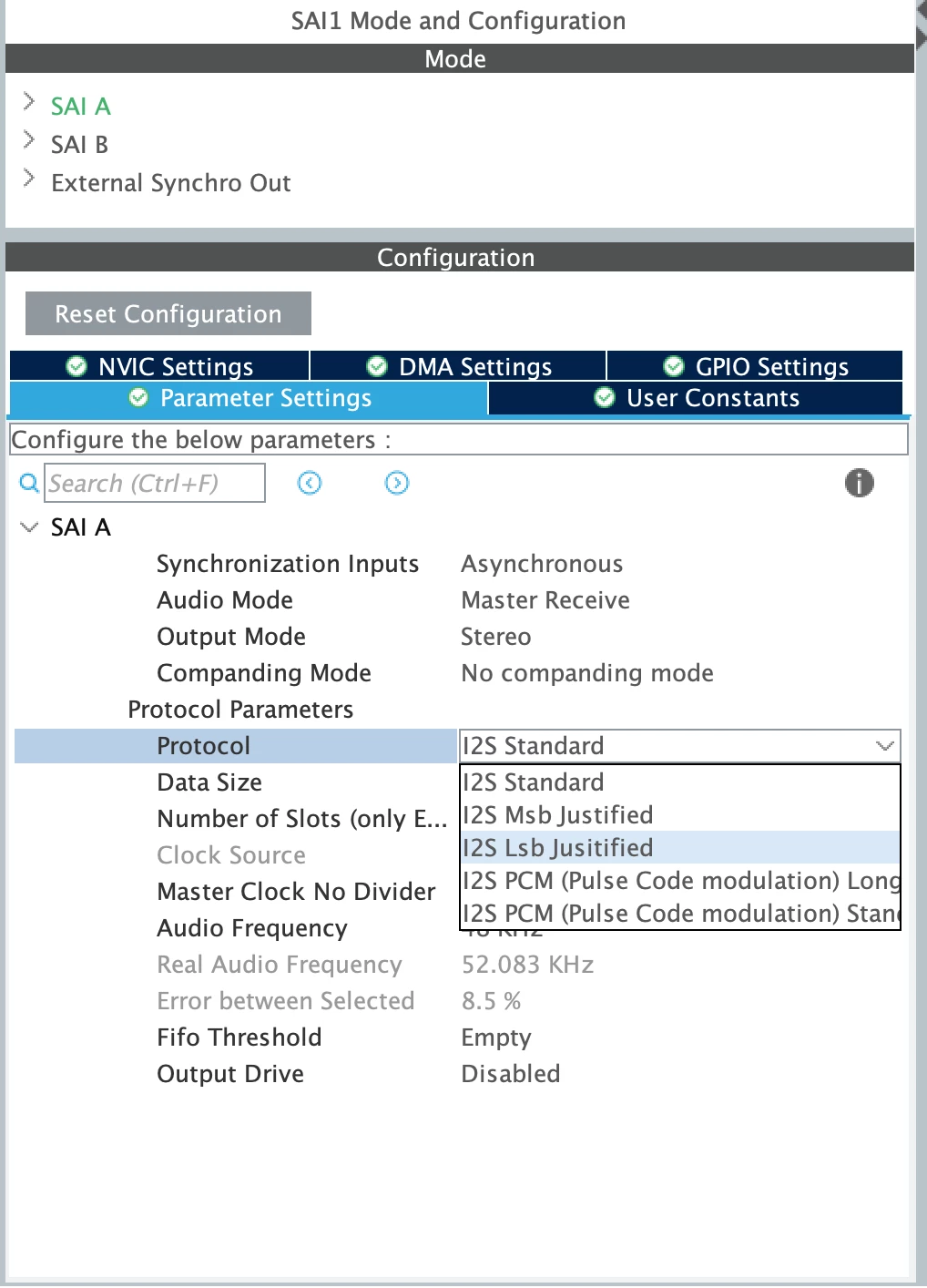

February 28, 2024
Here's the SWV in "I2S MSB Justified" mode (can't find left-justified in CubeMX?). Doesn't look quite right compared to the waveform in my last post:
Tried in "I2S LSB Justified" mode as well, for good measure:
So I'm assuming that the above is a dead end, and the data sheet is correct in specifying that I2S Standard mode is the way to go.
Here are all the available I2S modes for the SAI, in case you have more suggestions:

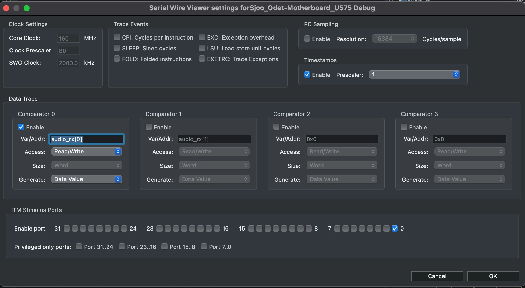

Below is also the SWV setup, where I print the first element of the array. Values in the RX buffer audio_rx also look OK.
LCE
Principal III
February 29, 2024
I have no idea about SWV.
Does it know that data is interleaved in the buffer?
DMA fills the buffer LRLRLRLR... Left / Right channel from stereo ADC.
