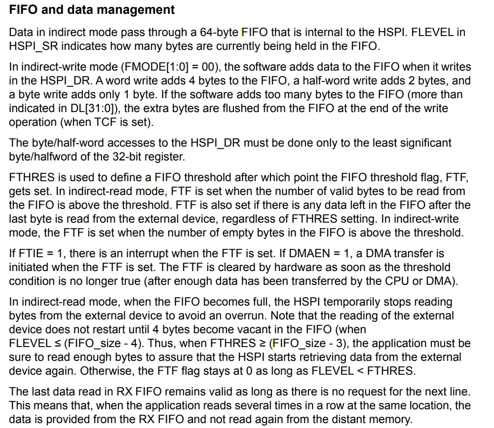

About the FIFO in indirect-write mode, data written to the HSPI_DR register is stored on the FIFO before it is sent to the external device during the data phase. If the FIFO is too full, a write operation is stalled until the FIFO has enough space to accept the amount of data being written.
In indirect-read mode, reading HSPI_DR register gives (via the FIFO) the data that was received from the external device.
If the FIFO does not have as many bytes as requested by the read operation and if BUSY = 1, the read operation is stalled until enough data is present or until the transfer is complete, whichever happens first.
For more information about the FIFO characterization please take a look at RM0456 section FIFO and data management and to this FAQ.

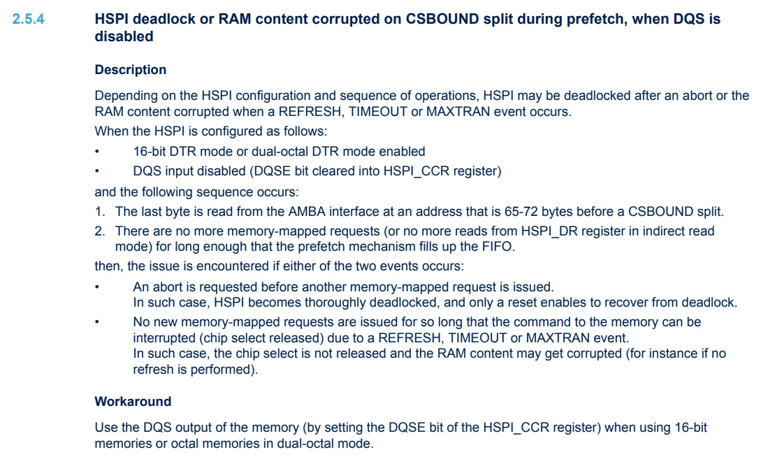

Could you please check the status DQSE bit of the HSPI_CCR register?

Enabling the DQSM pin took care of the unexpected bytes in the fifo.  I thought I had it enabled, but an incorrectly filled field in the XSPI_HyperbusCmdTypeDef structure that would have been caught if I had "Enable Full Assert" checked in CubeMX caused the issue.  Thanks for that tip.
Now I am seeing 3 pulses of the DQSM signal after the latency time.  This suggests 6 bytes are being read.  I am only requesting 2 bytes and am only seeing two bytes read into the fifo.  Any comment on this?

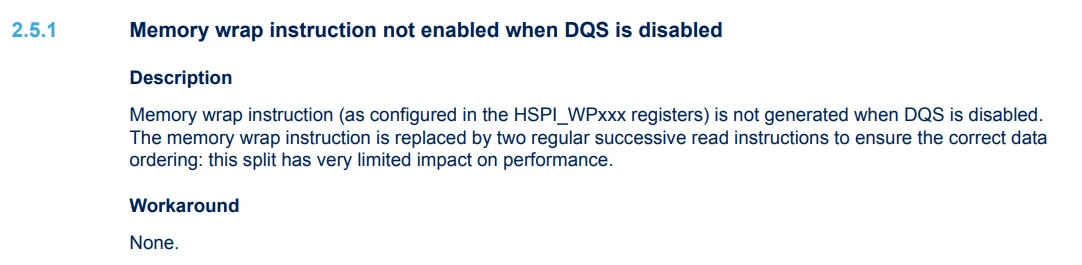

Could you please take a look at these erratas.
Are you in this case?
