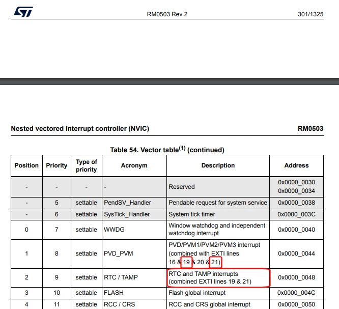

Hello together,
I'm a little bit confused by the NVIC and EXTI description in the RM0503.
The NVIC vector table says the RTC / TAMP interrupts are combined EXTI lines 19 & 21 (on page 302).

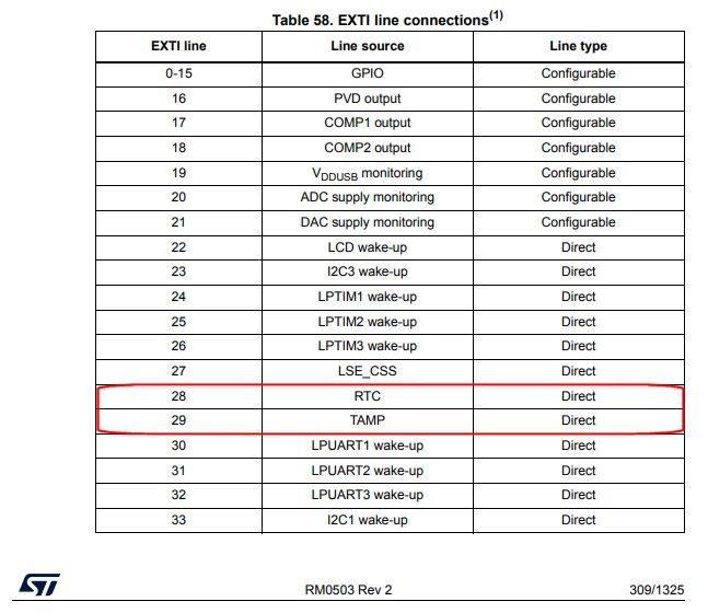

But when looking at the EXTI line connections table (on page 309) the RTC source is on line 28 and TAMP on line 29.

This is already reported here with other issues: Missing section IRTIM in STM32U0 RM and more.

Hello @christian-enderle
Thank you so much for reporting this typo. I will escalate it for correction on the comming releases of the doc.
@AA1 i will be back and take a deep look to your comments and escalate all typos. Thank you so much for your contribution.
