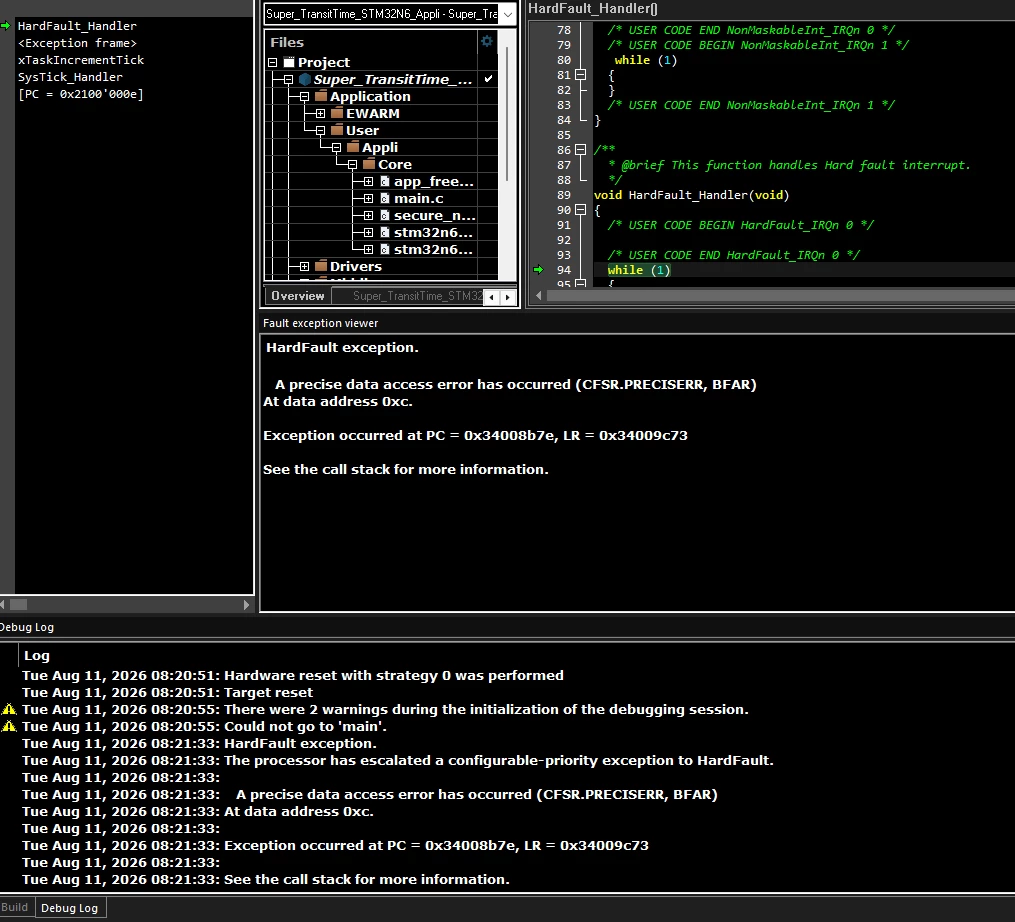

I am attempting to setup a new Hello World project on the STM32N6 using the following:
  1.  FreeRTOS running two tasks, a timer, and a semaphore
  2. A couple of hardware timers
  3. A USART
  4. The PSSI doing 16 bit bi-directional transfers
  5. The BSP package
Running the debugger I get
followed by a Hard Fault:
The code is running on a Nucleo-N657XO-Q development board.  My development tools are:
  1.  STMCube 6.18.1
  2. STM32Cube_FW_N6_V1.4.0
  3. IAR 9.60.4
Something not correctly setup or a bad board?

You’d be better asking IAR for support with their IDE, and what to do about that particular IAR message.
Did you try Tools > Options, as it suggests ?

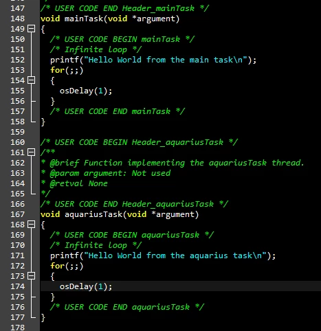

I have been doing the code construction in stages, prior to adding the timers, both soft and hard, the following code worked:
Perhaps this is indication of a memory access issue?

I assume ​@Andrew Neil is pointing to this interesting article How to debug a HardFault on an Arm® Cortex®-M STM32 | Community
From the information provided, this does not look like a toolchain issue. I would recommend to comment out all printf() calls first to narrow down the issue stack / lib c / UART problem vs RTOS / peripheral / memory issue
BFAR 0xC usually means NULL pointer + offset.
The value of PC just before the exception has occurred shown in the debug window (can be found in the stack (Exception frame) points to the faulty instruction.
