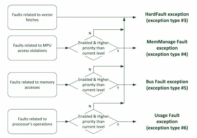

3. Types of HardFault
In fact, the HardFault exception could be raised because of an escalated fault other than a HardFault, which is not enabled. Below are the exceptions that can be escalated to HardFault. We take the Cortex®-M4 based MCUs as an example and this list can be extended for the Cortex®-M33 based MCUs.
3.1 MemManage fault
An exception that occurs because of a memory protection related fault. The fixed memory protection constraints determine this fault, for both instruction and data memory transactions. This fault is always used to abort instruction accesses to Execute Never (XN) memory regions.
3.2 Bus fault
An exception that occurs because of a memory related fault for an instruction or data memory transaction. This might be from an error detected on a bus in the memory system.
3.3 Usage fault
An exception that occurs because of a fault related to instruction execution.
The fault exception other than the HardFault can be enabled by writing to the System Handler Control and State Register (SCB->SHCSR) in their enable bitfields (USGFAULTENA, BUSFAULTENA, MEMFAULTENA) as shown below:

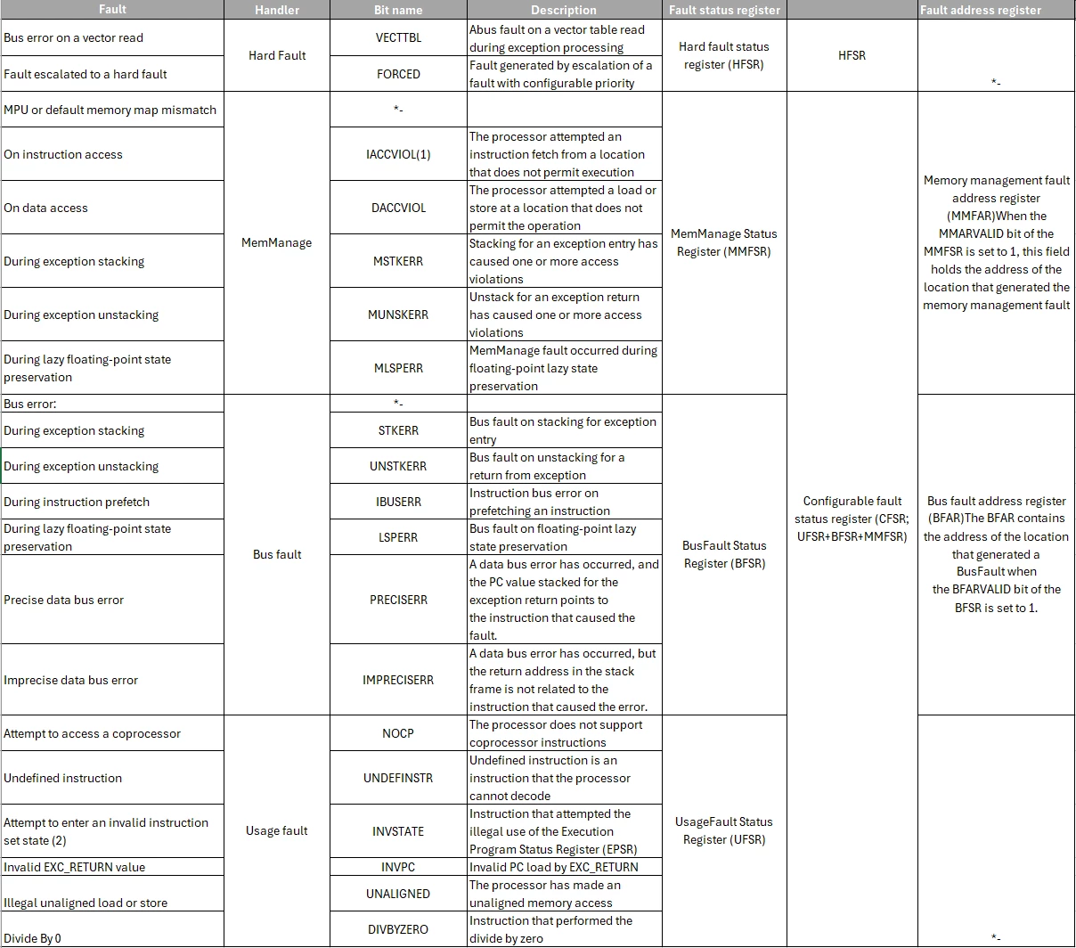

5. Configurable fault status register
The CFSR indicates the cause of a MemManage fault, BusFault, or UsageFault and can be further divided into three registers. Besides accessing CFSR as a 32-bit word, each part of the CFSR can be accessed using byte and half-word transfers. There is no CMSIS-Core symbol for the divided MMSR, BFSR, and UFSR.
This table shows the types of fault, the handler used for the fault, the corresponding fault status register, and the register bit that indicates that the fault has occurred. See the configurable fault status register (CFSR; UFSR+BFSR+MMFSR) on page 237 and HFSR on page 241 of the programming manual PM0214 for more information.

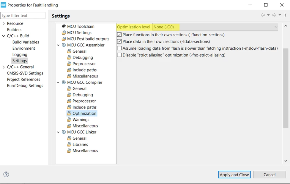

Note: For better debuggability optimization, the level must be set to 0 or 1. To make sure we are visualizing the correct behavior of the CPU, we are setting the optimization level to 0:

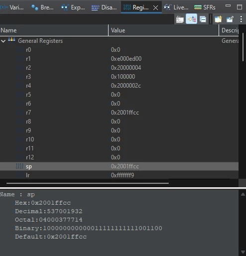

7. Halting and determining the core register state
In order to analyze the HardFault we need to halt the execution and get the value of core registers.
Below is an example on how we can do this:

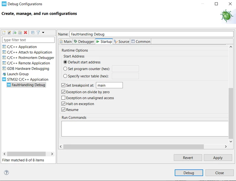

Alternatively, we can set the option halt in exception in CubeIDE in the debug configuration:
Now, we can visualize the content of core registers and get the stack pointer value:

- Extract the value of the stack pointer (SP) from CPU registers
- Copy the address SP and paste it in the memory view
- You should read the content as follows:

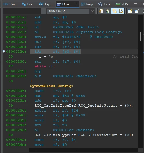

5. Copy the PC content and paste it in the disassembly viewer and see the instruction that causes the HardFault

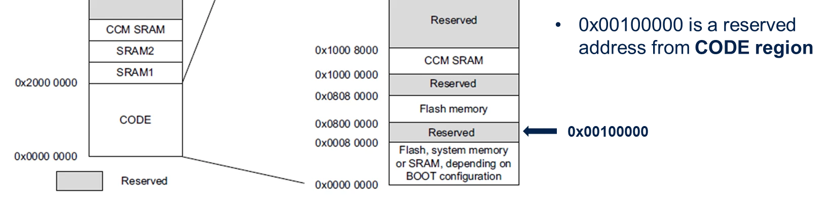

9. Examples
In this section we go through 3 different examples of an access to a reserved address: 0x00100000:
- Trigger a BusFault (if enabled) or HardFault by reading from a reserved address
- Trigger a BusFault (if enabled) or HardFault by writing to a reserved address
- Trigger a BusFault (if enabled) or HardFault by executing at a reserved address
To run each Test, you must uncomment the corresponding define.

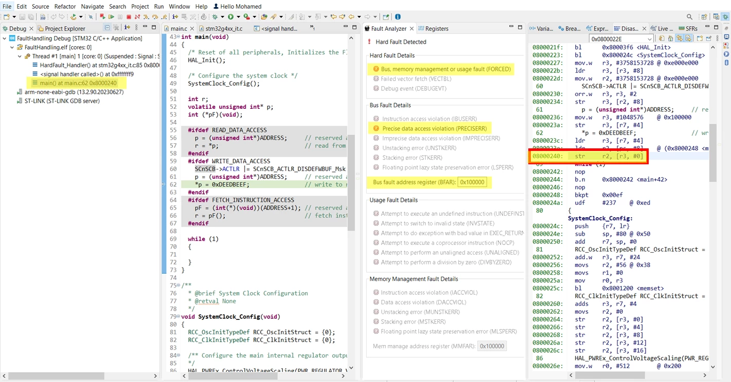

9.1 Read data access
9.2. Observations

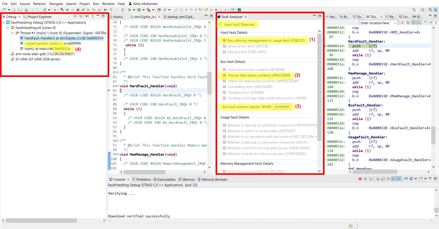

When running the Project, a HardFault is triggered

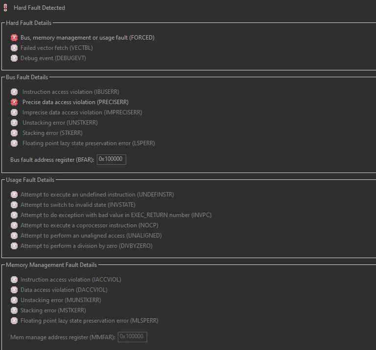

The first step to do is to check the Fault Analyzer and Debug windows.
We can find very useful information related to the fault.
(1): HardFault has been caused by escalation of another exception which is BusFault.
(2) (3): The BusFault is caused by Precise data access to the address: 0x100000
(4): PC = 0x0800022E the value of PC just before the exception has occurred (the address of the instruction that causes the fault).

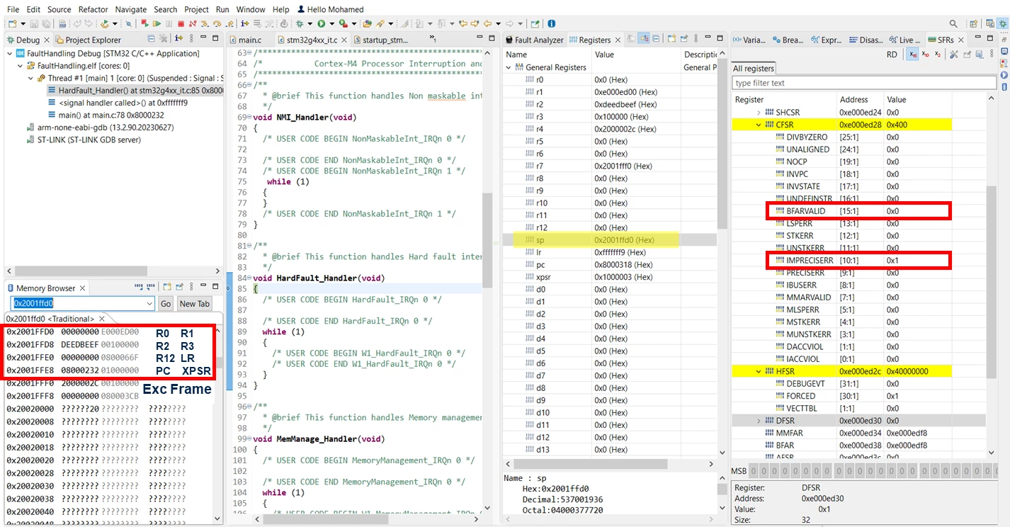

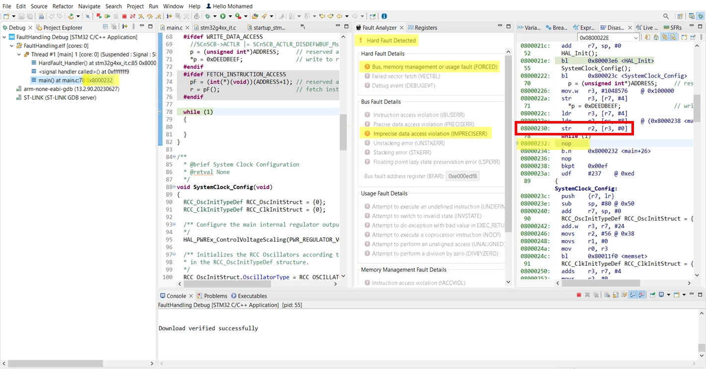

9.3 Write data access
When running the Project, a HardFault is triggered due to a BusFault escalation
BusFault caused this time by imprecise data access(No address is specified in BFSR)
The value of PC just before the exception has occurred PC= 0x08000232
This is not the address of the faulting write, which is 0x08000230
Note: BusFault is raised some instructions after the write instruction
IMPRECISERR = 1
Imprecise data access violation. Return address not related to fault
BFARVALID = 0
BFAR not valid
The reason for a bus fault to become imprecise is due to the presence of write buffers in the processor bus interface
Debugging imprecise bus faults is a bit harder than precise bus faults because by the time the bus fault exception is triggered, the processor could have executed several instructions, including branch instructions.
If the branch target can be reached via several paths, it could be hard to tell where the faulting memory access took place
To help with debugging such situations, you can disable the write buffer using the DISDEFWBUF bit in the Auxiliary Control register
To disable the write buffer, uncomment Line 40
After disabling the write buffer, the fault becomes precise.
BFARVALID = 1 BFAR is valid (contains the address of the location that generated a BusFault).
The value of PC just before the exception has occurred shown in the debug window (can be found in the stack (Exception frame) now points to the faulty instruction.
Note:
To facilitate the debug of imprecise fault, we can change the memory type of a region that contains the reserved address to Strongly Ordered using the MPU (memory protection unit) instead of disabling the write buffer.

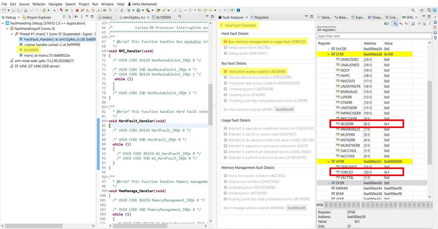

Fetch instruction Access
FORCED = 1
BusFault escalated to HardFault.
IBUSERR = 1
BusFault on instruction prefetch.
The address of the location that generated a BusFault is: PC = 00100000 not in BFAR (unlike the precise data error)
The BusFault is immediately triggered on execution at an invalid address
