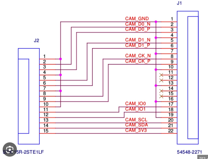

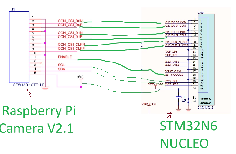

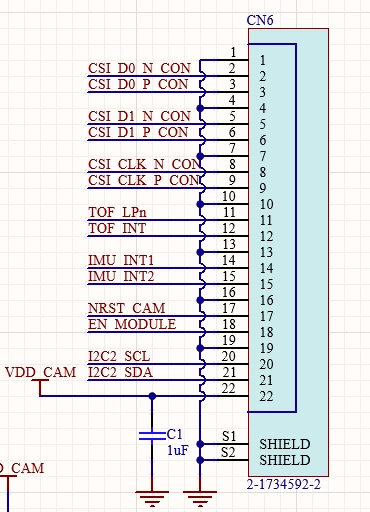

Hi @Linas L  Can you please help me understand how you connected Raspberry Pi Camera Module 2 NoIR to STM32N6 eval board, as Raspberry Pi Camera Module 2 NoIR has 15pin but STM32N6 board has 22pin
Linas L
Linas LAuthor
Senior
October 3, 2025
Simple.
Pi5 has special cable for this. You can buy it in mouser/digikey. Since just like pi zero, pi5 use same 0.5mm pitch connector on pcb
October 3, 2025
Wow nice! Thanks Linas for sharing this.
can you please share Digiky/Mouser link that I can buy ?
In this cable, the VCC from pin# 15  has been mapped to pin#22 ,right?
