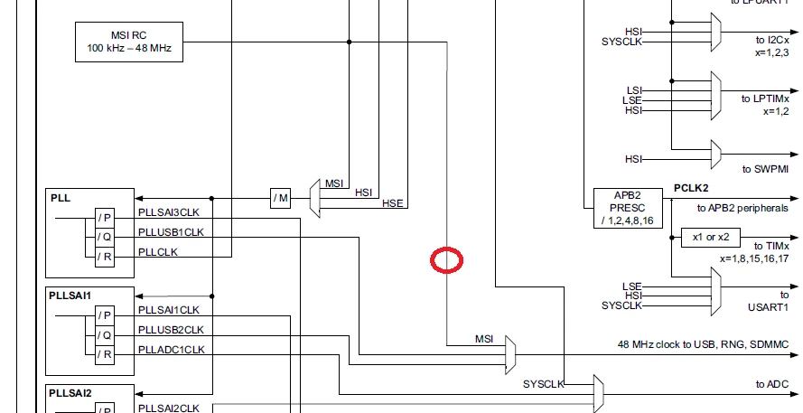

    Doesn't seem to be an output capable MCO tap on the clock tree for the 48MHZ. I might be missing it though. I could output PLL R with the same settings I suppose.

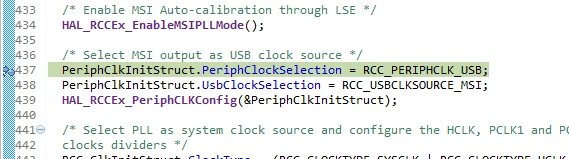

    Then they just motor onward through this
    /* Select MSI output as USB clock source */
    PeriphClkInitStruct.
    PeriphClockSelection
    = RCC_PERIPHCLK_USB;
    UsbClockSelection
    = RCC_USBCLKSOURCE_MSI;
    HAL_RCCEx_PeriphCLKConfig
    (&PeriphClkInitStruct);

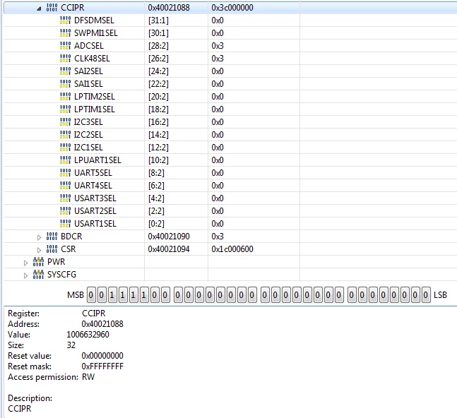

    [EDIT2] you have RCC_CCIPR.CLK48SEL set to 0b11, don't you
    I seem to find it being READ and CHECKED, but just DEFINED here

    RE-READING the MSI Autocal operation and looking at the clock tree diagram seems to indicate that the MSI itself is being put into a PLL MODE. So MSI could be output from MCO if that was deemed necessary. I was initially thinking PLL since it said 'PLL'. AS in the real PLL being driven by MSI.
    But no
    They appear to mean the MSI ITSELF ACTING as a PLL.
    And so far I don't see how you control that AUTOCALING. There is SOFTWARE CALIBRATING but how that intertwines with the other mystery auto cal is -- well......A mystery.

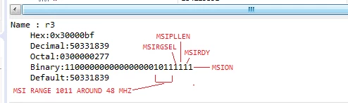

    [EDIT] PS. If you are relying on RCC_CR.MSIPLLEN  , read it back to verify if it's really on, first.
    They don't read back...... They call this
    Not they, *you* read it back.

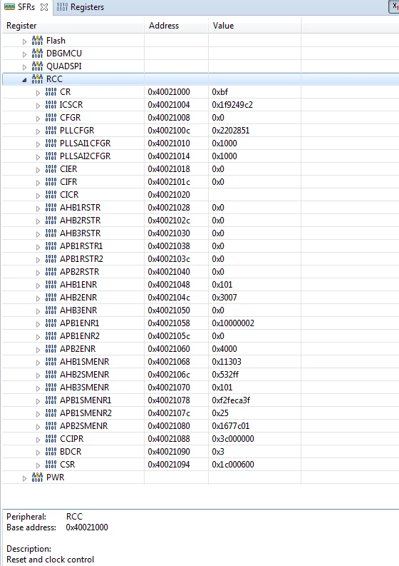

    In the debugger, read out and post the content of all RCC registers.

    shingadaddy
    Senior
    Mar 31, 2017 3:31 PM UTC
    Posted on March 31, 2017 at 17:31

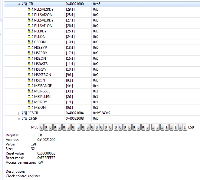

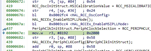

    Not stuck the LED in yet and this was QUICK by an unproficient user (me)
    Breakpoint inserted HERE just after it gets set in line 4340690X00000606gcQAA.png
    Code
    RCC_CR Register
    Thats the important one. I'll have to play more to get ''ALL'' of them on here.
    Those other 2 bits floating around on the left.... =    RCC_CCIPR.CLK48SEL   - No Wrong register I suppose..
    BUT THEY ARE IN THE RIGHT BIT SPOTS !    I'll look.
    shingadaddy
    Senior
    Mar 31, 2017 11:07 PM UTC
    Posted on April 01, 2017 at 01:07
    Better?
