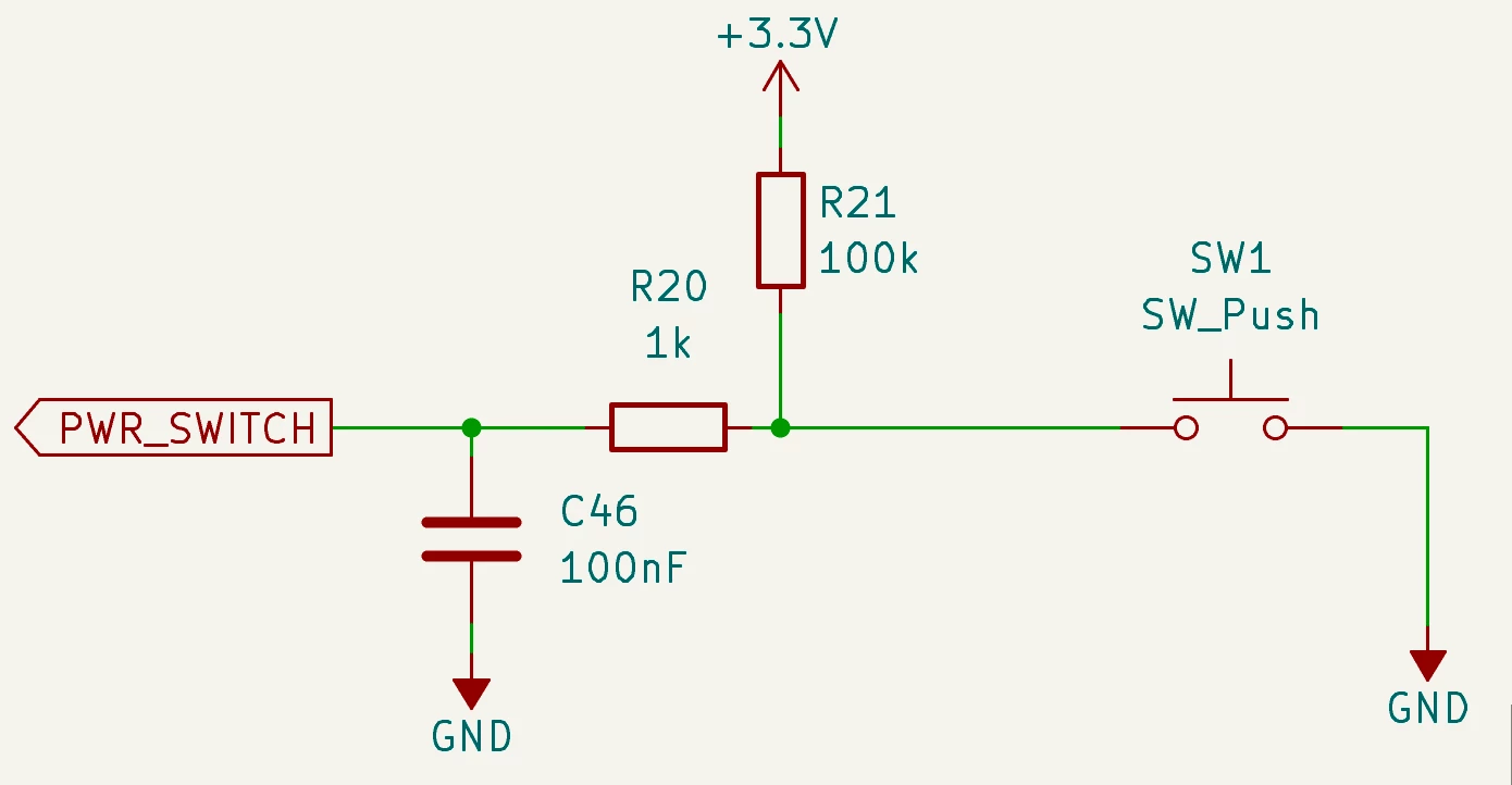

I am using the STM32L433RCT6 and need to assign a GPIO pin as an external interrupt, which will be used to wake and shutdown the MCU (shutdown must use minimal power).
However, I am not sure if I have to use a specific GPIO pin, or if I can use any GPIO pin for the external interrupt ?
The external interrput will be connected to a momentary push button (net PWR_SWITCH)...

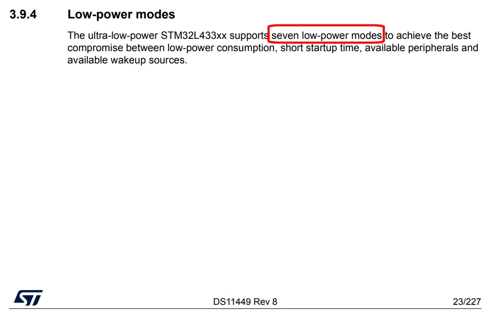

So, as the others have said, look at its datasheet to see the low power modes available - there are seven to choose from:
https://www.st.com/resource/en/datasheet/stm32l433rc.pdf#page=23
via: https://www.st.com/en/microcontrollers-microprocessors/stm32l433rc.html#documentation
The modes - including their available wake-up sources - are described in Table 4 on the following pages.
See also the Reference Manual, RM0394.

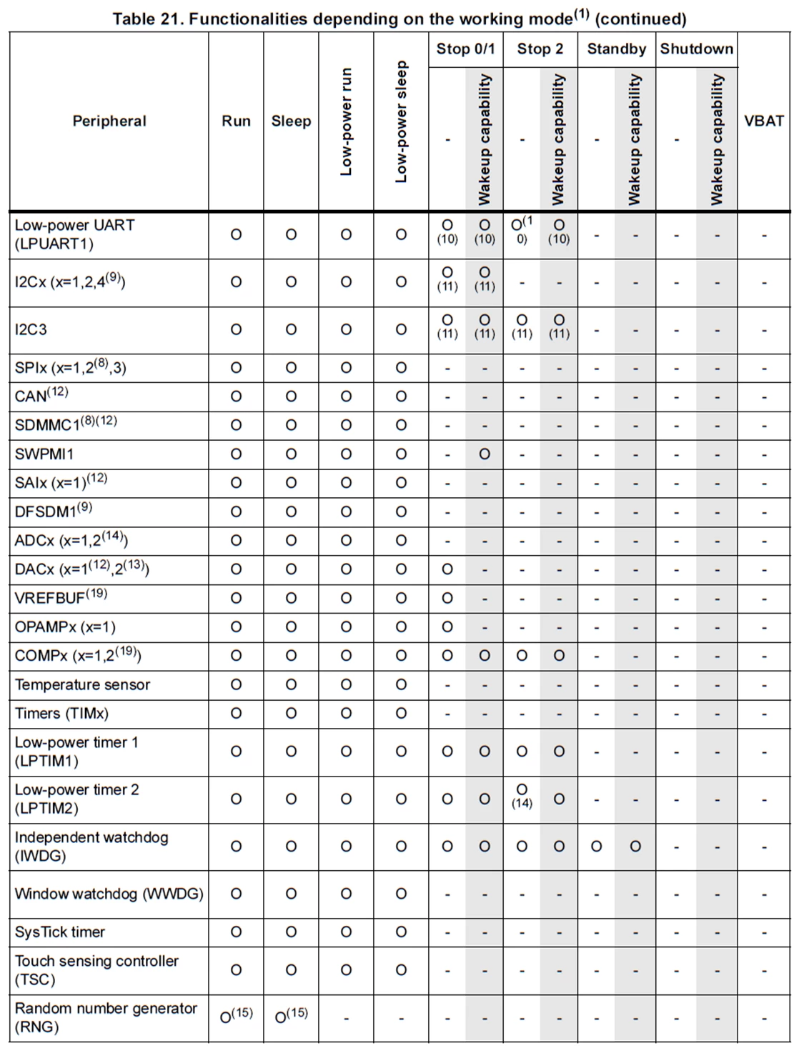

I did see low power modes and how there are 7 types.
But Im not sure which low power mode I need and dont fully understand the information.

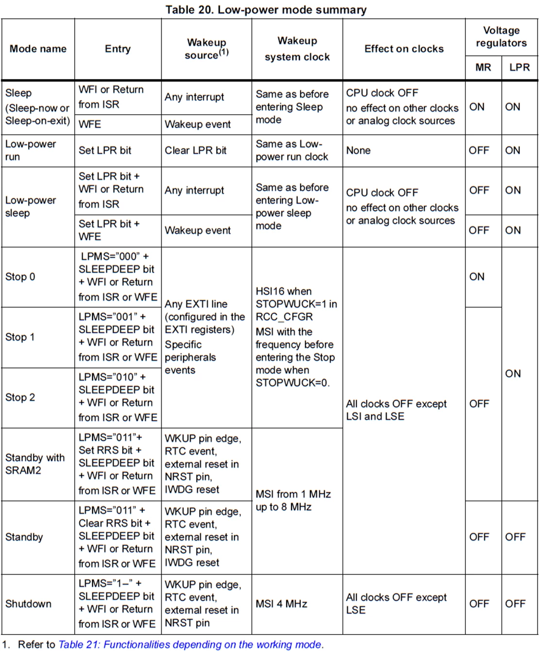

Which low power mode would be most suitable for:
  1. Initial wake up using external interrupt on GPIO pin (e.g. on falling or rising edge)
  2. Once woken, run the four-click switch-on cycle (as explained in original post) which requires running code that uses a timer
  3. If the four-click switch-on cycle passes, remain awake and run main code
  4. If the four-click switch-on cycle fails, go back into low power mode
Andrew Neil
July 8, 2025

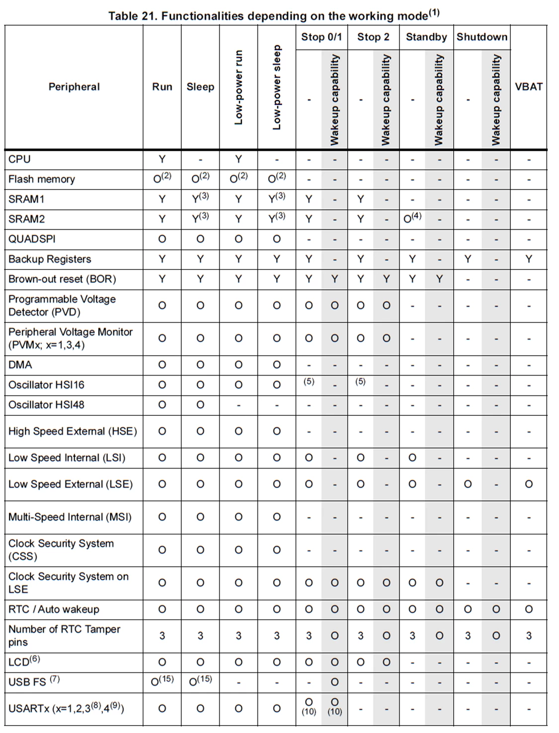

The key thing that you want is to wake up using a GPIO pin.
So look at the 'Wakeup Source' column to find which modes give the option to wake on a GPIO pin.
This is the only thing that's relevant - the counting of the 4 clicks, etc, is all done once the chip is awake.
Note that waking on a WKUP pin will allow lower sleep currents.

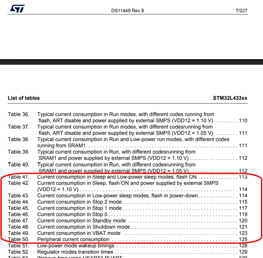

See Tables 41 and on for the current consumption in the various "low-power" modes
https://www.st.com/resource/en/datasheet/stm32l433rc.pdf#page=113

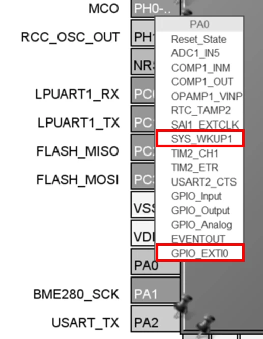

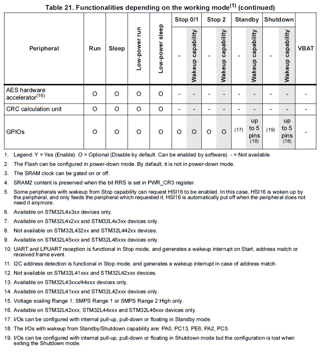

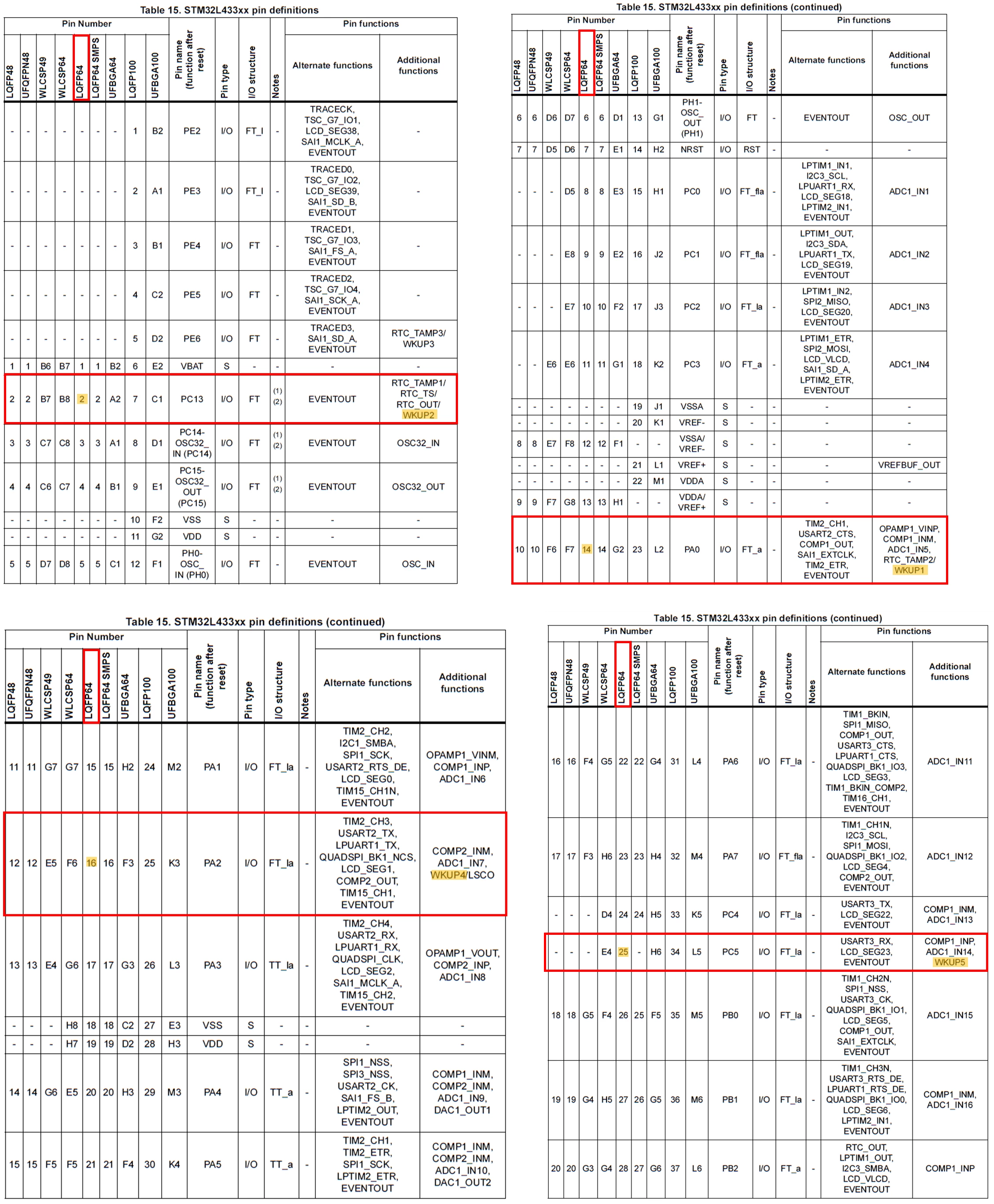

So on the LQFP64...
  1. WKUP1 is on PA0 (pin 14)
  2. WKUP2 is on PC13 (pin 2)
  3. WKUP4 is on PA2 (pin 16)
  4. WKUP5 is on PC5 (pin 25)
(WKUP3 is not available on LQFP64)
In STM32CubeIDE, do I set one of the above pins to GPIO_EXTIx or SYS_WKUPx ?

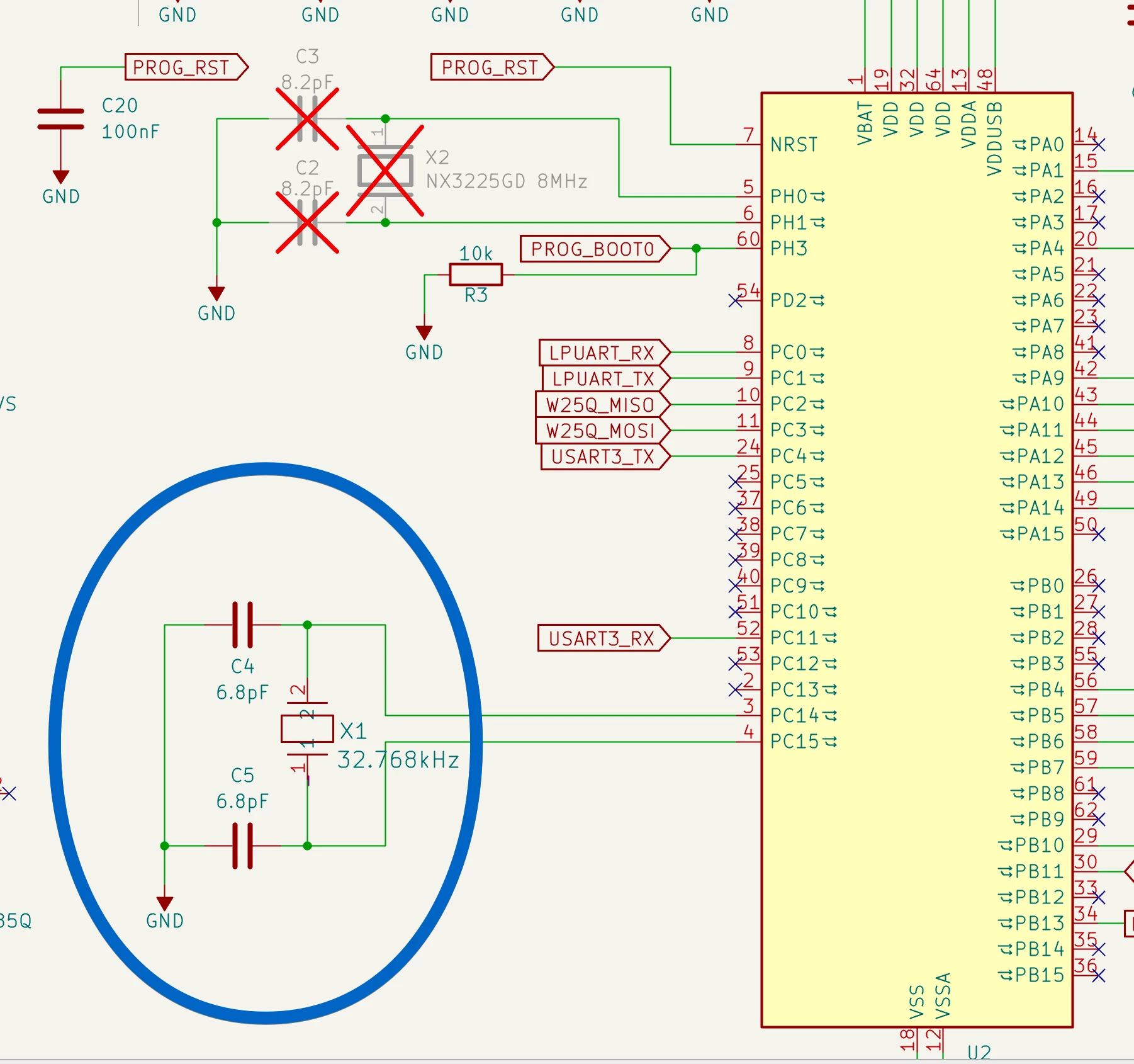

I am also using the 32.768kHz low speed external crystal, which I understand generates an 8MHz clock (I copied the design used on the NUCLEO-L433RC-P).  I believe the 32.768kHz low speed external crystal reduces power consumption ?
I have allowed provision for an HSE oscillator clock, but its not fitted.
Andrew Neil
Andrew NeilBest answer
July 8, 2025
@freeflyer wrote:
Using a WKUP pin becuase it allows for lower sleep currents is the sort of advice I am lookng for
You can see that from the tables: the "deeper" sleep modes have only WKUP (not GPIO) as possible wakeup sources.
If that's now answered your question, please mark the solution.
That's a whole new question - please start a new thread for a new question.
TL;DR: it depends ...
