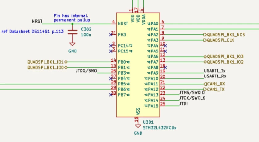

Hello there
I am struggling with receiving interrupts on my microcontroller project. I am currently developing a CAN bus logging device; the following code therefore sets up the CAN peripheral in silent mode. I test my device in a CAN network with two other devices that are constantly communicating with each other. I have verified that the CAN messages appear at the CAN Rx pin of my MCU using an oscilloscope.
However, my CAN Rx interrupts won't fire. I tried some fixes from other posts, but unfortunately, neither of them worked for me.
My setup is as follows:
>> MCU: STM32L432KCU
>> CAN receiver ISO1044BD
>> Vdd = 1.8 V (the MCU and the CAN transceiver are both running on this level).
>> IDE = CubeIDE
Have any of you ever had to tackle this problem?

Andrew Neil
November 28, 2025
Welcome to the forum.
You haven't given much information about your setup - please see:
How to write your question to maximize your chances to find a solution
In particular, details of the board you are using (schematics, etc) and your CAN bus configuration...

November 28, 2025
Thanks for the quick response!
The CAN interface looks like as following:
The CAN Bus configuration is supposed to be in silent mode, so that my logging device only listens to the bus.
The settings shown below unfortunately did not solve my interrupt problem.

 "listens to the bus": That's why you need to share the schematics as it was requested and as you did.
