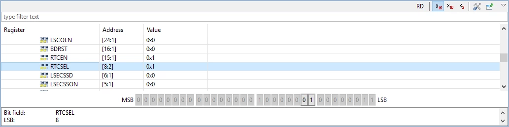

Check (read out) respective RCC register (RCC_BDCR.RTCSEL) whether you are clocking RTC from LSE indeed.
Checked:

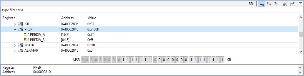

0690X00000609sXQAQ.pngCheck (read out) the RTC divider registers.   0690X00000609veQAA.png
Checked. According to this its fine:

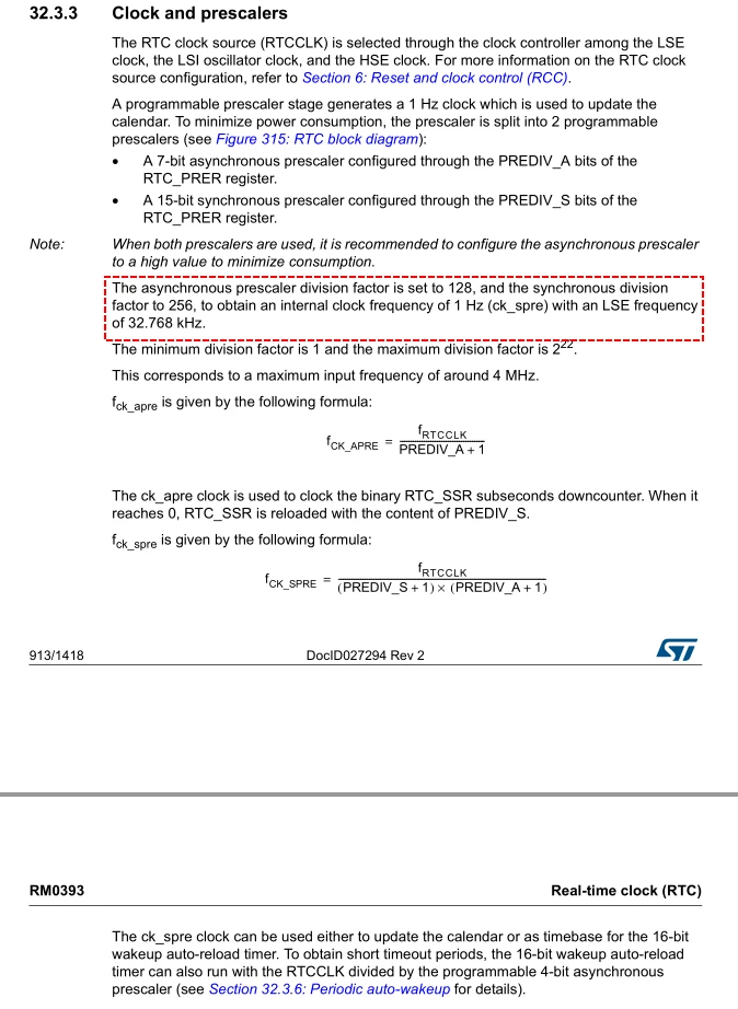

0690X00000609vfQAA.pngIf you have HSE as system clock source, measure LSE frequency using the TIM15/TIM16 remap.

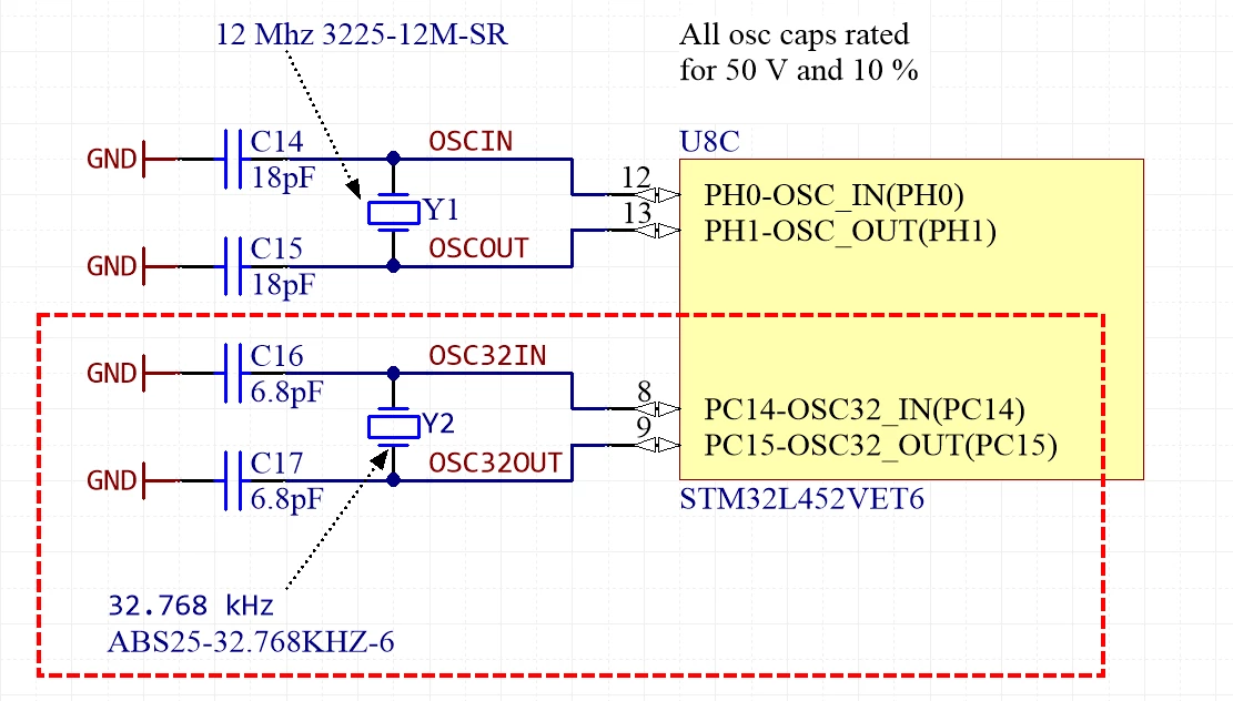

Your design is wrong. You should have 6pF for (C16.C17/C16+C17) + Cx, with Cx tracks + STM32 pins capacitance (few pF).
Crystals with CL=6pF are made for direct connection to microcontroller/RTC and hard to design.
Take a 12.5pF crystal (the most used value) and C16=C17=22pF. Have a look on the STM32 hardware manual regarding the crystal power.

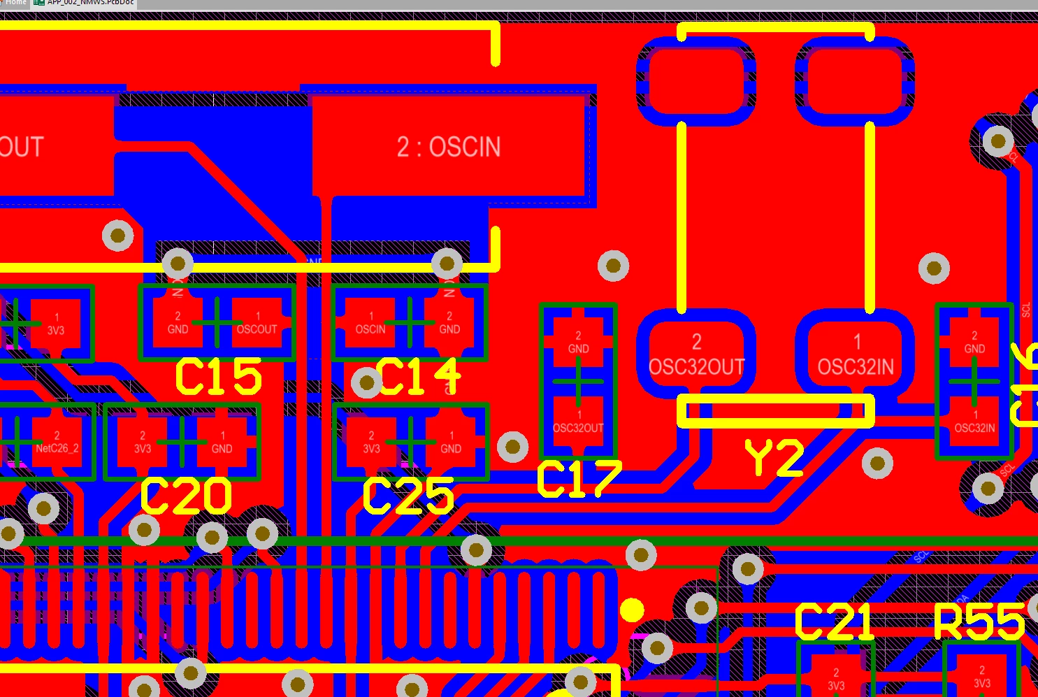

To answer your questions, here is screenshot of how the crystal is routed:
Its the Y2 crystal.
I would not say that your guidelines were followed. I paid a lot more attention to the HSE placement to be fair, as I thought at this frequency (32 kHz) there are not hard constraints when it comes to placement. This is a 2 layer board so the is no solid GND plane underneath the crystal. Do you really think that this could make the difference?
T J
Senior III
Mar 11, 2018 1:29 PM UTC
Posted on March 11, 2018 at 13:29
If
Mazur.Grzegorz
‌ is correct, you have noise injection from the ground fills, from the switchers.
I would remove the ground fill from the crystal circuit area totally and off C16, C17, try to move underside tracks away if possible.
Run a 15thou trace from C17,C16(Gnd), to pin 10 Vss, before it hits C25, then connecting to the remaining ground fill/track.
This will mostly block any switcher noise you have propagating along Vss,.along your ground fills.
